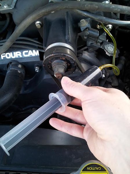

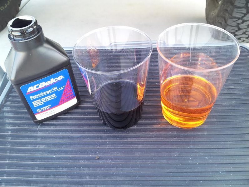

    Long overdue S/C oil change today. Parked the truck nose down and I used a very narrow and flexible gas line from Home Depot intended for grass trimmers and the tubing was able to get the the lowest part of the nose cone to suck out the oil.

    ^^For reference, how may miles and time?^^

    I honestly don't know, that is what scares me. I bought the truck with the SC on there and the truck had 90K on it. The SC was installed from when the truck was new by previous owner. So I have put 31K on the truck since I bought it. This could be just over 31K or 121K since last change. I'm due for a rebuild soon anyways.
