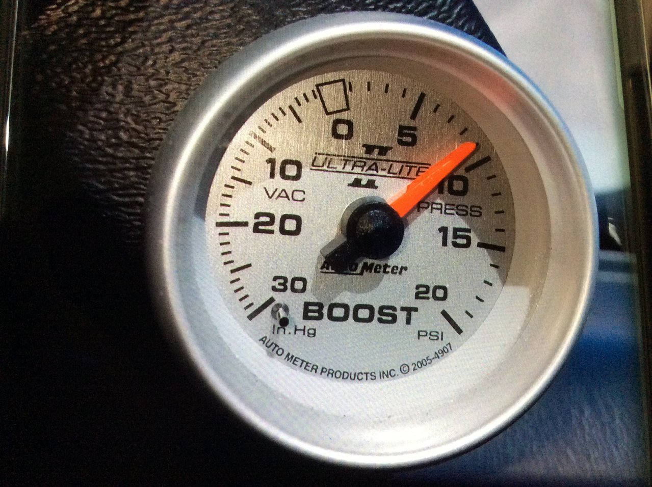

    hey i have that same gauge (i put a red led back light in it).
    found the problem with my loss of 2ish #'s of boost the shit ass steel welded muffler broke some welds and a baffle shifted over choking the exhaust enough to make it run less boost. good lord i don't even know how the truck ran.
