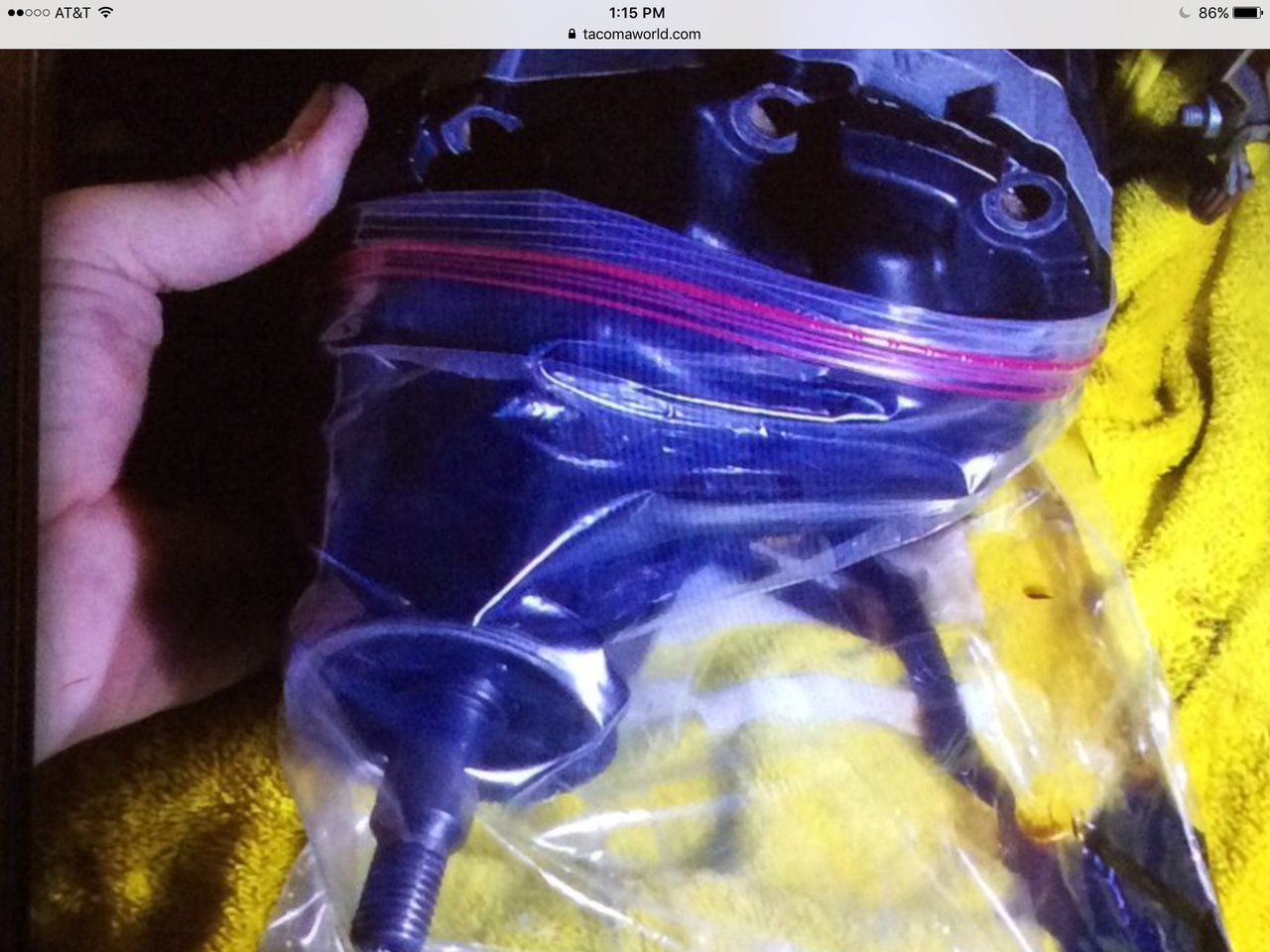

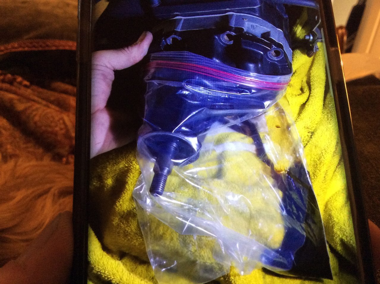

    Cell phones camera come in handy when in a pinch, and don't be jealous :))))

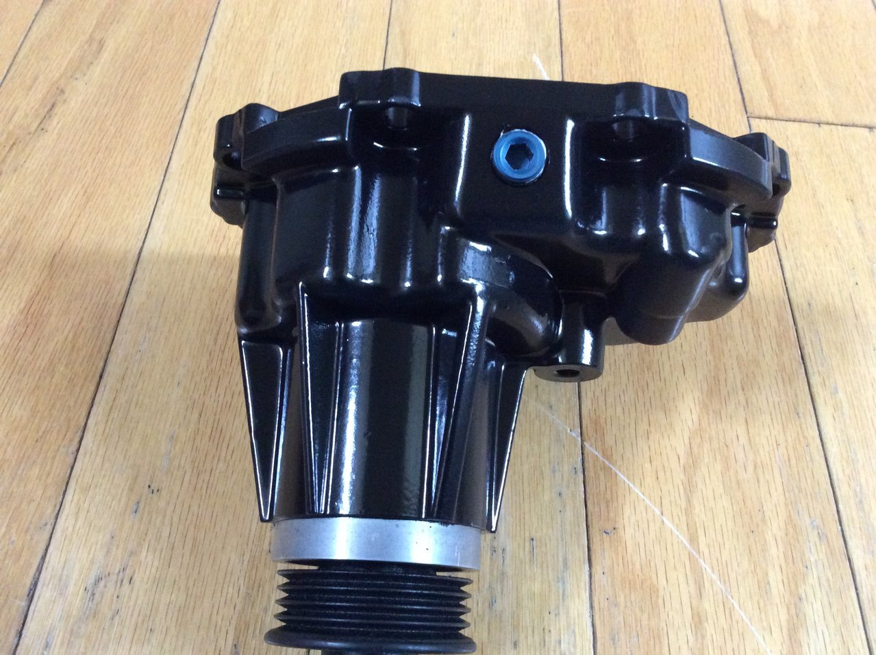

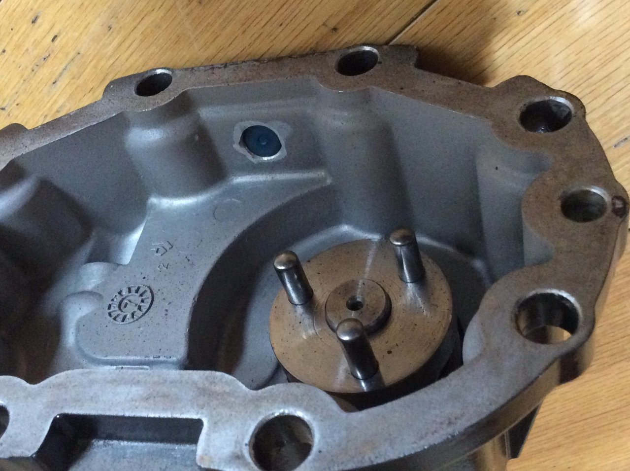

    Did you install the butt screw yourself or is that something for a machine shop?
