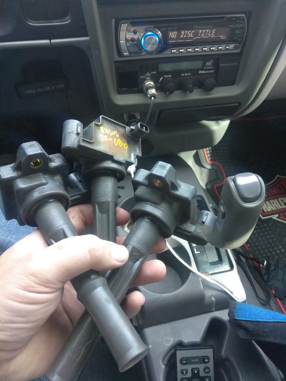

    It has new plugs and wires.
    If the truck sits for a day it will run on 5 cylinders for like 30 seconds then clear out and run on 6 allday.
    I might have an injector going out. I'll do the fuel filter this weekend

    Check your coil packs first,
    Never had an injector go bad on me in 545,000 miles
    Had 3 coils go bad on me in 545,000

    I'll have to hit the junk yard and see if I can find a pack or two

    Yup, should be like this in first gear, I'm betting it's the coil packs

    Was able to get these today. I'll throw them on when I get home 30$ couldn't pass it up
