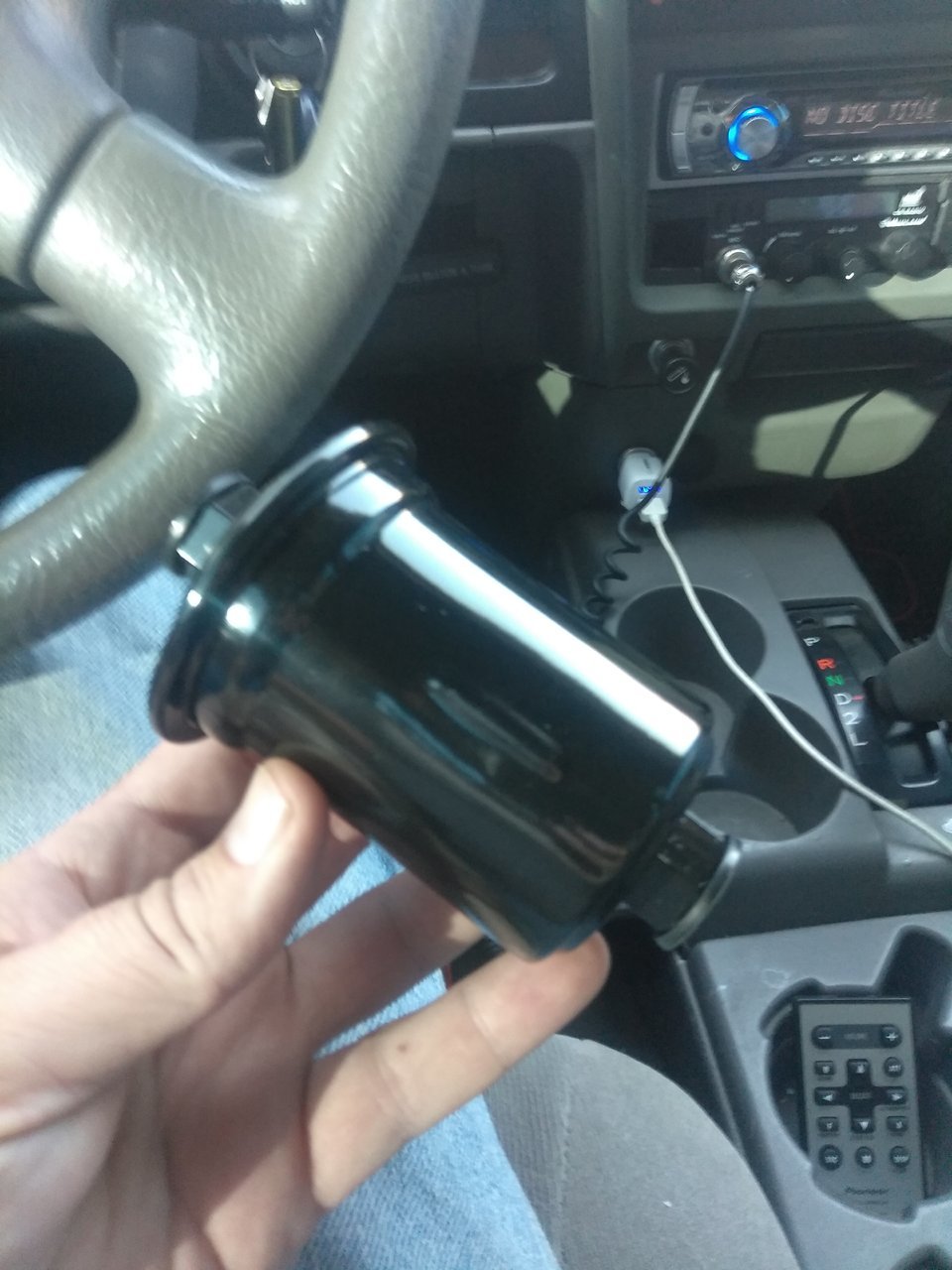

    Doing fuel filter tonight also.

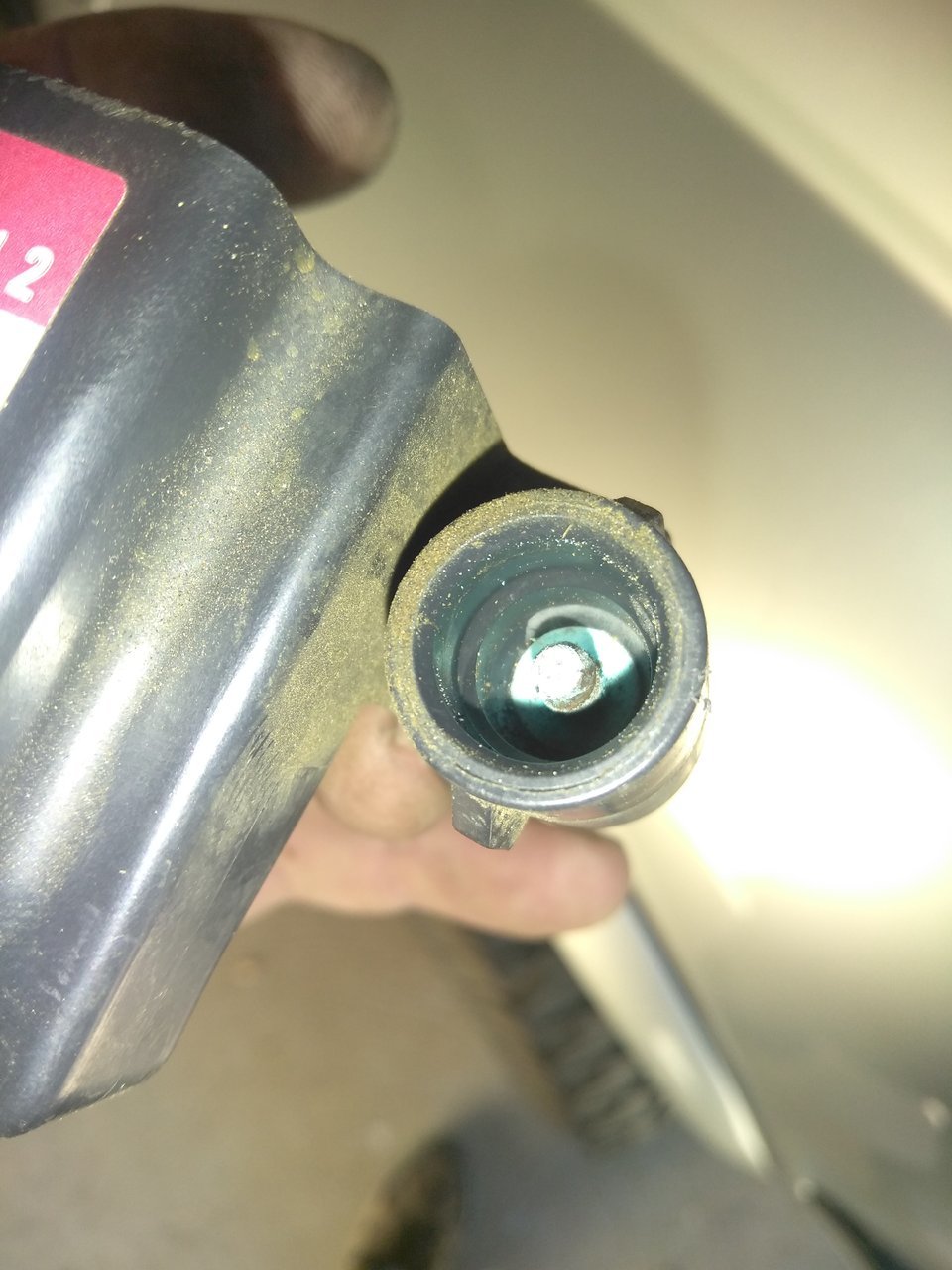

    Two of them looked like this.
    Going to do fuel filter now.

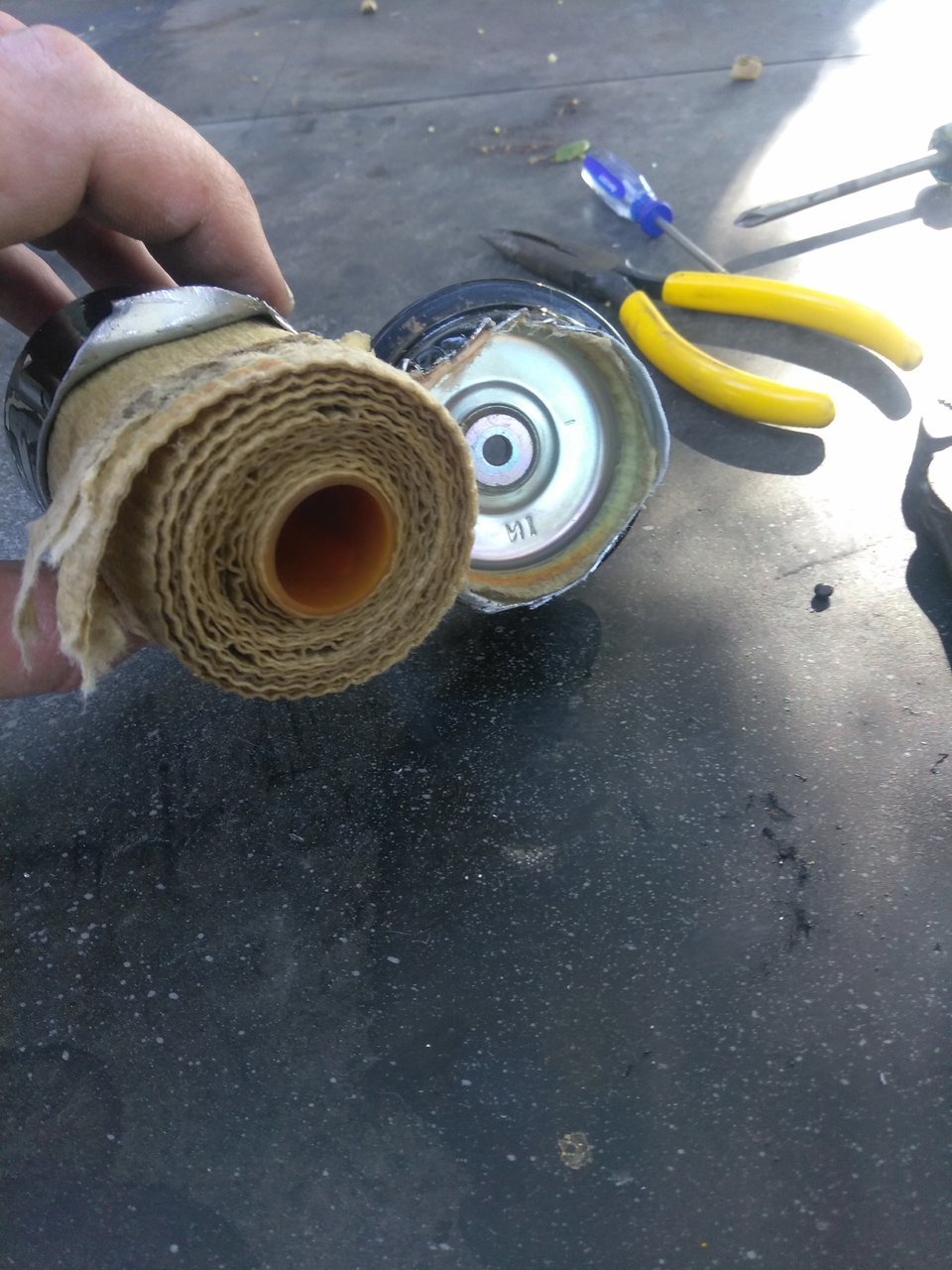

    I'll cut open the fuel filter and see how dirty it is. Stay tuned. Lol

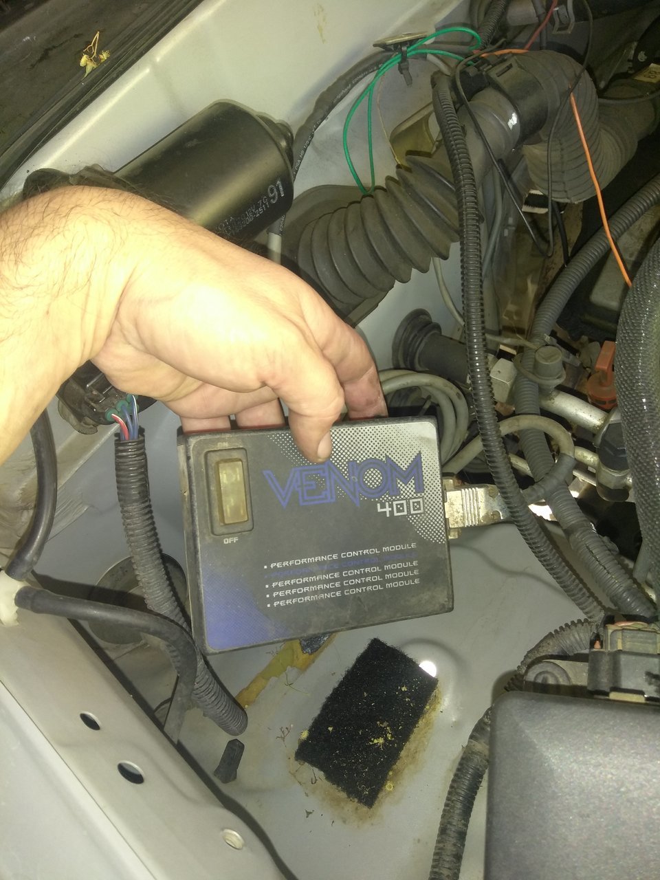

    This thing helping me or hurting me? No idea what it is for

    I'm going to say those coil packs are not working correctly with all that debris in there, probably shorting out on load.
    I would probably get NEW coil packs and not deal with this issue again

    I'm guessing the previous owner installed it to help with ping issues.
    Does it run differently when offf as I see a power switch there?
    This is what I found below,,,,
    The Venom 400 module has caused quite a stir with people. Yes, it does "increase" a certain amount of HP persay.. but let me explain how it works:
    Lets say you are throttling at 30%. Venom 400 will make your computer think you're at 40-50%.. so the computer will add more fuel and stuff.. Thats why Venom only claims gains only up to 75% throttle.. after that the computer will be in open loop and the venom 400 is useless.

    The filter didn't look to bad inside.
    eon_blue likes this.
  9. Dec 2, 2017 at 1:40 PM

    Coils!! :)
    Because it cuts out at under load too,
    That's a type fault when they go bad with no codes
