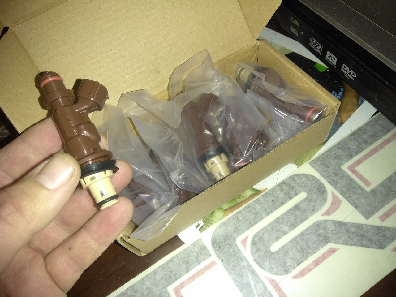

    The only code im getting is P0300 and a P0303
    And a 5 cylinder start up after sitting overnight. Ive done plugs wires and coilpacks.
    Injectors are in the mail.
    Im thinking I have an Injector going out.......

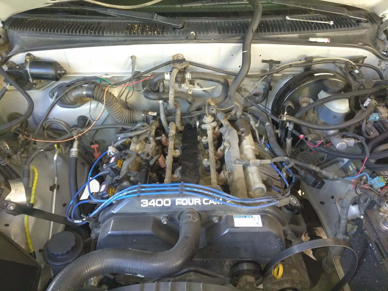

    Anything else I should do this while I'm in here?
    Do I put any type of grease on the orings.

    Not sure where you got those injectors, Just make sure those injectors are the larger flow rated injectors. 1995 through 1999 I think were
    a smaller flow rate and the ones around 2000 through 2004 were a little larger. I think the injectors are all interchangeable with the later years having a different harness clip.

    They are for a 2001

    I wouldn't use grease for fear of damaging the injector ports somehow, but always dip fuel related components' O-rings in clean gasoline before installing so the o-ring isn't dry.

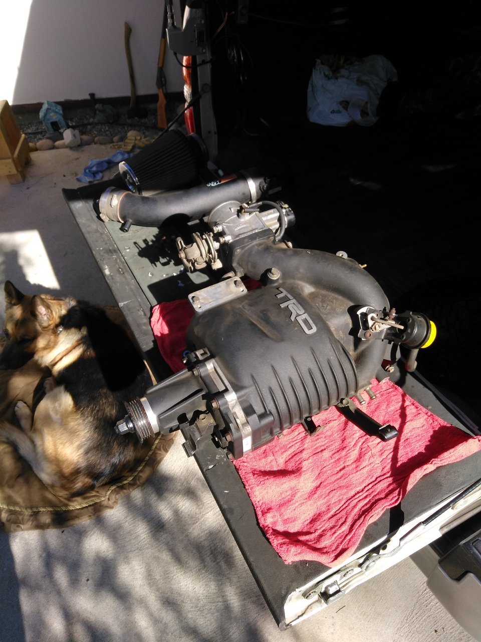

    Anyone know the part number of the intake manifold gasket i'll need?
    The one under the super charger?

    Toyota Part No.: 17176-62040

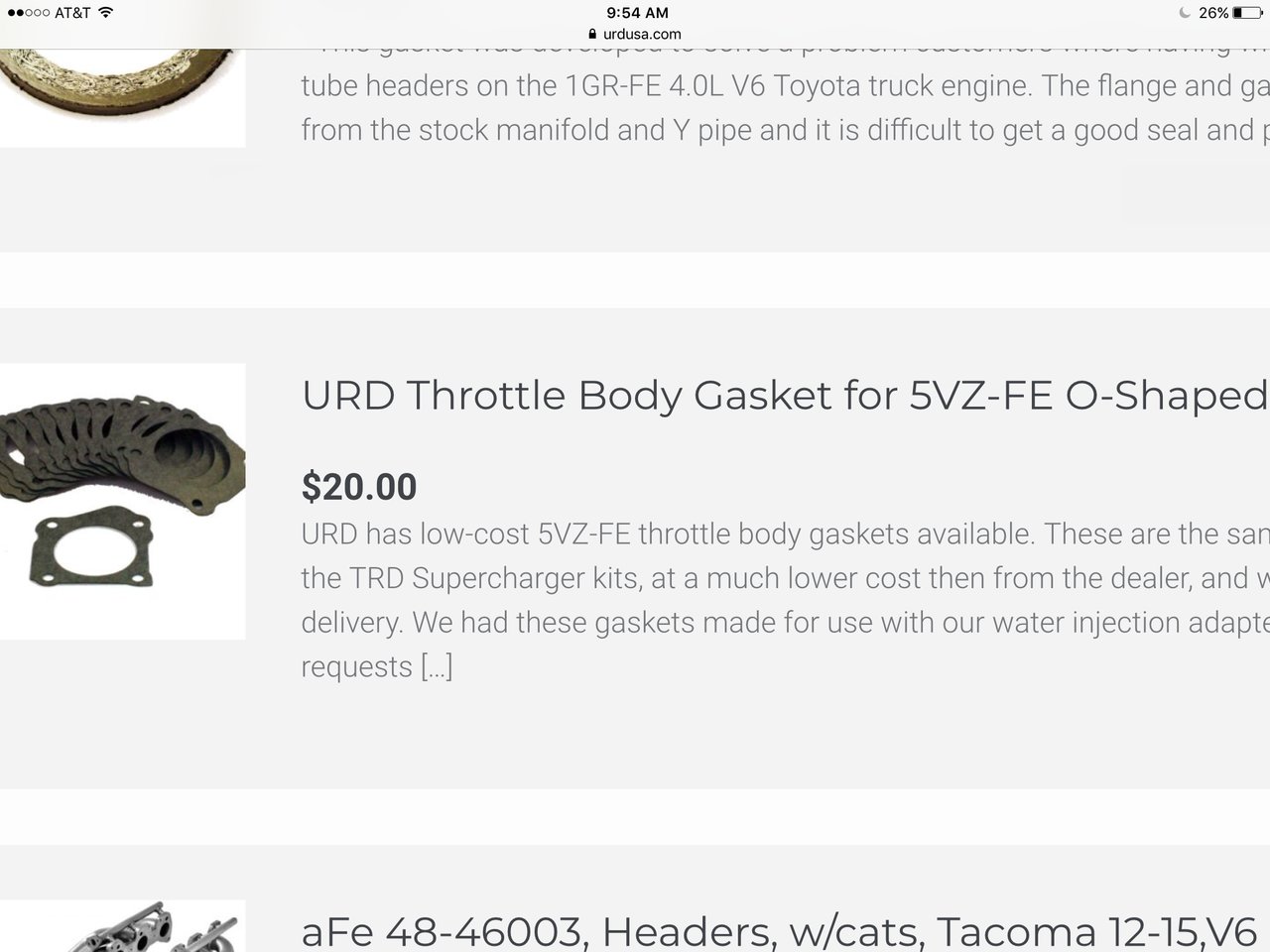

    Make sure you have the "O" Shaped gasket for the throttle body

    Will the dealer have the (O) shaped one? I was thinking I could leave the throttle body on the supercharger.
    I want to do this tomorrow.

    You can leave the throttle body on,
    No the dealer only has the restrictive type,
    UDR has the O shaped one.
    You can add the O shaped one later then.
    If you have a supercharger you need the O shaped one

    Ok I'll see what happens. hopfully I wont need to take it off. Maybe it has the restritive type on it now. lol I have not idea.

    If you have the OEM,,,, gasket it blocks like 1/4 Or a 1/3 of the air going through the throttle body, so definitely check,

    You can look down the throat of the throttle body and will be able to see when you take the charger off

    Not as hard as I thought it would be.
