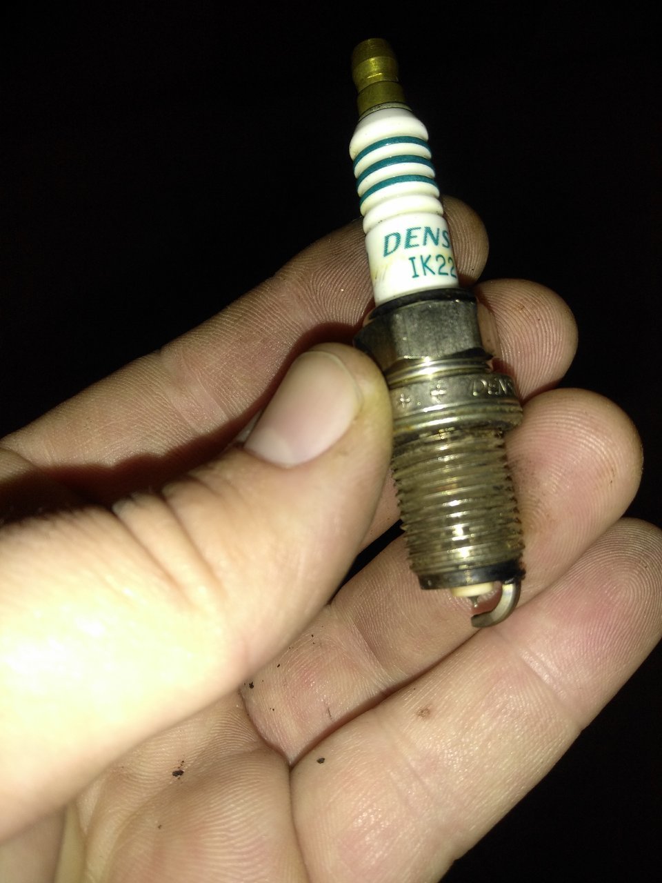

    I had a little ping and these plugs took it away until I got the 2" pulley and pinged like hell above 4 pounds of boost so added the methonal and all is good, zero ping at 10 pounds of boost

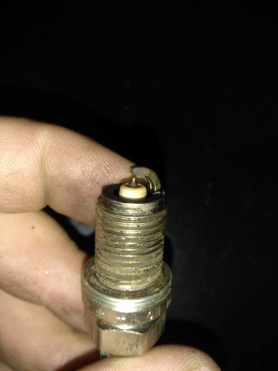

    Got out my big light. Took out the old plug from number 3 where the misfire code lives,and put in an old plug (as a tester). I'll run it for a few minutes and leave it till tomorrow night and see if it starts as 5 cylinder or 6.
    Old plug look fine to me. What do u think.

    Actually looks ok, switch plugs from another cylinder and see if the miss fire goes to the other cylinder,
    Take a magnifying glass to see if there is a hairline crack somewhere in the porcelain

    Use electrolyte grease on all the plugs also just in case there is Carbon tracking.

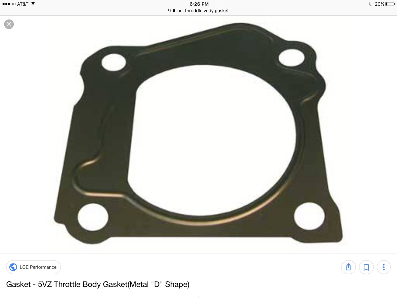

    Not really a supercharger rebuild question but it relates to the 3.4l blower so I'll ask it here...
    Have any of you guys cleaned your throttle body by removing it? Is there a gasket that needs to be replaced/reapplied where the TB and supercharger intake meet when reattaching the TB?

    You have to take it off completely to clean it correctly and there is an "0" gasket that probably will need replacing that is a Trd gasket NOT a "D" oem gasket

    Found the part # online, PTR2960030....anywhere from $35 - $50 depending on where I order it from, that gasket ain't cheap lol.

    These are the two, you need the round one for the supercharger
    The D one. Bocks the flow of air

    Good to know, I'll make sure I get the O one. That would suck to end up with one that blocks airflow, wonder how many poor souls have made that mistake
