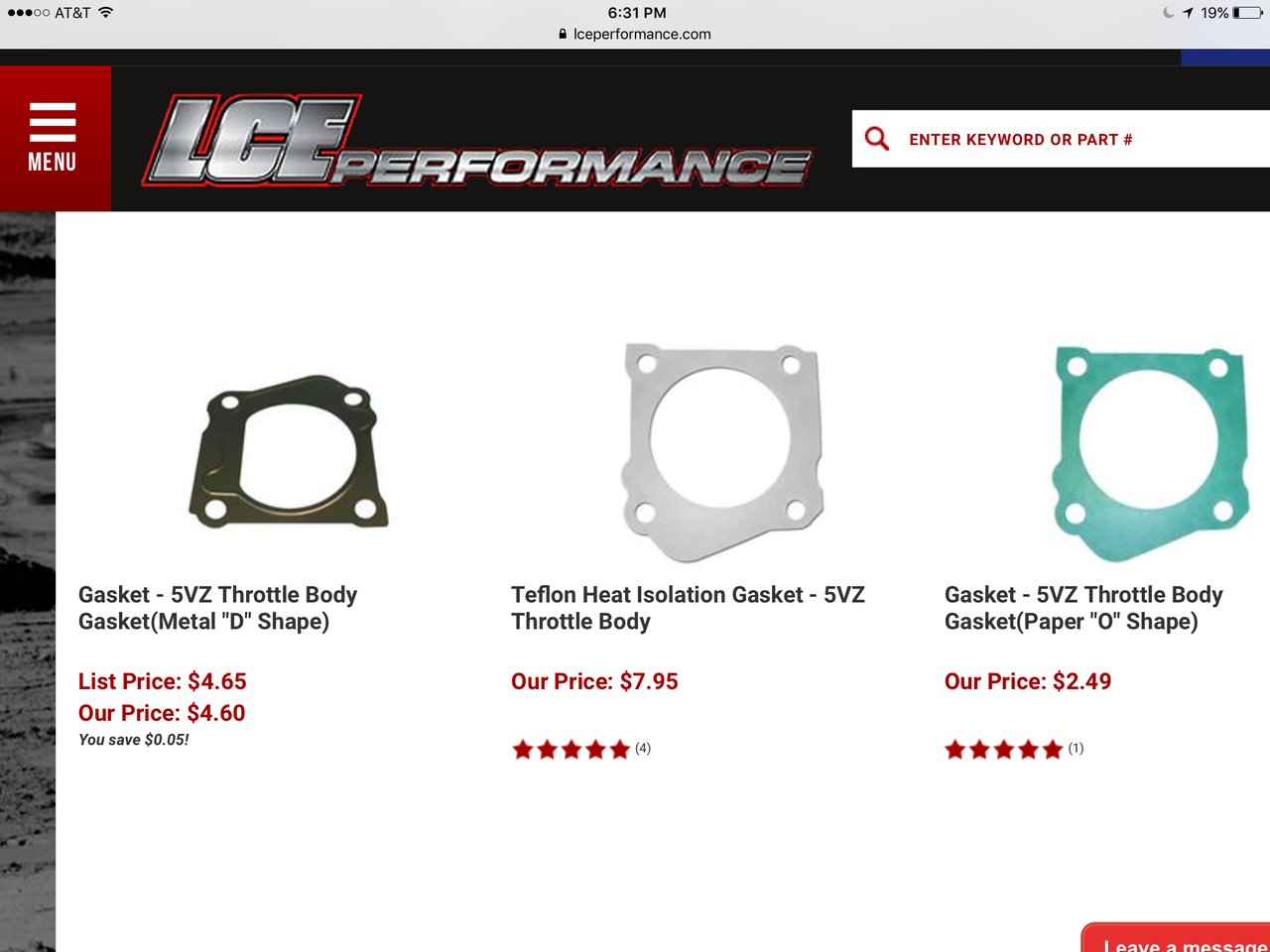

    Hey John, I finally got around to ordering this gasket through LCEngineering for my blower, hoping to do my throttle body cleaning this weekend if it arrives in time...thanks again for the link :cheers:
    Have you installed this one before? Do you know if it just bolts/sandwiches in place between the TB and intake or do I need to seal it with silicone?

    Just bolt in, no need for silicone, torque it down is all

    Hey John, did you install this LCE gasket on your truck too? Did you have a higher idle afterward? I just got done cleaning the throttle body (removed it completely) and bolted on this gasket...made sure everything was reconnected properly and tightened down, but my truck is idling at 1100 now when warm instead of ~700 like normal.
    First thought was maybe the seal around the new gasket isn't tight and it's leaking air but I can't find any sign of a leak...
    The gasket extends a tad around the edge of the intake (almost like it's a bit too large) which the paper one didn't, which is a little concerning but that might just be normal.

    Just a heads up, I have done cleaning on a couple Tacomas (all higher mileage), and the idle ended up being high afterwards due to wear in the throttle body that carbon and gunk was masking. I wouldn't clean any TB's with more than 200K!

    I just bolted it on when I installed the supercharger after it was rebuilt with no issues. Sometimes when
    a throttle body is cleaned it causes a fast idle because the carbon build up filled in a low spot in the
    throttle body tunnel, but I'm not sure with your case, if you look at other threads on cleaning the throttle body you will see a high idle as a result for some
    eon_blue[QUOTED] likes this.
