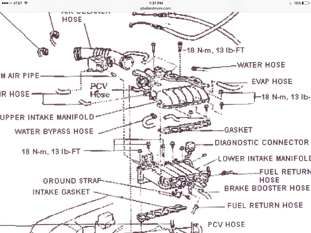

    does anyone know what to torque to bolts to after you reinstall the charger?

    I've always just hand tightened them with a socket wrench. Never had any loosen or issues.

    #675
    eon_blue
    Mar 4, 2016
    #180213
    69,878
    Azusa, CA

    I believe the bolts they are like 13 pounds or so, not a lot

    rebuilding my charger now, and trying to figure out if I can just buy a regular intake gasket, or if I need a special gasket since it has the charger. please help lol

    You mean the throttle body gasket or the gasket between the engine and SC? The throttle body gasket needs to be a O shaped to allow maximum air flow, but the 6 holed intake gasket is just the OEM one.

    yes the gasket between the engine and sc. thanks a lot!
