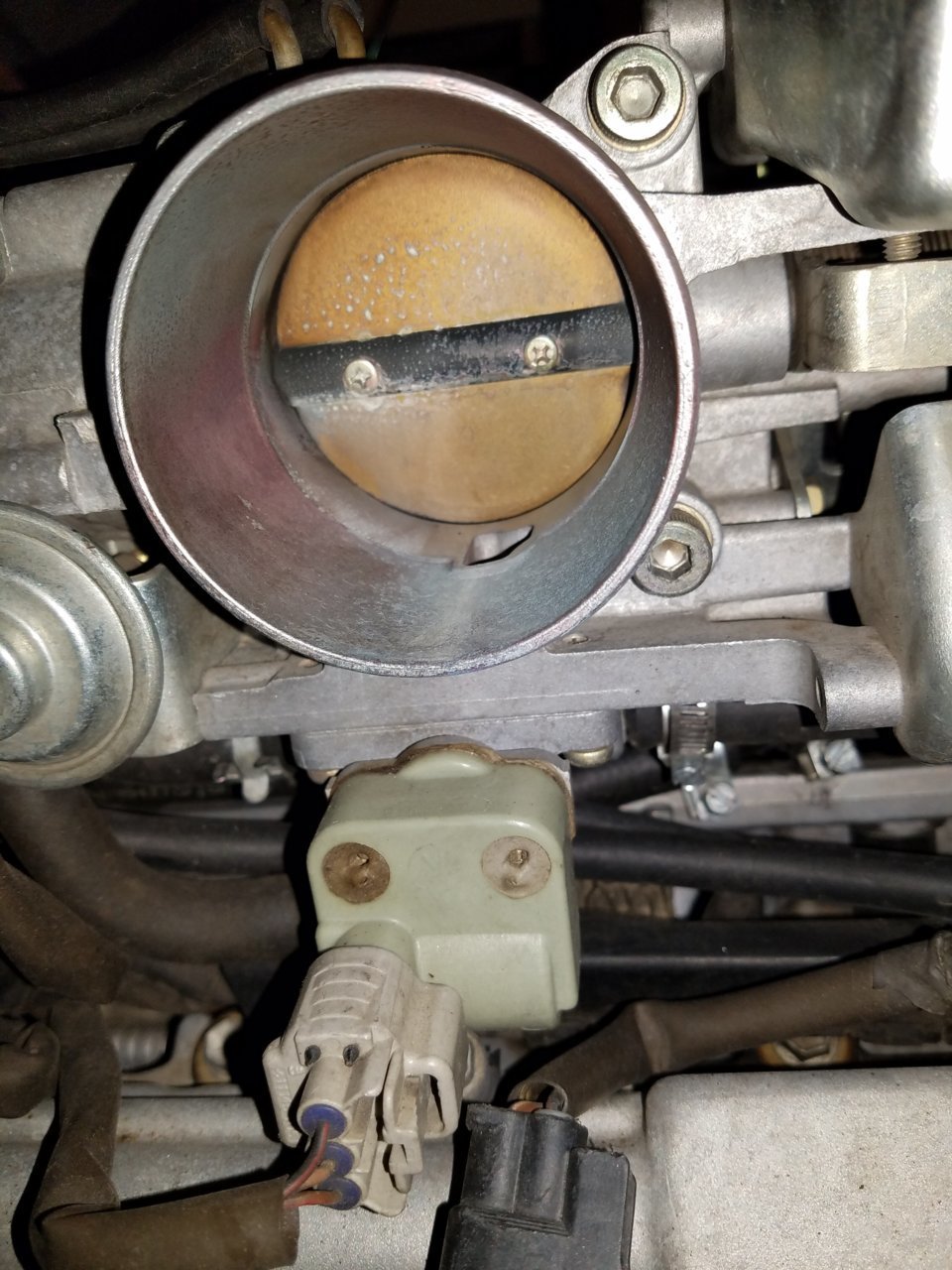

    97 reg cab, v6 5sp 300hp supercharged, Methonal Injection, 800,001 plus miles, Original Owner
    V6 5sp,RegCab,TVS1320 Supercharger, 56mm pulley, methanol injected Haltech ECU, AC Tvs1320 supercharger,(MUST DO) every 125,000- 150,000 needs rebuild Projector headlights HID 5 speed manual Amsoil for all drive train Smaller 56mm custom pulley, (MUST DO) 2004 DESNO fuel injectors, zero ping ping, 2004 side door mirrors Dick Cepek Rims, Michelin tires LTX, ATM Pathfinders Dynopro ATM ( that last 100,000 miles) Now running Dynopro ATM mud and snow tires KN cold air intake Cat back dual exhaust with ss exhaust tip, Raised exhaust tail pipe to 2" below body line Optima*dry cell battery,red top Alpine sirius radio, 200 watt amp, focal is165 split door pod speakers Focal door speakers Subwoffer behind seat Viper alarm, Electric Locks Dark tinted windows, bucket seats corbeau lg1 Tacoma Rubber floor mats TRD fender extenders, Bilstien shocks, King shocks JBA UCA trailer iv hitch, electric brake control, Drilled slotted brakes, High carbon steel (MUST DO) EBS green stuff 7000 series pads(MUST DO) TRD engine oil cap TRD stick shift, Marlin crawl shift kit. Rear sliding window 2002 4Runner functional hood scoop cut into Tacoma hood, 4Runner dual overhead map light Gentex Auto dim + Compass + Temp, garage,rearview mirror Snow Methonal kit stage 2 Custom 3 core aluminum radiator Linex bed liner Haltech stand alone ECU, Intake supercharger gauge. Stainless steel brake lines, Custom leather wrapped steering wheel, Haltech stand-alone ECU,

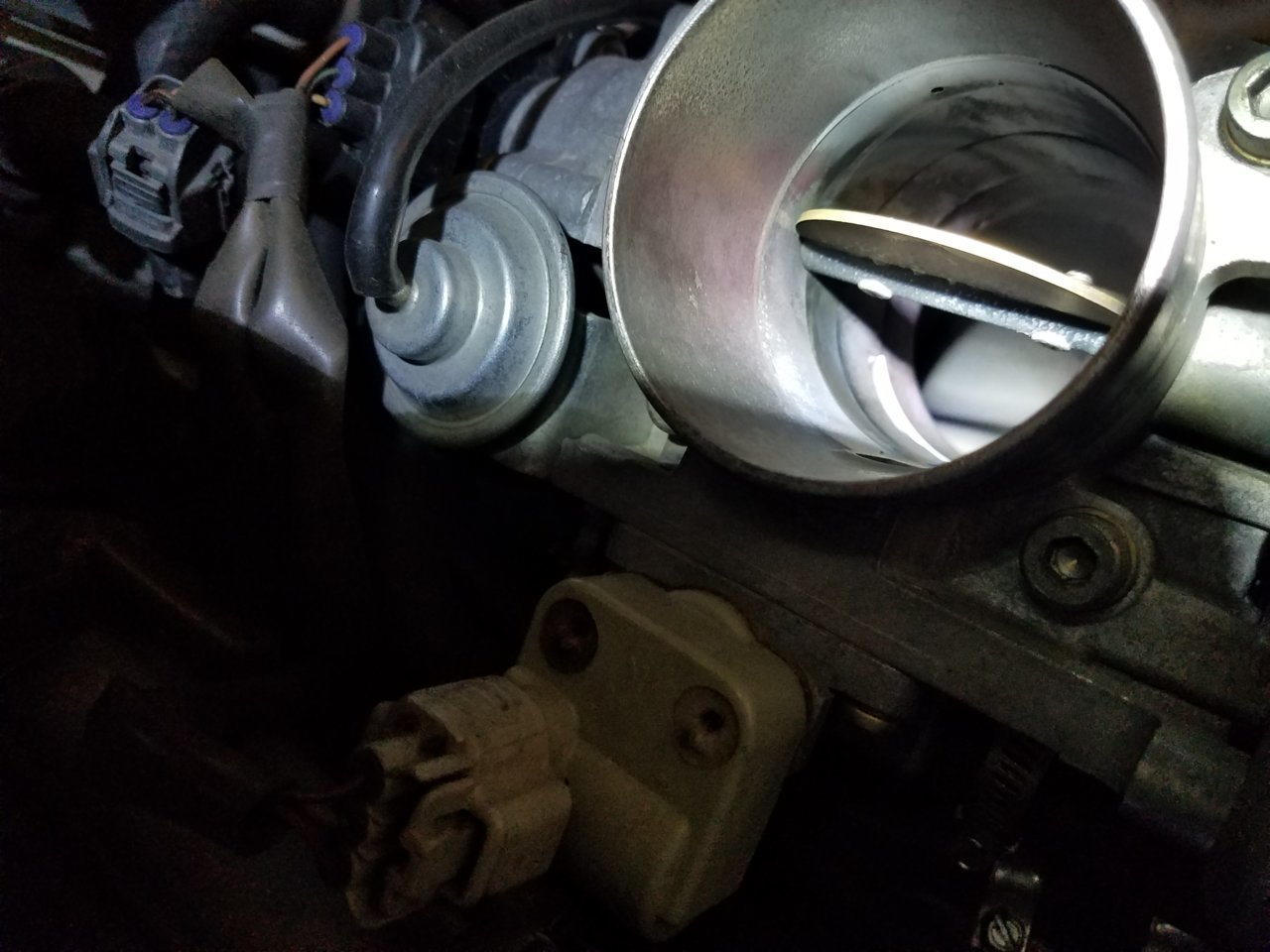

    Some Carbon is normal on the rotors and can be stripped off. A methanol kit will probably eliminate the carbon on rotor, valves an throttle body.

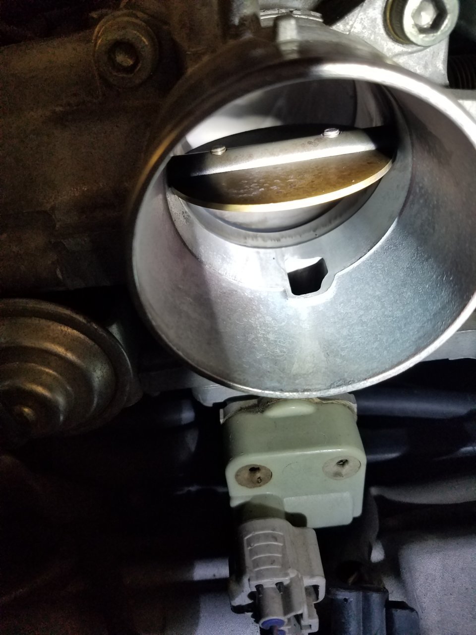

    This is my throttle body with 100,000 miles and shows no carbon build up because of my methonal kit.
    When my supercharger goes in for the 625,000 mile rebuild I will see how it looks as I have about 40,000 with methonal kit now.

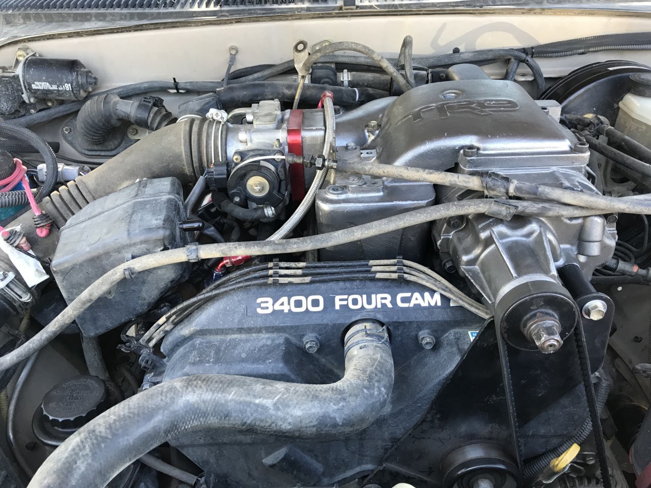

    I picked up a used 1st gen (gray) super charger and install it yesterday.
    The previous owner had it for a year and never installed it. He’d purchased it from someone else who rebuilt it.
    I have a 2003 3.4L with 233,000 miles. Prior to SC install I did a compression check. Everything checked out. Truck normally runs like clockwork.
    The truck starts right up but the idle is all over the place. With the adjuster cable off the bracket (I’m. Not 100% sure this is the correct bracket) it idles at 400 RPMs. In the pic below there’s a red spacer that came with the SC. The supplied bolts won’t fit without the spacer. The extra width between the throttle cable bracket and the throttle body might be contributing to the high idle?
    With the throttle adjuster reattached and adjusted to it’s lowest point it idles anywhere from 1,100-4,000 rpms. I put it in neutral at a stop and it reved to almost redline. I can feel the truck pushing against the brakes.
    The idle is also very rough. It smooths out at higher rpms.
    I haven’t pushed the truck to WOT yet but I’ve given a couple decent runs to 4K rpms. Afterward there’s a strong smell of gasoline. I found this thread about fuel leaks. In addition to the SC I put Cooler plugs in.
    I cleaned the MAF.
    Checked all the vacuum lines. I followed the diagram above. I believe everything is in the correct location.
    The throttle cable is not attached to the bracket on the SC in this pic.

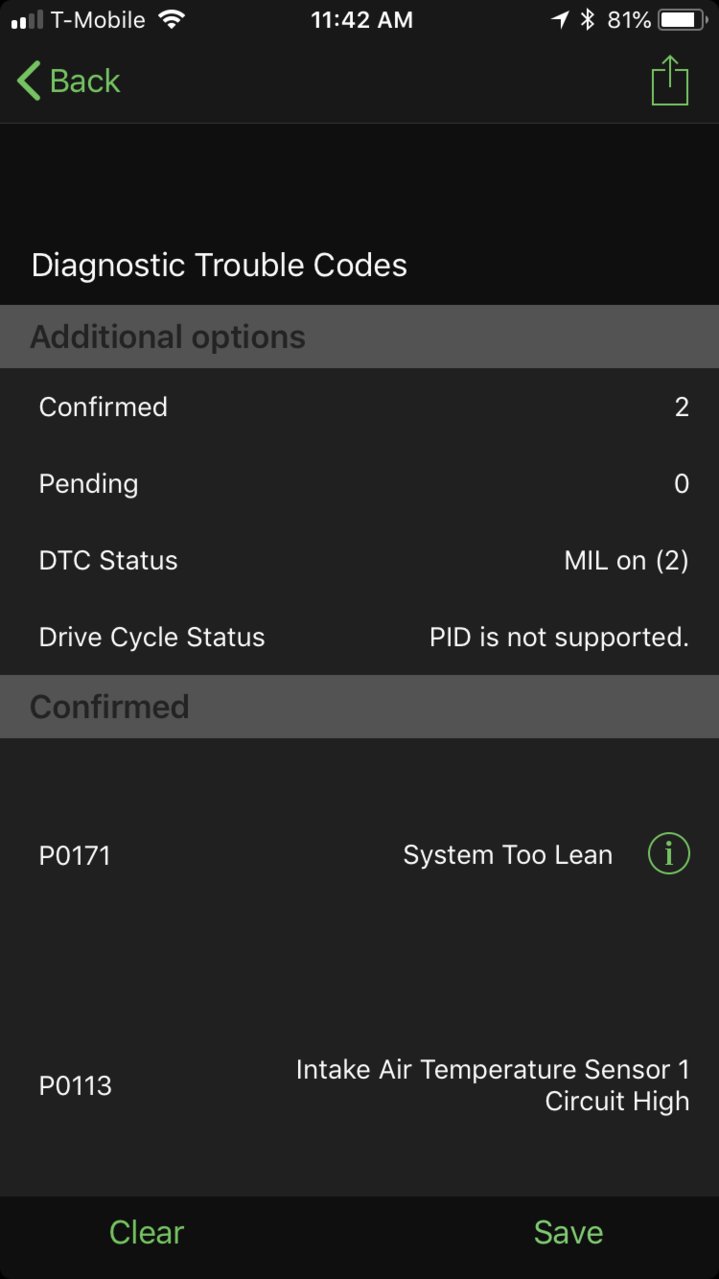

    I also got a CEL and these codes-

  6. Sep 9, 2018 at 2:42 PM
    #706
    1997tacomav6
    1997tacomav6 V6 5sp,RegCab,TVS1320 Supercharger,Haltech, 800k
    Oct 5, 2013
    #113940
    10,393
    John
    Denver
    Not sure what’s up with that red spacer, could be your idle issue, I would get some stock screws
    from dealer and do away with the spacer for now.
    Make sure your fuel line to the rail was not loose or leaking,
    Also check your vacuum line to the charcoal canister from the supercharger. If these lines are incorrect you could have gas smell

  7. Sep 9, 2018 at 3:45 PM
    #707
    otis24
    otis24 Hard Shell Taco
    Dec 3, 2012
    #92402
    6,483
    Mark
    California
    OtisBound Outdoors Bodonkadonk
    OtisBound Bodonkadonk
    My thoughts as well.
    Odd thing is the threads on the super charger are different than stock.
    I’m sure I can get shorter bolts that will work.
  8. Sep 9, 2018 at 4:44 PM
    #708
    1997tacomav6
    Oct 5, 2013
    #113940
    10,393
    John
    Denver
    Mmmmm, just make sure the threads are the exact size and pitch as the supercharger threads,
    You don’t want to strip out the threads on the supercharger side because they don’t match when you torque it down
    otis24[QUOTED] likes this.

  11. Sep 10, 2018 at 11:01 AM
    #711
    04yota
    04yota Well-Known Member
    Mar 12, 2014
    #125177
    1,220
    Angelo
    Central New Jersey
    04 ext cab supercharged 5speed
    Exactly what John said. Maybe the fuel rail got loose when you were installing it. When I installed mine I had the idle problem. I did a bunch of maintenance the same day I Installed the blower so the next morning I looked at all the lines again and the low rpm ended up being the supercharger not torqued down properly. :crazy:
    otis24[QUOTED] and 1997tacomav6 like this.

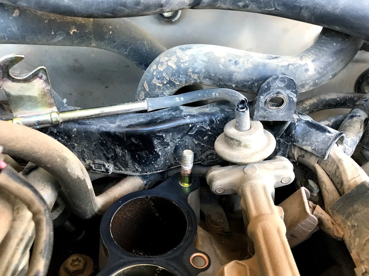

    I took the Super Charger off yesterday and found the vacuum line to the fuel pressure regulator broken. I had to replace that line anyway as it still had the rigid stock line attached.
    Could this be causing the crazy idle as well as the fuel leak?
    I took the super charger off and returned the truck to stock for now. After all the stock stuff was back on the truck runs fine and no gasoline smell. I'll put the super charger back in a few weeks.
    I'm going back to plan A....spend a lot more time on research. Get new vacuum lines, give the super charger a thorough going over. Possibly purchase a 7th injector kit now instead of later. Find the proper throttle body bolts to remove the red spacer thing. I also really need new valve cover gaskets. And lastly give the engine a good cleaning before doing anything. It's super gross. The valve covers have coating of dirt and oil and the engine bay in general is disgusting.

    Yup , that’s definitely where the gas smell would be comin* from.
    As these trucks add miles and years it’s best to replace as many of those vacuum lines as possible
    with the supercharger off. Any vacation leak will cause supercharger problems for not working correctly

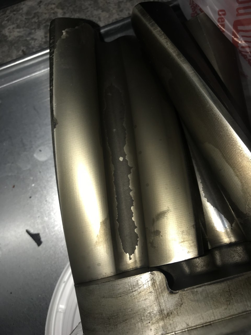

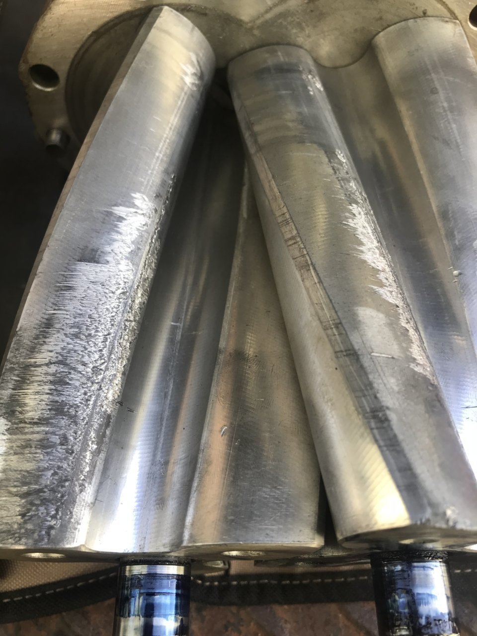

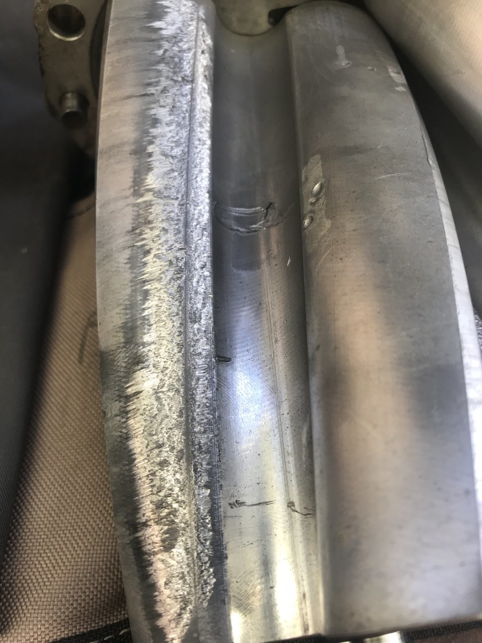

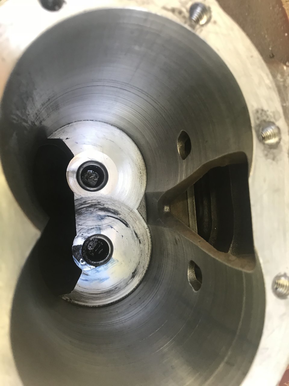

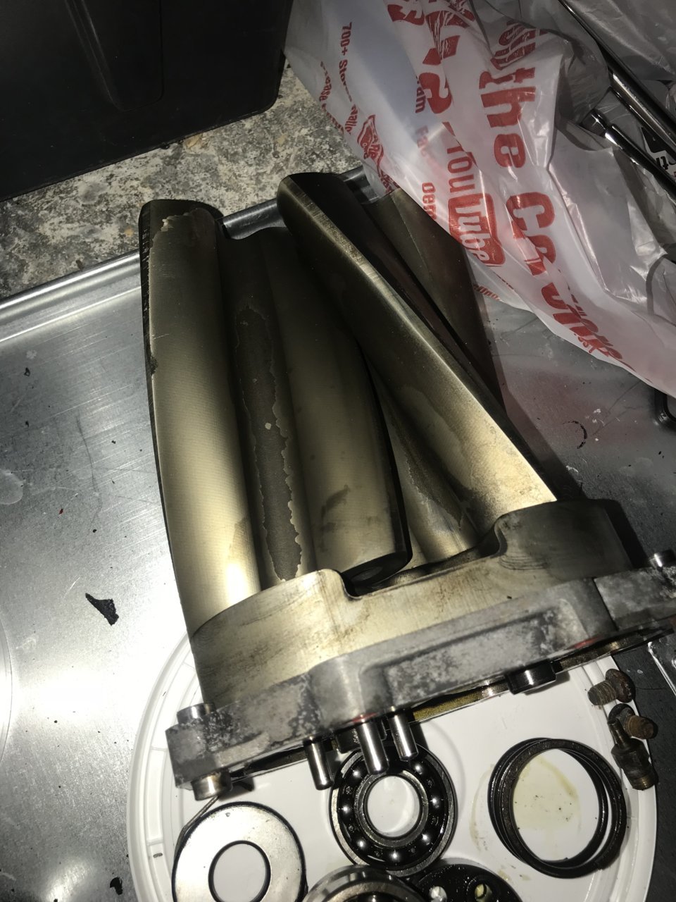

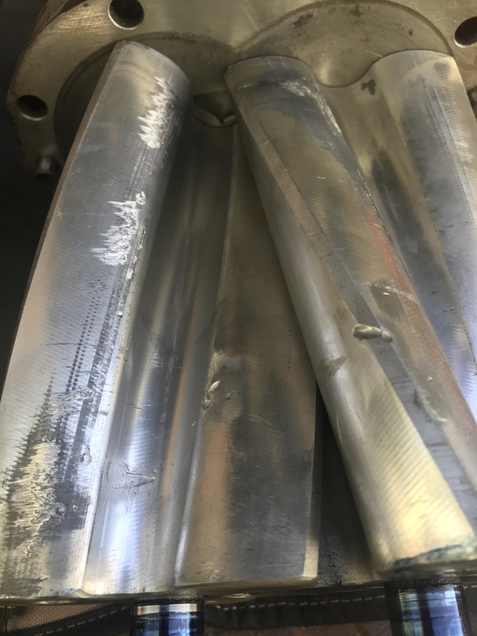

    I took the supercharger I bought apart today just to double check it.
    All the bearings are new along with the coupler.
    When I got the rotors I found this. 0A068900-6853-43BA-8F53-6C8C037EB048.jpgAE59BA5C-DF3A-4530-8DDB-1EF7A1858BC7.jpg 68ADA1EE-E535-4F71-9D80-EB06616BFDBE.jpg
    The inside cylinder part looks so so.
  15. Oct 10, 2018 at 3:31 PM
    #715
    1997tacomav6
    Oct 5, 2013
    #113940
    10,393
    John
    Denver
    That sucks, when the rear needle bearings go out the rotors slip out of position and will hit each other.
    Looks like that might have happened and something might have broken off and messed the rotors up too
    That’s why it’s best to rebuild every 150,000 miles regardless
    If you can return it
  16. Oct 10, 2018 at 3:39 PM
    #716
    otis24
    Dec 3, 2012
    #92402
    6,483
    Mark
    California
    For sure. It seems like the rebuild is easy enough just do it more often. 150,000 miles is a pretty long time for most people.
    It’s the gamble I took for buying used.
    The housing looks decent. It has slight scoring but just barely.
    John Bond has refurbed rotors for $400. I wasn’t really planning on that but it’s either that or eat the money I already paid.
    https://jonbondperformance.com/index.php?main_page=product_info&products_id=137
  17. Oct 10, 2018 at 3:54 PM
    #717
    1997tacomav6
    Oct 5, 2013
    #113940
    10,393
    John
    Denver
    Typical the snout bearing will go out first. When it does start to make noise you do a complete rebuild, not just the snout bearing.
    If the snout bearing is new then he just replaced that bearing. I have almost 600,000 miles on my grey supercharger and 150,000 has been my sweet spot for rebuilding time frame.

  18. Oct 10, 2018 at 4:00 PM
    #718
    1997tacomav6
    Oct 5, 2013
    #113940
    10,393
    John
    Denver
    Try to get the scoring fixed if possible, you might end up loosing boost depending on how deep
    the scoring is. You could have it sanded down and then have it thermal coated to fill in the gaps
