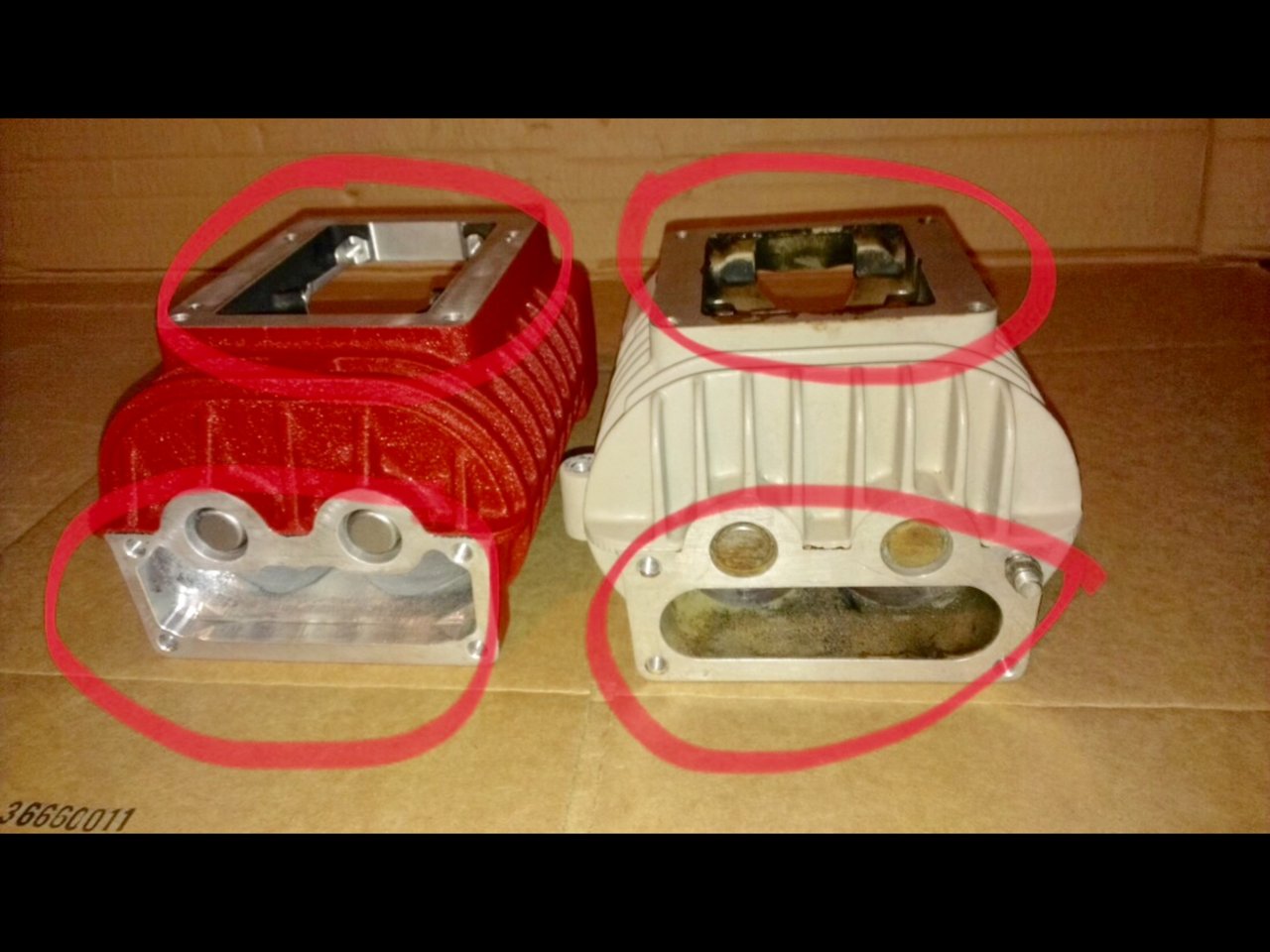

    Let me know how that goes.
    Next week I’m sending my charger in to be ported, the inlet and outlet.
    Will be interesting to see what results I get.
    This is a photo of a before and after ported supercharger.
    It lets more air in and more air out.
    SwampYota likes this.

    Less drag...put that boost to use.

    How do they go about adjusting the rotor tolerance?

    Tol
    The coating Tolerance can be added by the amount of
    coating that is layered on between the case
    and the rotors, with no coating there is a small gap, with coating the gaps are much less and better tolerances for more boost
    And a better seal between the rotors and inside case walls.
    otis24[QUOTED] likes this.
  6. Oct 11, 2018 at 3:04 PM
    #726
    1997tacomav6
    1997tacomav6 V6 5sp,RegCab,TVS1320 Supercharger,Haltech, 800k
    Oct 5, 2013
    #113940
    10,386
    John
    Denver
    97 reg cab, v6 5sp 300hp supercharged, Methonal Injection, 800,001 plus miles, Original Owner
    V6 5sp,RegCab,TVS1320 Supercharger, 56mm pulley, methanol injected Haltech ECU, AC Tvs1320 supercharger,(MUST DO) every 125,000- 150,000 needs rebuild Projector headlights HID 5 speed manual Amsoil for all drive train Smaller 56mm custom pulley, (MUST DO) 2004 DESNO fuel injectors, zero ping ping, 2004 side door mirrors Dick Cepek Rims, Michelin tires LTX, ATM Pathfinders Dynopro ATM ( that last 100,000 miles) Now running Dynopro ATM mud and snow tires KN cold air intake Cat back dual exhaust with ss exhaust tip, Raised exhaust tail pipe to 2" below body line Optima*dry cell battery,red top Alpine sirius radio, 200 watt amp, focal is165 split door pod speakers Focal door speakers Subwoffer behind seat Viper alarm, Electric Locks Dark tinted windows, bucket seats corbeau lg1 Tacoma Rubber floor mats TRD fender extenders, Bilstien shocks, King shocks JBA UCA trailer iv hitch, electric brake control, Drilled slotted brakes, High carbon steel (MUST DO) EBS green stuff 7000 series pads(MUST DO) TRD engine oil cap TRD stick shift, Marlin crawl shift kit. Rear sliding window 2002 4Runner functional hood scoop cut into Tacoma hood, 4Runner dual overhead map light Gentex Auto dim + Compass + Temp, garage,rearview mirror Snow Methonal kit stage 2 Custom 3 core aluminum radiator Linex bed liner Haltech stand alone ECU, Intake supercharger gauge. Stainless steel brake lines, Custom leather wrapped steering wheel, Haltech stand-alone ECU,
    Think of it like an engine piston with no compression rings.
    The smaller the gap between the side of the piston and the cylinder wall the more compression.
    So having the rotors coated and the inside case coated you will have better boost with a smaller gap.
    otis24 likes this.

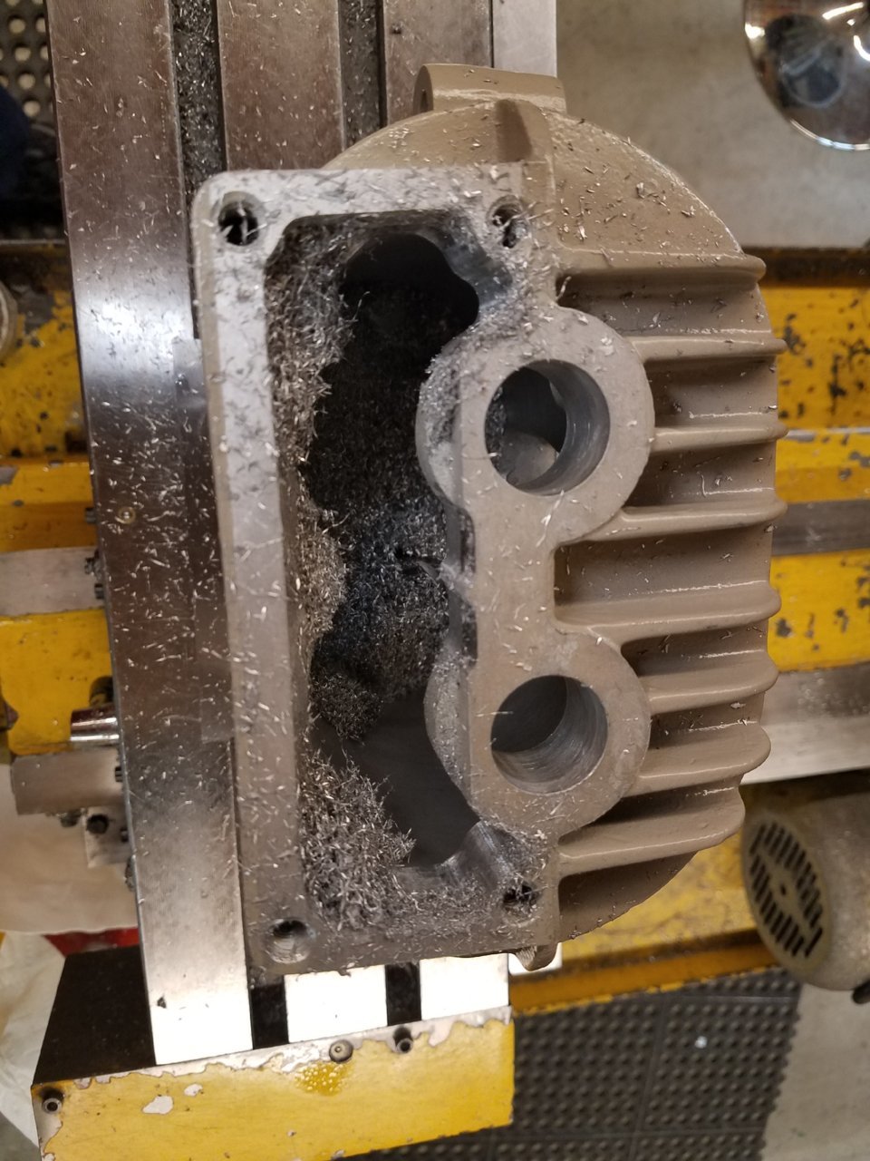

    Supercharger was ported today, will have new bearings put in since its apart and should be up and running in a week or two hopefully with some good new power numbers.
