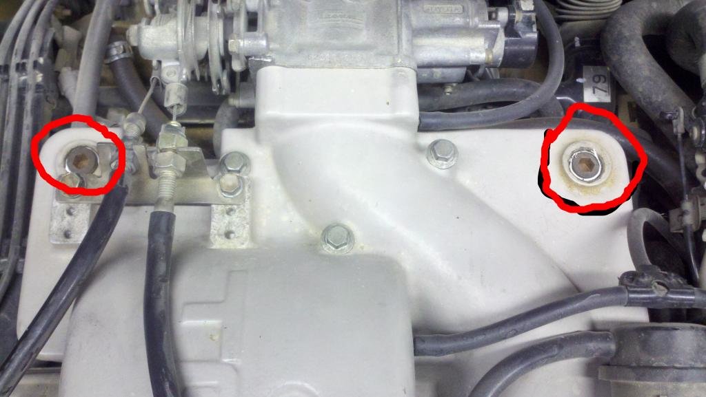

    Alert for First Gen S/C units. I put some hard miles on my S/C while at the Dunes meaning it was running higher temps than normal, so the following week I was at the desert doing a night run when all of a sudden i hear a loud whine from the supercharger and when i let of the gas the truck would low idle to the point it died. really thought i damaged something bad. i open my hood to inspect and found that the casting plugs on the top of the charger where loose and one had actually fell off and landed on the heater hoses next to the fire wall. where i luckily found it and was able to put it on and somewhat tighten it with a screw drive enough to get to camp.
    I have them on there with Teflon but will be removing them and installing them with Green Loctite.
    And figured throw the alert for you guys to check these plugs.
    circled in red for first Gen S/C's I don't know if the second Gens (black) have them somewhere.

    1997tacomav6 likes this.
