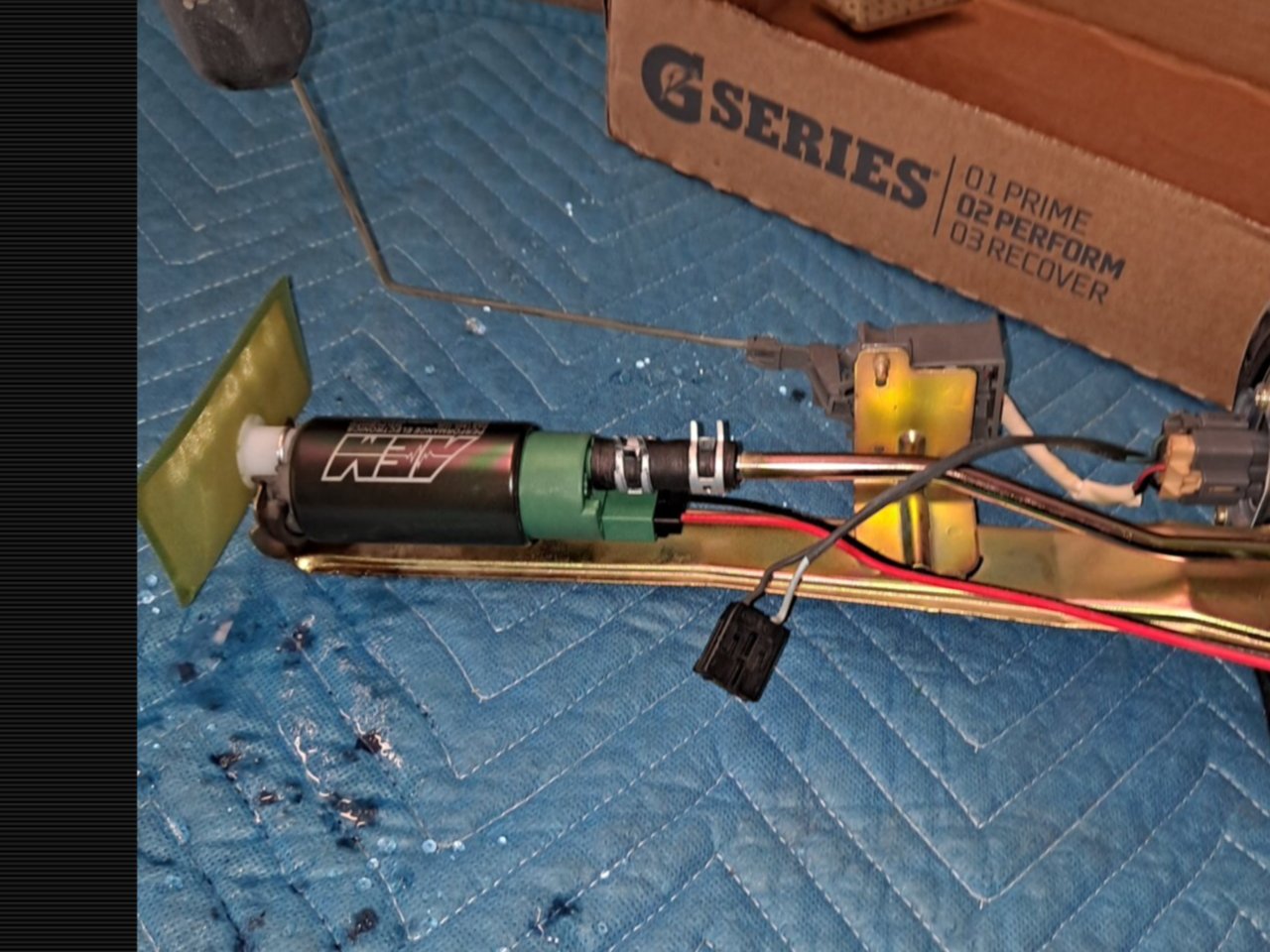

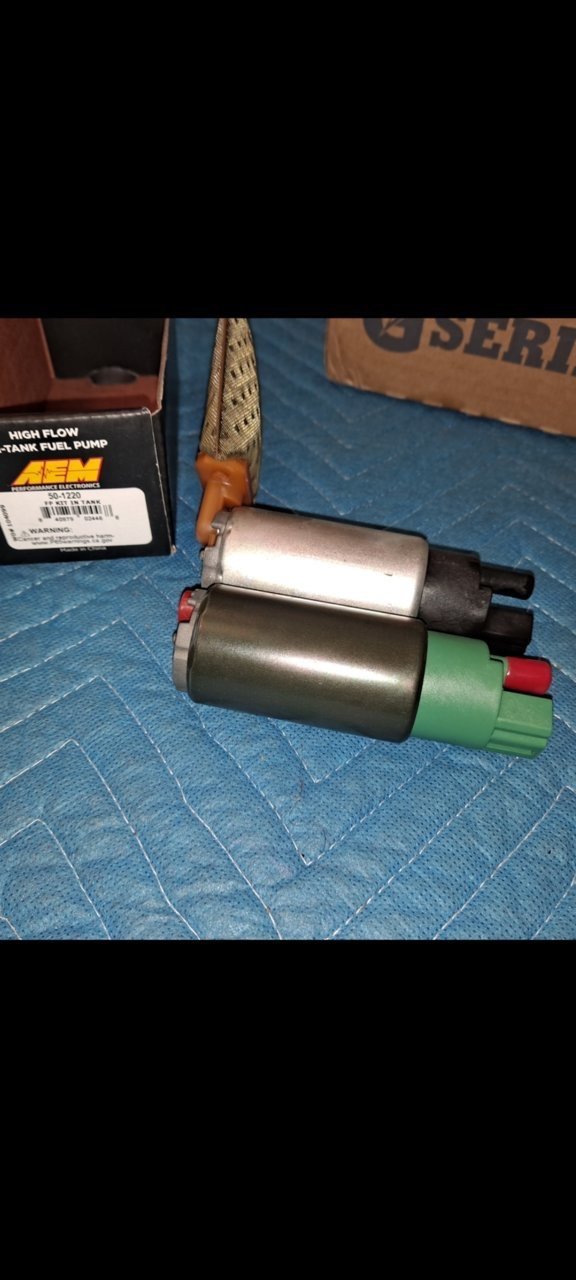

    I just installed the AEM 50-1220 340LPH pump last week.
    It’s almost identical to the stock DENSO pump,
    Aem wires are thicker and needs to be rewired to use the AEM plug.
    This pumps is a high output and now my engine doesn’t need the methonal injection with the stock
    injectors with a 1.9 pulley for added fuel.
    Will run water now for the summer only a #2 nozzle.
    Rented this Pittsburgh engine hoist for 27.00 for the day.

    No more meth because you can get all the fuel the engine needs due to larger fuel pump and the stand alone ecu?

    Yup!! You might get these results with the OEM ECU and this high flow AEM 50-1220 fuel pump Too.
    My advice going forward for anyone with a supercharger is,
    1) install a high flow fuel pump
    2) service the injectors.
    This might eliminate the need for a 7th injector or methonal for the Added fuel

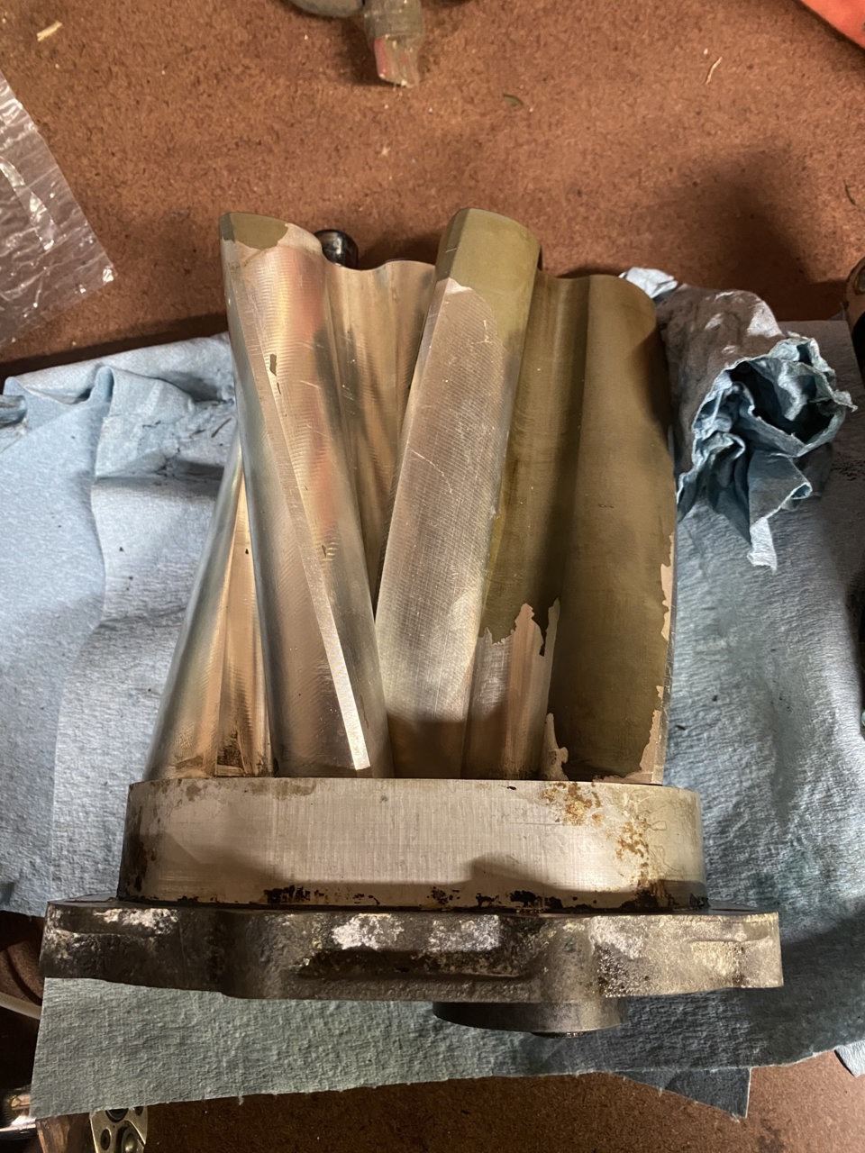

    Well, I just spent a shit load of money to get a rebuilt rotor pack from highspeedlabs, but that should get me back to a like new sc. 8 weeks is going to be a long time to have my truck down, ugh.

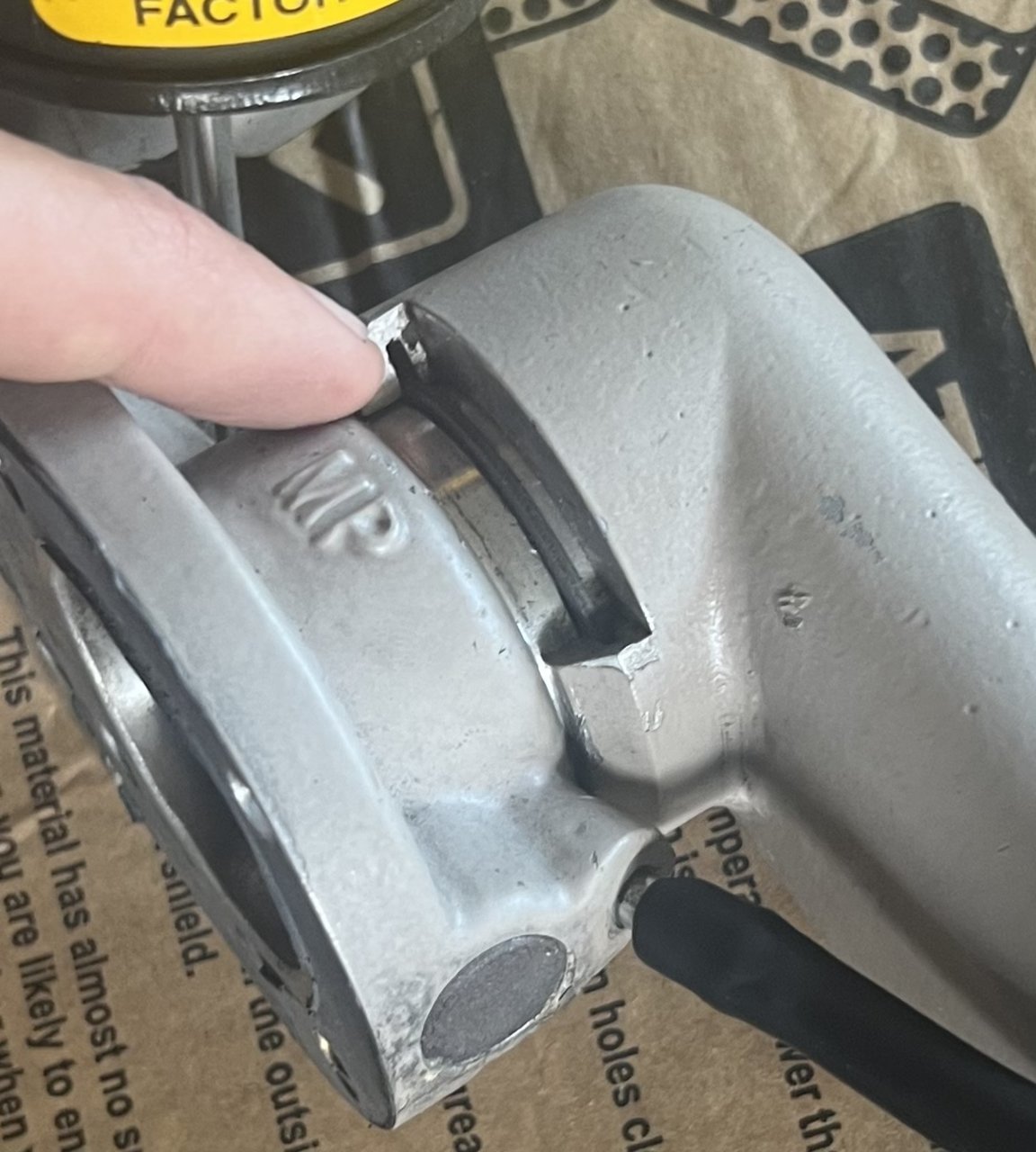

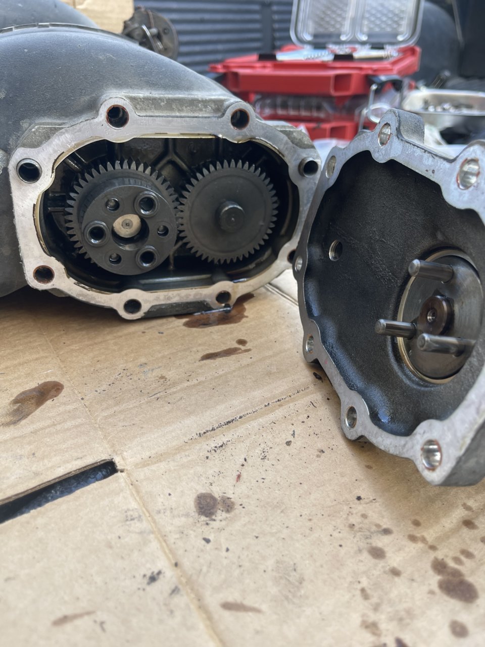

    Hey guys, new to the supercharger gang. So I am rebuilding the supercharger before I put it in my truck… About the rear bearings, can you press or beat both of them out or just the one that pops out on the outside? Anyone have some more detailed photos on how this is done or even just an explanation?

    #156690
    273
    2001 4x4 Tacoma
    Camburg UCA, King coil overs, Fox Shox, Deaver springs, BAMF sliders & LCA Skids, Relentless Skids. Lights on lights on lights
    Also is it possible to clean out the manifold somehow? Mine looks like it had a lot of oil burn through it

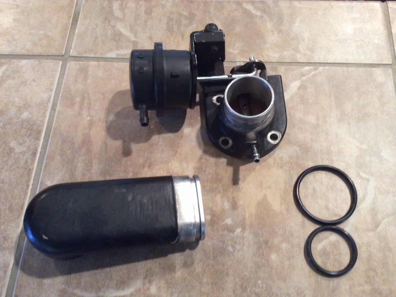

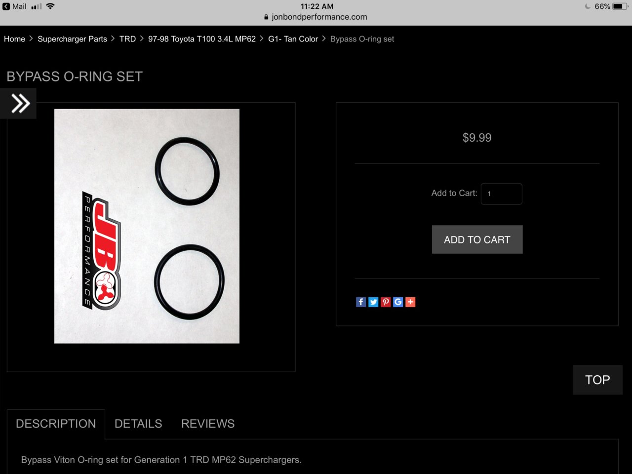

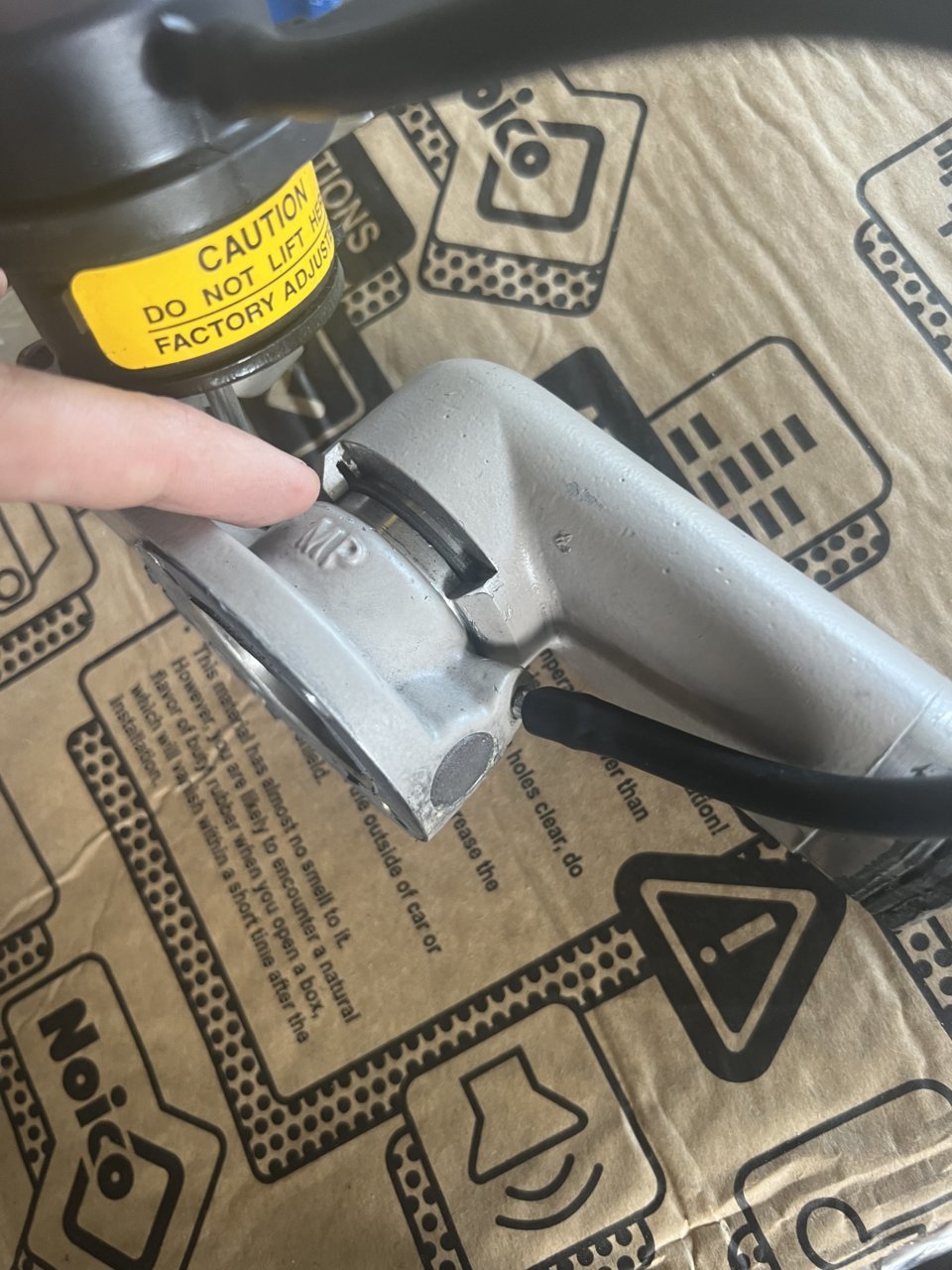

    Back up o-rings is a good idea.. Feels like the bottom o-ring will also break when removing/installing the elbow..
    Do you just pull/push on it and pray the Oring stays in the groove & doesn’t tare? :fingerscrossed:
    Forgot to order a backup set so working with only one pair of o-rings :anonymous: Looking to get it right the first time..
    1997tacomav6[QUOTED] likes this.

    Those two sections should pull apart and then put the new O RING in, that one is very easy to do.
    The other one is harder as it likes to roll out of the groove when you install it and will rip easily
