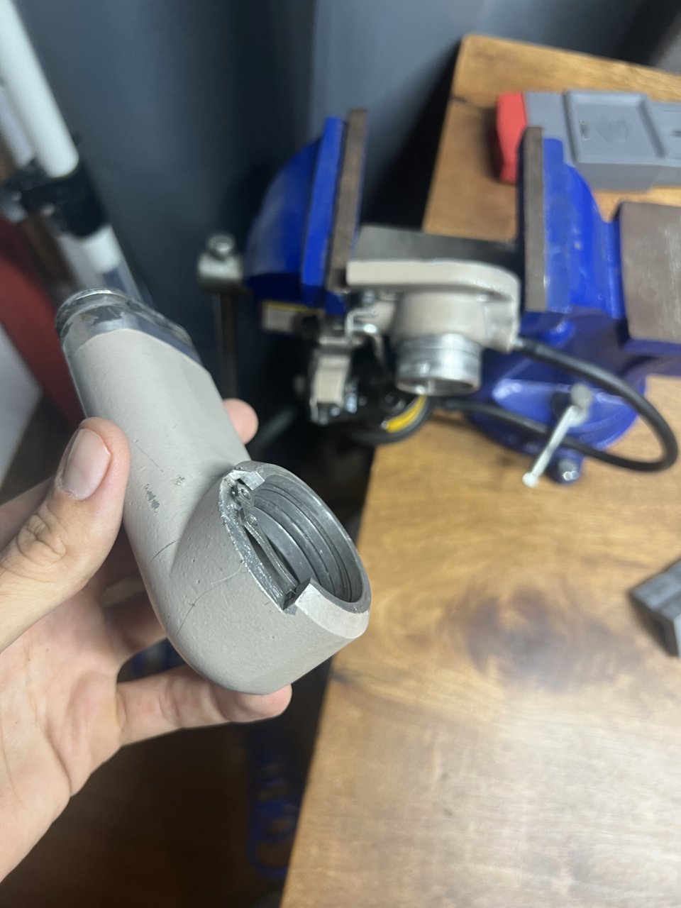

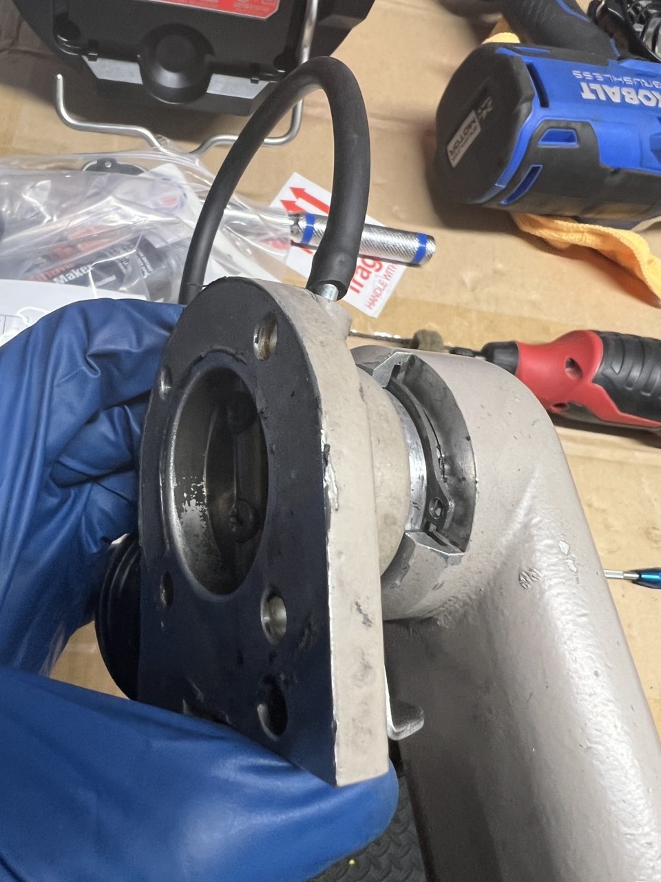

    Strange.. I’m running into a metal snap ring looking thing that’s stopping me from pulling it off

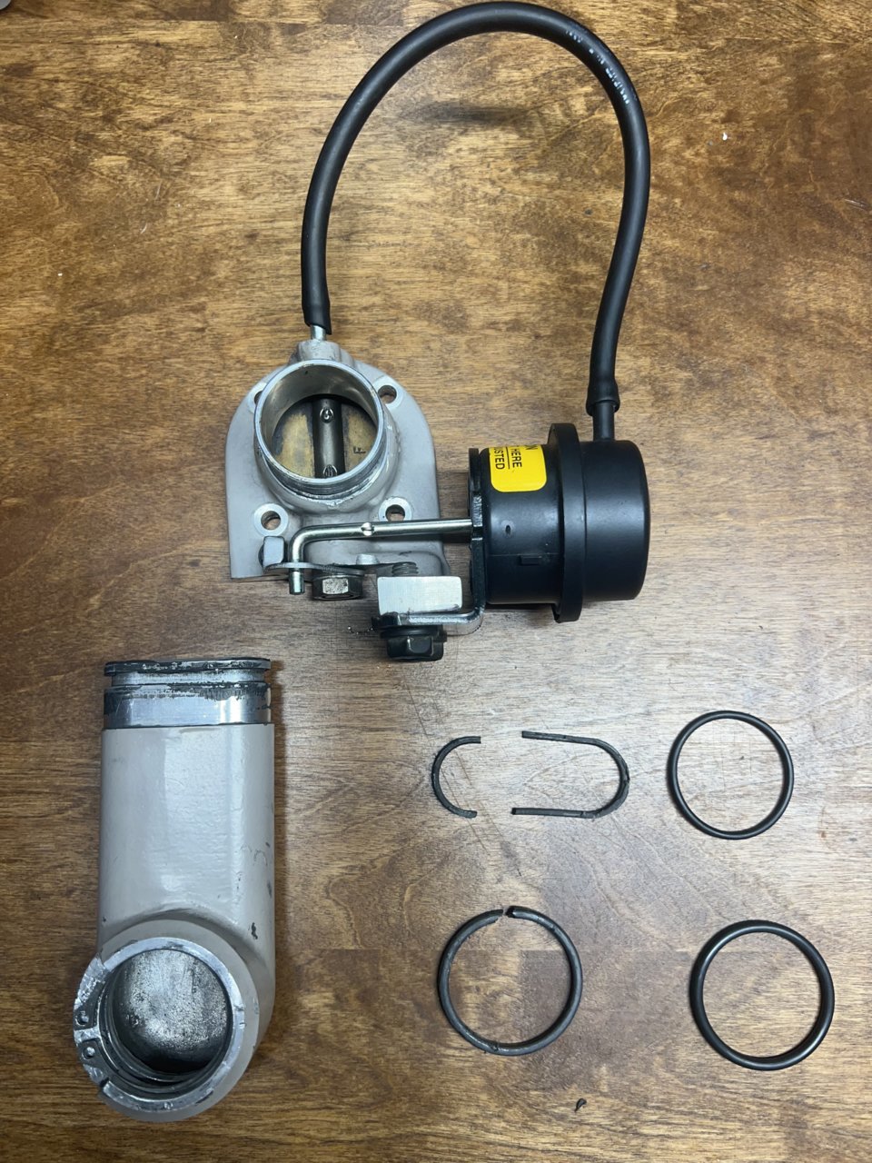

    Rotate that ring a little farther and you'll get the other snap ring eye. You have to open that ring up to release the inner part.

    Or spin the housing to show both ring holes. It will pull right off

    Just needed a vice for the extra pair of hands.. thanks again
