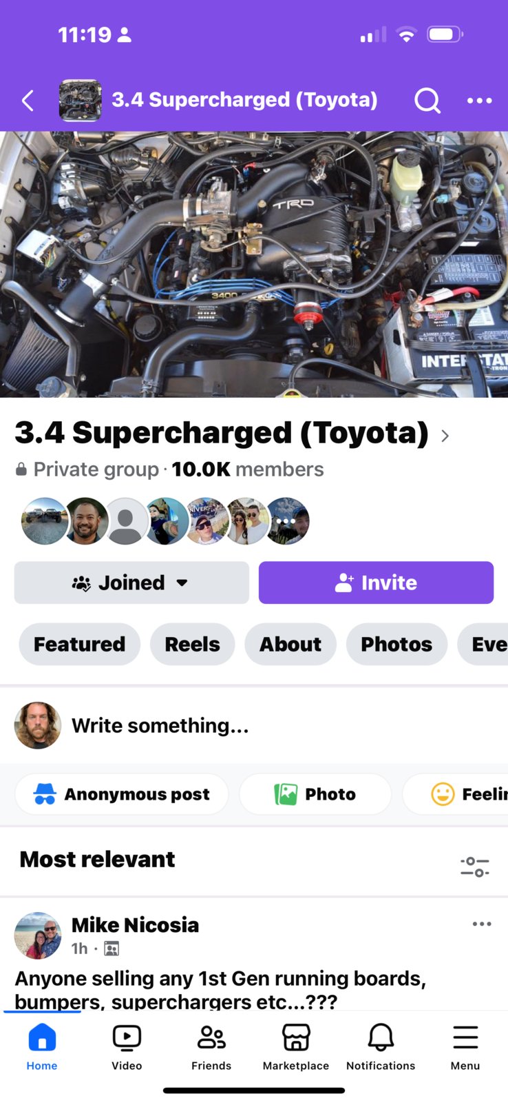

    $2750 is a good price, by the way. I think it’ll sell pretty quickly. There’s a 3.4 supercharger page on Facebook that gets a lot of views. I’d post it there as well. Good luck!
