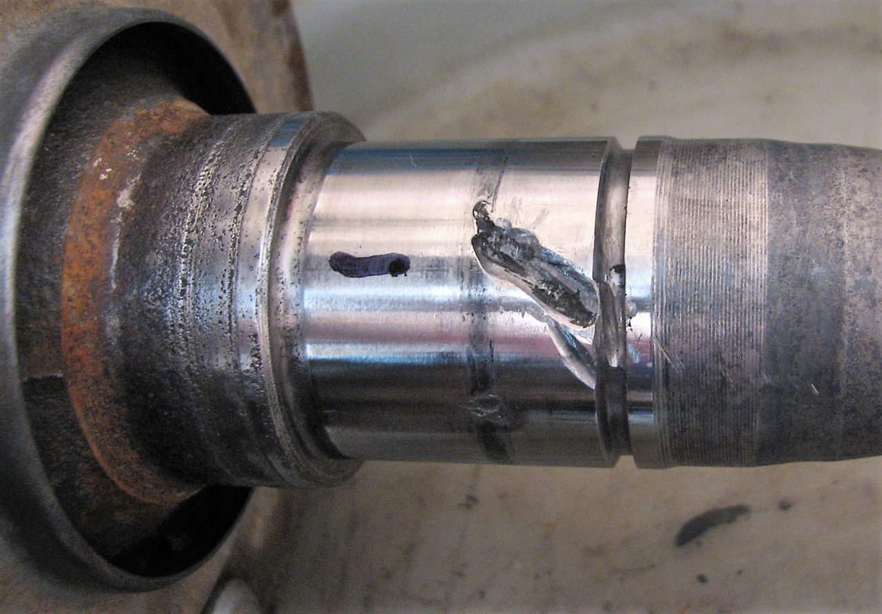

    Bud, my problem here is not getting a shop to do the work. They all want and need the money. But below is an example of the level of craftmanship available here. I asked a local full time trans/diff shop to install new wheel bearings on my axles. So they cut the old bearings and keepers off with a blow torch instead of pressing or splitting them off. I was a full-time welder for years & have washed many bearings off without cutting the axle at all. This is the work of a doped up kid with a torch. And there was a similar torch cut on the other side of the axle.

    :facepalm:
    I coulda done a better job with a hack saw.... Hell of a lot better!

    I see your point!!

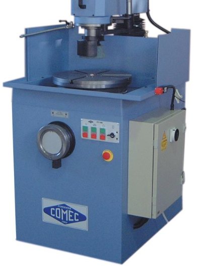

    Flywheels need a special grinder to resurface. They need to be bathed in cutting oil or water soluable oil while being cut.

    Interesting over the years I have watched many flywheels being turned on just a Lathe. That worked just fine.
    No wonder it is so very hard to find a shop that still will do them . I know none of the auto machine shops in my area had any of those special machines .
    Unless they bought them in the last 2 years or so.
    Now I can understand it is cheaper to just buy new

    I have also helped turn several flywheels on a standard lathe setup without an oil bath and never had a problem. My job was to run the oil can while my buddy, the master machinist, operated his lathe. If I have to take a road trip to New Orleans (175 miles each way), I can get the OEM flywheel professionally turned there. Several places have the proper equipment to do it right. And they are FAST, as in drop it off in at 8 AM and pick it up after 3pm. But the chances of finding a shop in my area of MS with a sophisticated and dedicated flywheel grinder is almost certainly zero. A shop would need high volume to pay for a dedicated flywheel grinder. The LUK flywheel alternative is looking better all the time.
