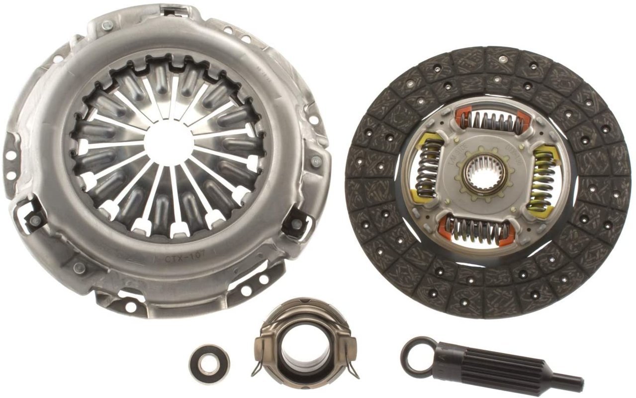

    The AISIN CKT-040 kit is very hard to argue against. If I were rock crawling, I would definitely prefer steel spring seats like the original OEM Toyota/AISIN disc or the aftermarket Exedy disc. But my '97 Taco is a hunting rig for use in the MS mud.
    Aftermarket AISIN CKT-040 has plastic spring seats in the disc. The current reman OEM Toyota disc also has the same type plastic spring seats as the aftermarket AISIN.

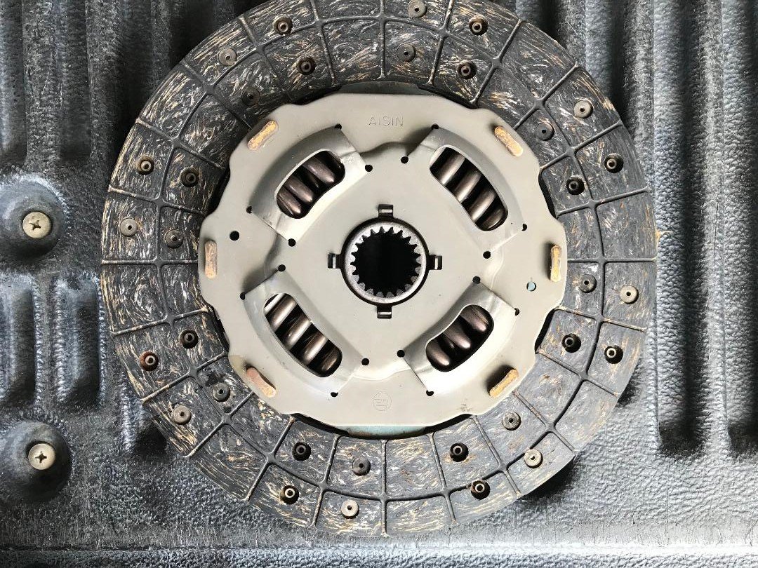

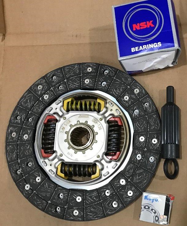

    Just a quick follow-up on the aftermarket AISIN CKT-040 clutch kit purchased from the AISIN store on Amazon for $251 + tax shipped. This is a new AISIN clutch assembly, not a reman like the currently available OEM Toyota factory parts. The disk and pressure plate are AISIN marked and "MADE IN JAPAN" is printed on the box. The T/O Release Bearing in marked NSK & JAPAN which is the same as the original OEM T/O bearing my '97 Taco came with. But the Pilot bearing in the AISIN kit is marked KOYO 6201 RS & ROM. The pilot bearing box is marked 62012RSC3GXM and MADE IN ROMANIA. The original OEM Pilot bearing was marked NSK 6201V 911 JAPAN. I am a big believer in JAPAN seal & bearing quality. So for $6, I will get another OEM Toyota NSK JAPAN pilot bearing. This is probably overkill. But like the original OEM Toyota/AISIN clutch that came with this '97 Taco, the OEM NSK pilot bearing and OEM NSK T/O Release bearing lasted for 25 years. I will have greater confidence going back with the same parts. .02

    Bearings have a universal part number used across all manufacturers. The "6201" in the part numbers designates size (some will call it a "201" bearing, still same #s). While the remaining letters describe how the manufacturer shapes the cup, cone, and seal. So long as you have a "201" bearing with the same seals (plastic vs metal, 1 side sealed or both) it will be the same part. Of course, if you want the original brand that's your prorogative. Good luck! :bikewheelie:

    If the KOYO bearing was a JAPAN made part, I would use it with great confidence. It is a 2RS type bearing with seals both sides and looks to be of high quality like all KOYO JAPAN bearings and seals I have used. But I would hate to have to tear the tranny out just to replace a bad $6 pilot bearing. Just for reference, the original OEM pilot bearing and the T/O bearing definitely showed the effects of my offroading torture and needed to be changed out. Neither bearing had a lot of life left, especially the T/O bearing. Appreciate your input bud!
