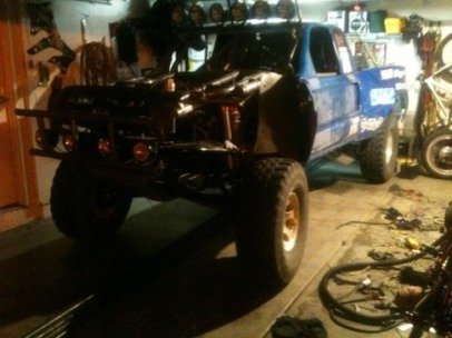

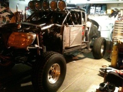

    ae445b78-6378-9b76_0b7cf3c2abc755deb0f0cadbd69a97edc903689b.jpg and with the body offae445b78-6388-fe6c_09cdade410e3c9a202b9a150d4cc7650309e0c5d.jpg

  18. Dec 30, 2011 at 11:00 AM
    #18
    jberry813
    Jan 21, 2011
    #49636
    28,479
    Jason
    Lake Tahoe
    2012 DCSB Sport
    ...too much shit to list.
    So I had the EXACT same symptoms happen to my truck, and I thought no way the same thing happened to you. But after seeing pictures of your truck, I can see a distinct possibility of it happened. Mine happened when I put the new motor in my truck. And judging by the pictures of your truck, I can imagine the engine being removed at some point.
    In the end the problem with my truck was Plug A (plug all the way to the left) on the ECU wasn't fully seated. It was seated enough to get the truck started, but then the idle just slowly got lower and lower, zero throttle repsonse, and the fail. It's a long shot, but I'd suggest disconnecting the battery, unplugging and reseating all 5 pigtails on the ECU and try again.
  19. Dec 30, 2011 at 11:06 AM
    #19
    Goofballracer
    Goofballracer [OP] Well-Known Member
    Dec 29, 2011
    #69576
    94
    Brennan
    San Diego
    2002 Toyota class 7 race truck
    Full cage fiberglass cab 35" tires ford 9" with spool
    I'm going to do this to see if it will help
