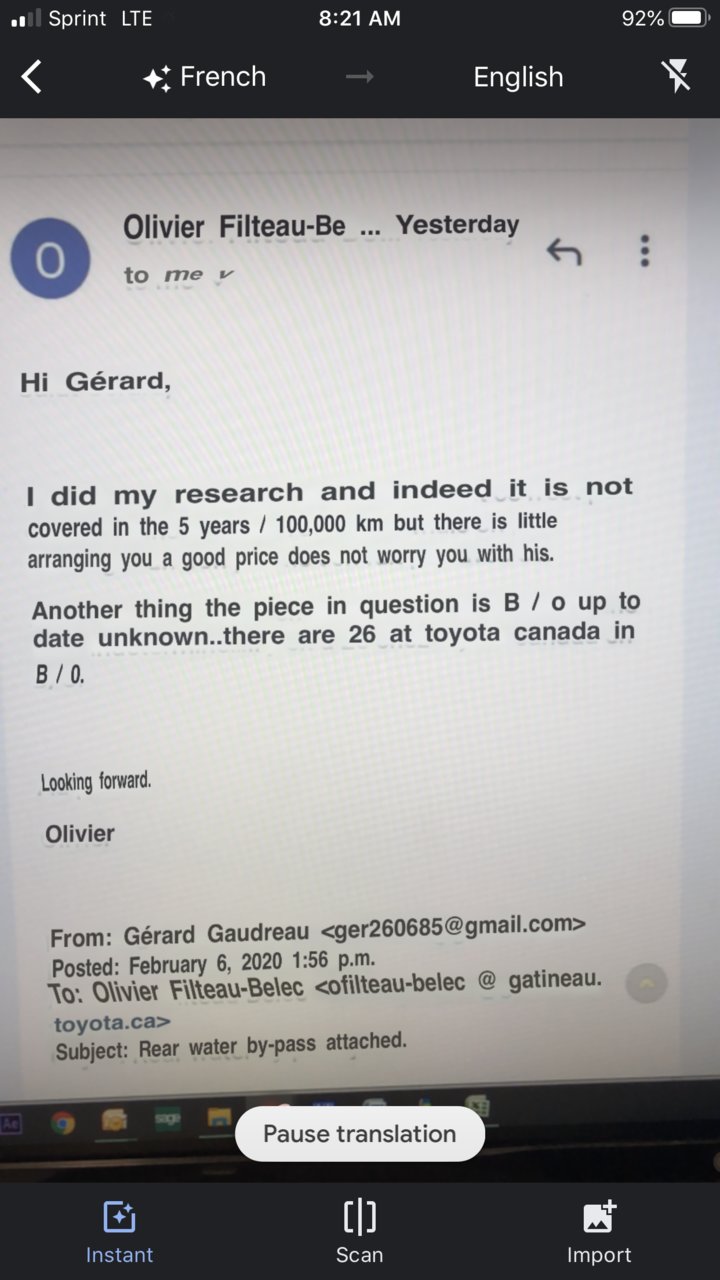

    Toyota Corporate, open a case. What they say is final. Worse they can say is no at this point but this doesn't sound right at all...
    1 (800) 331-4331
    Junkhead, na8rboy and Ger260685[OP] like this.

    Thanks alot its appreciated!
    Junkhead and LivinOnEdge[QUOTED] like this.

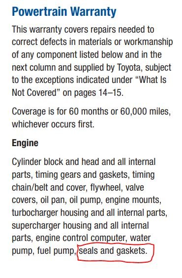

    It's bolted to the engine. If it fails, coolant is lost, and the engine overheats, which is powertrain.
    I don't understand why it's not covered.
    Worth some more phone calls.

    For anyone wanting to read the screenshot, its not informative or 100% accurate at all but here you go...

    This should be covered by your powertrain warranty. That's an email from your dealer? I would find another one..

    In the owners manual...
    It's also not something listed in any of the exclusions. OP don't roll over. It's your right as an owner to have this repaired at no cost to you. Open a corporate case.

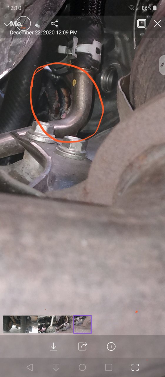

    I just noticed that problem on my 17 Tacoma Sport with 32k miles.
    Wondering if the guarantee apply for rebuild title. Now l know others have same problem and it wasn't caused for the accident.
    And yes, that part is a pain..

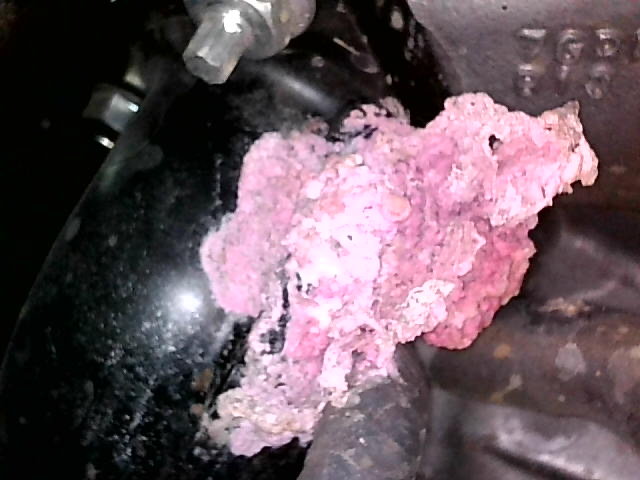

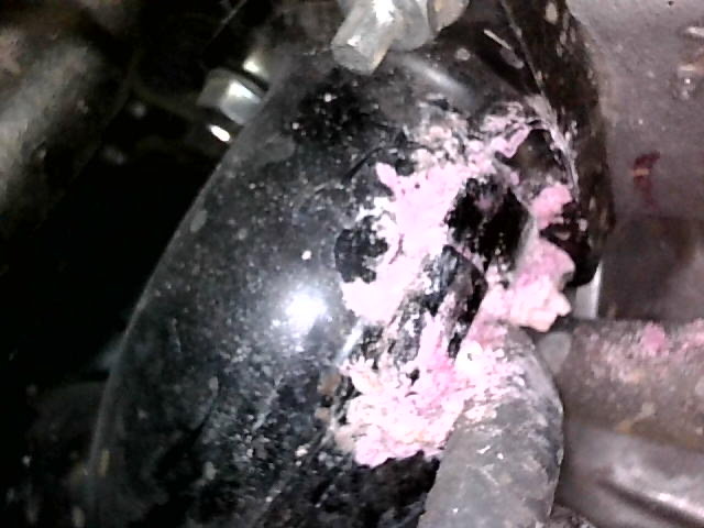

    Seems like a bad deign imo. The piece should allow some changes in dimensions between the two metal parts. Even small changes from heat expansion and contraction will occur and the plastic piece cannot absorb that and will crack. Imo all will eventually need replacement during the lifetime of the engine, maybe a few times. If it keeps cracking it’s not the part, it’s the design. You actually think the plastic piece is defective, no way. Someone needs to design an aftermarket part for toyos screwup.
