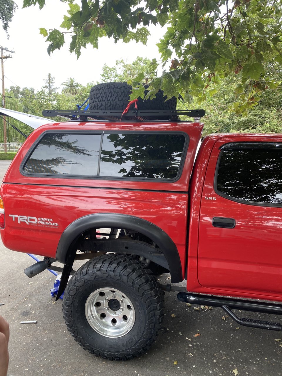

    Wanted to update for those who may want to see this after I've done the work and were clueless like I was.
    Thanks to all these fine people at TW and some friends for help.
    Day Purchased :

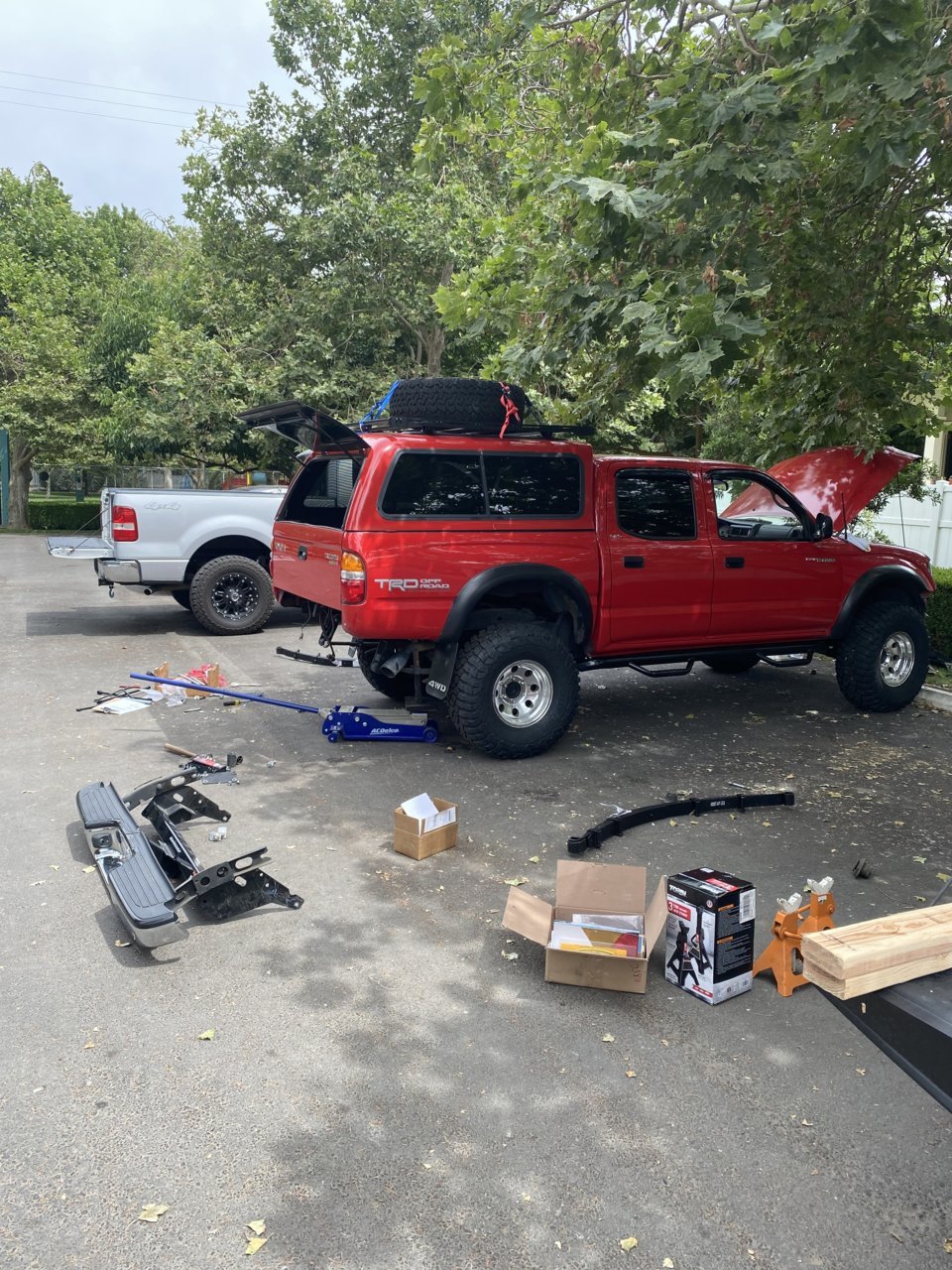

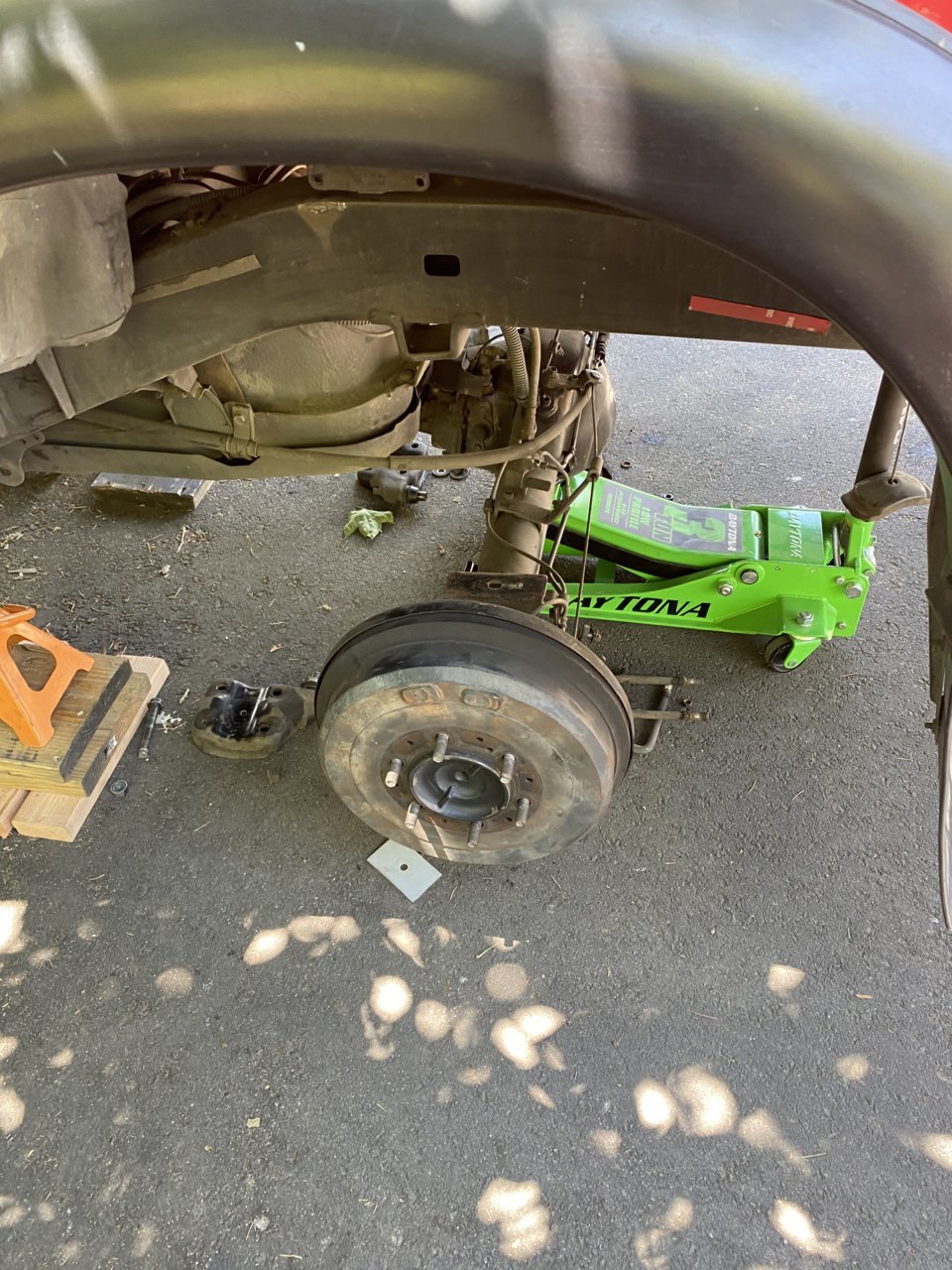

    After purchasing BFG 33" KM3's, Next was removing the body lift. Thanks to my girls brother for help.
    In middle of work: Front end finished now to rear.

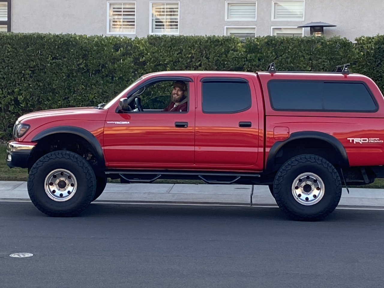

    Way it sat after body lift removal: still sagging due to crappy leafs and shackles, but feel much better about the truck handling and safety

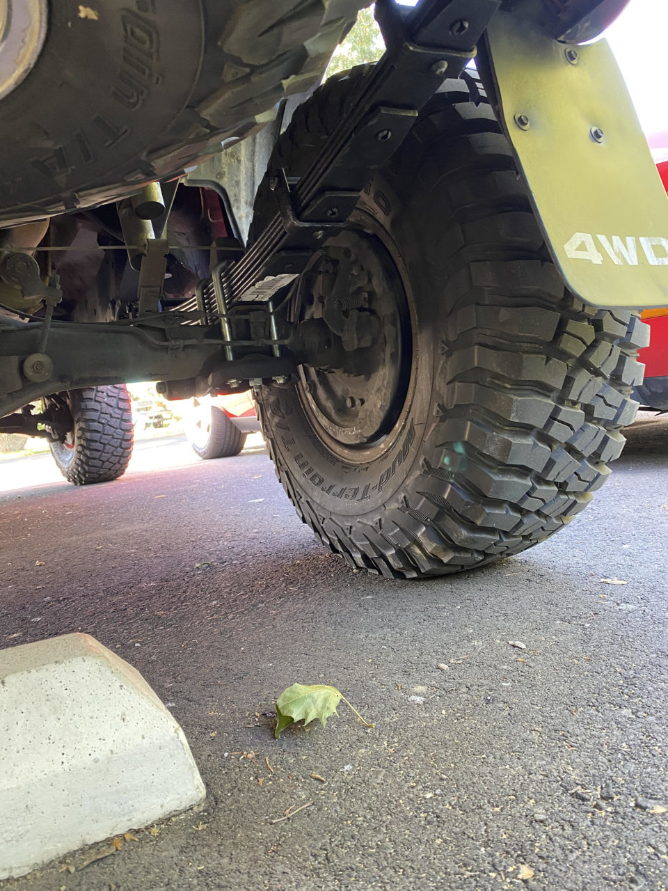

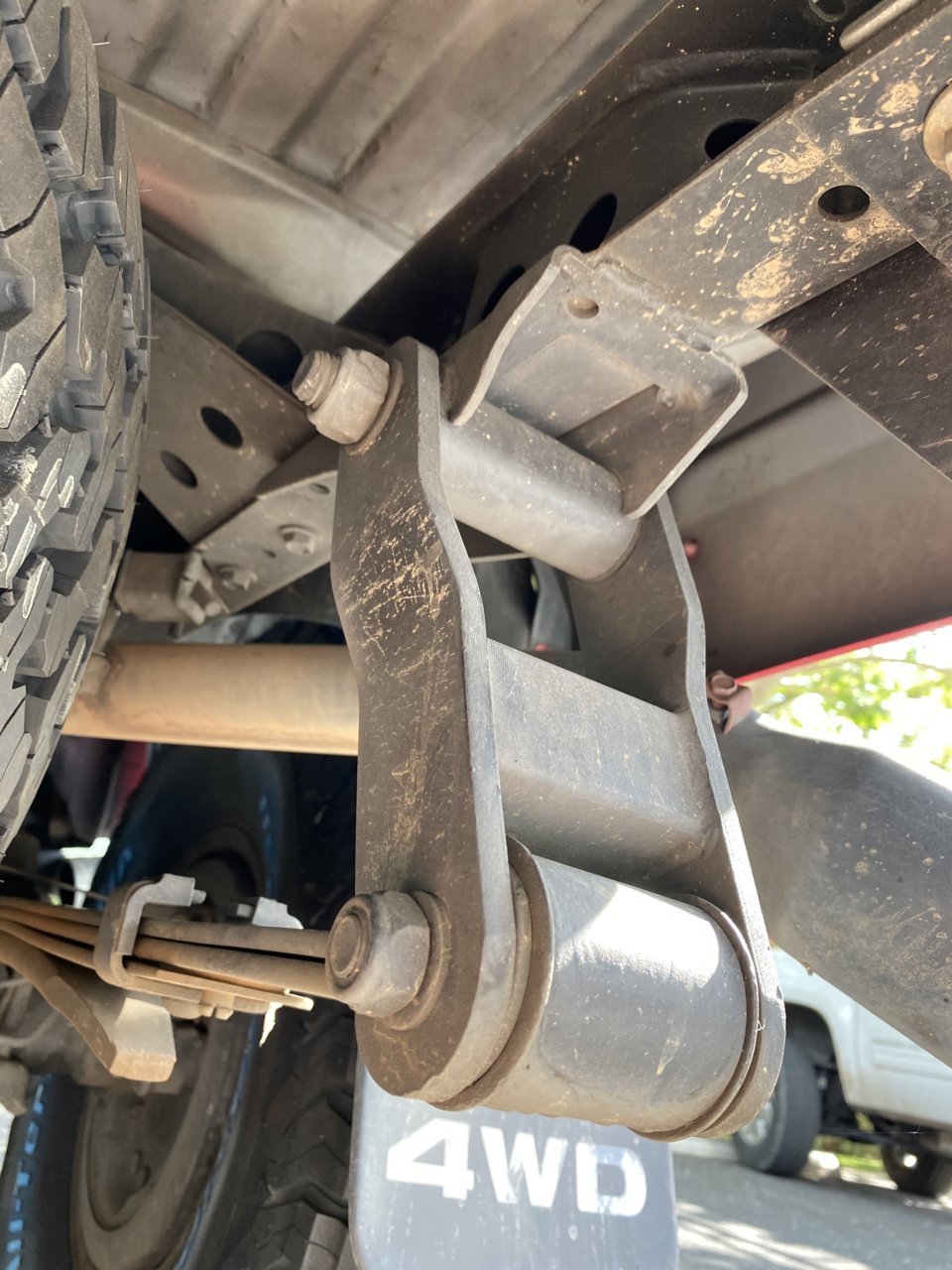

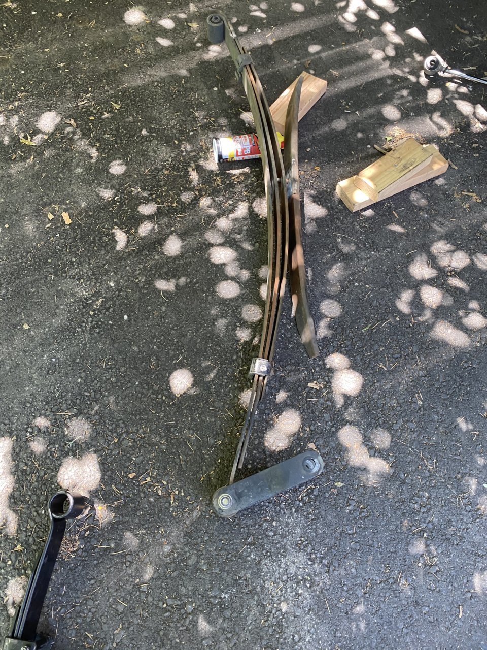

    Next on my list was new Leaf springs and shackles to make the handling and components the way they should be. Bought All pro Expo leaf springs & Stock height shackles from wheelers.
    old springs:

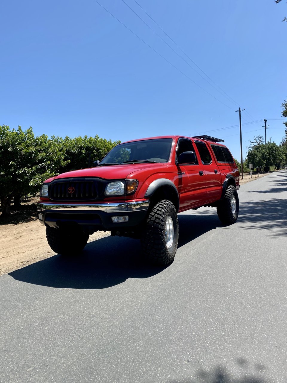

    New springs in:
    Body roll was really bad and now it is gone! Might have to get longer rear shocks due to it feeling like they bottom out with the new springs.
