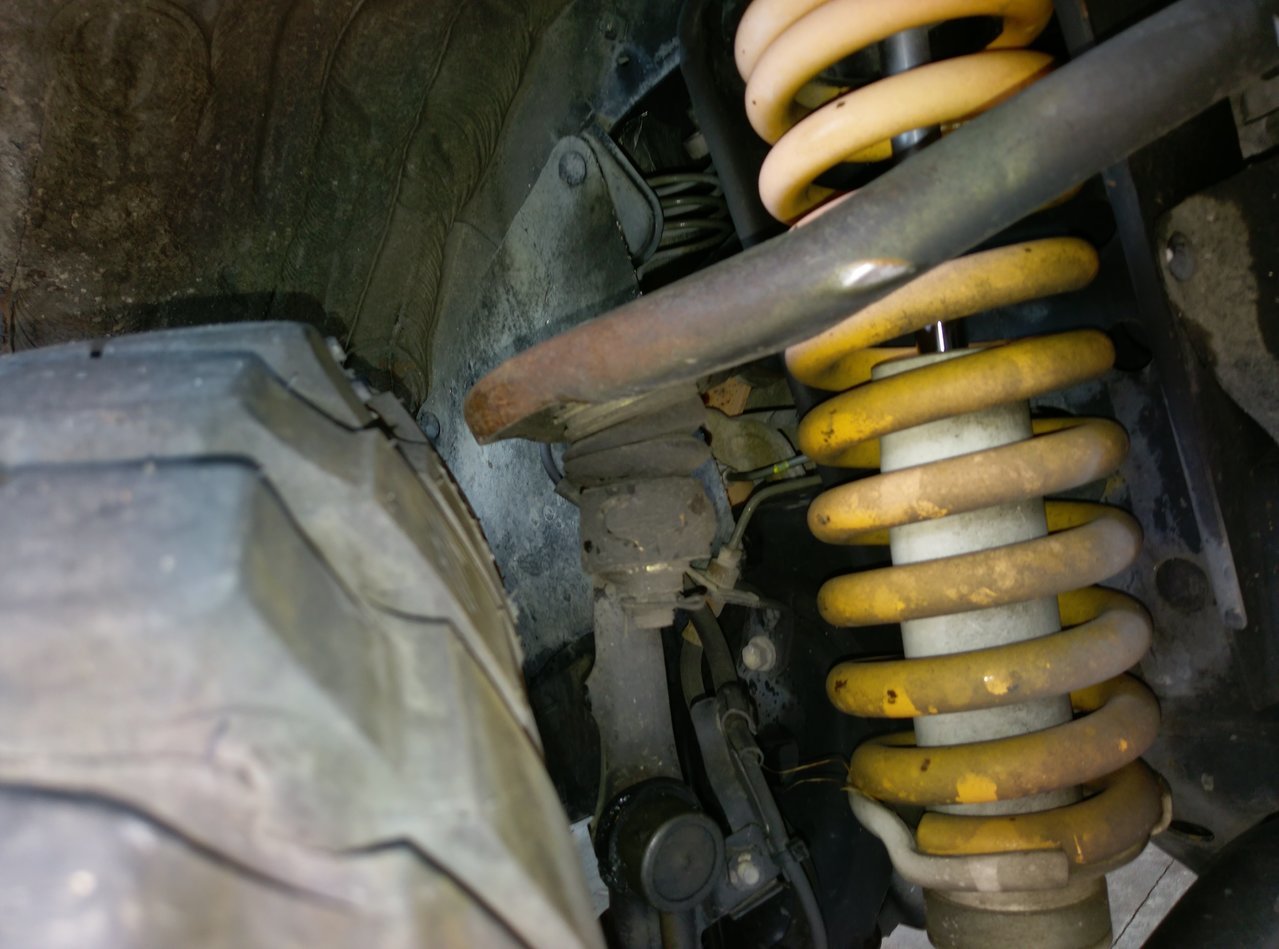

    3" lift
    (rubbing shown on UCA was from using same tires on OEM Tacoma TRD Sport Wheel)

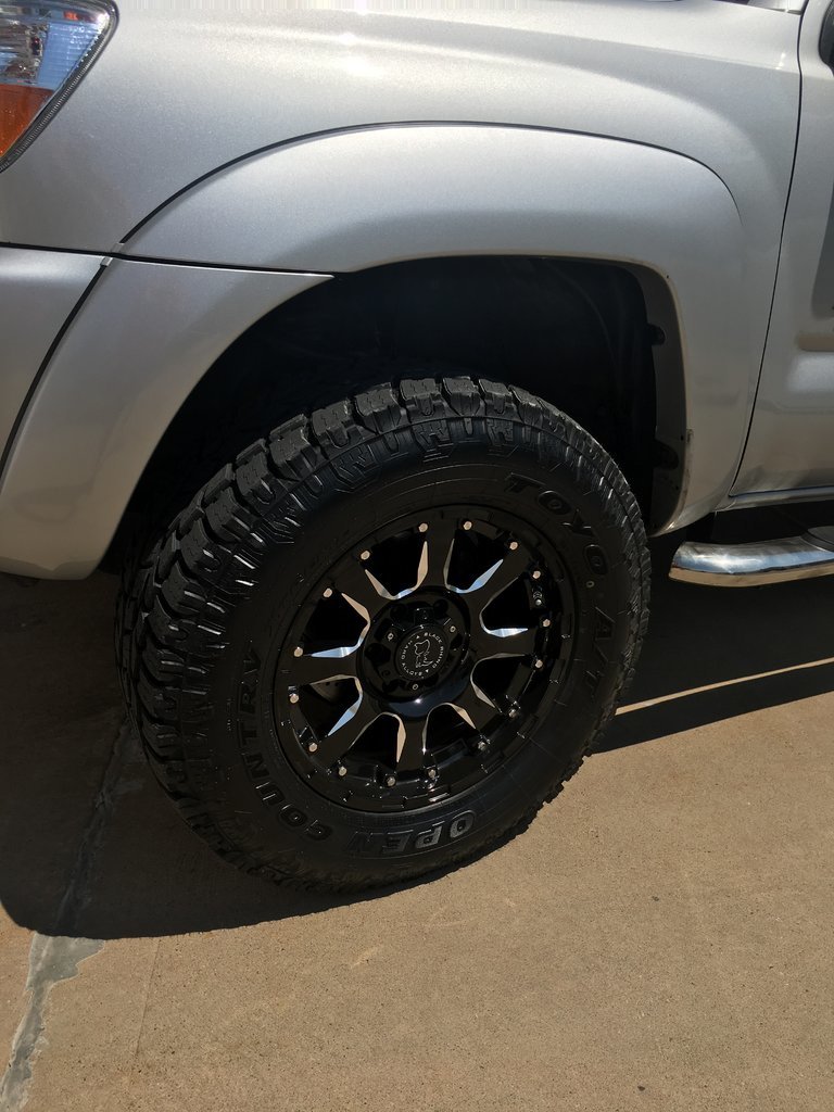

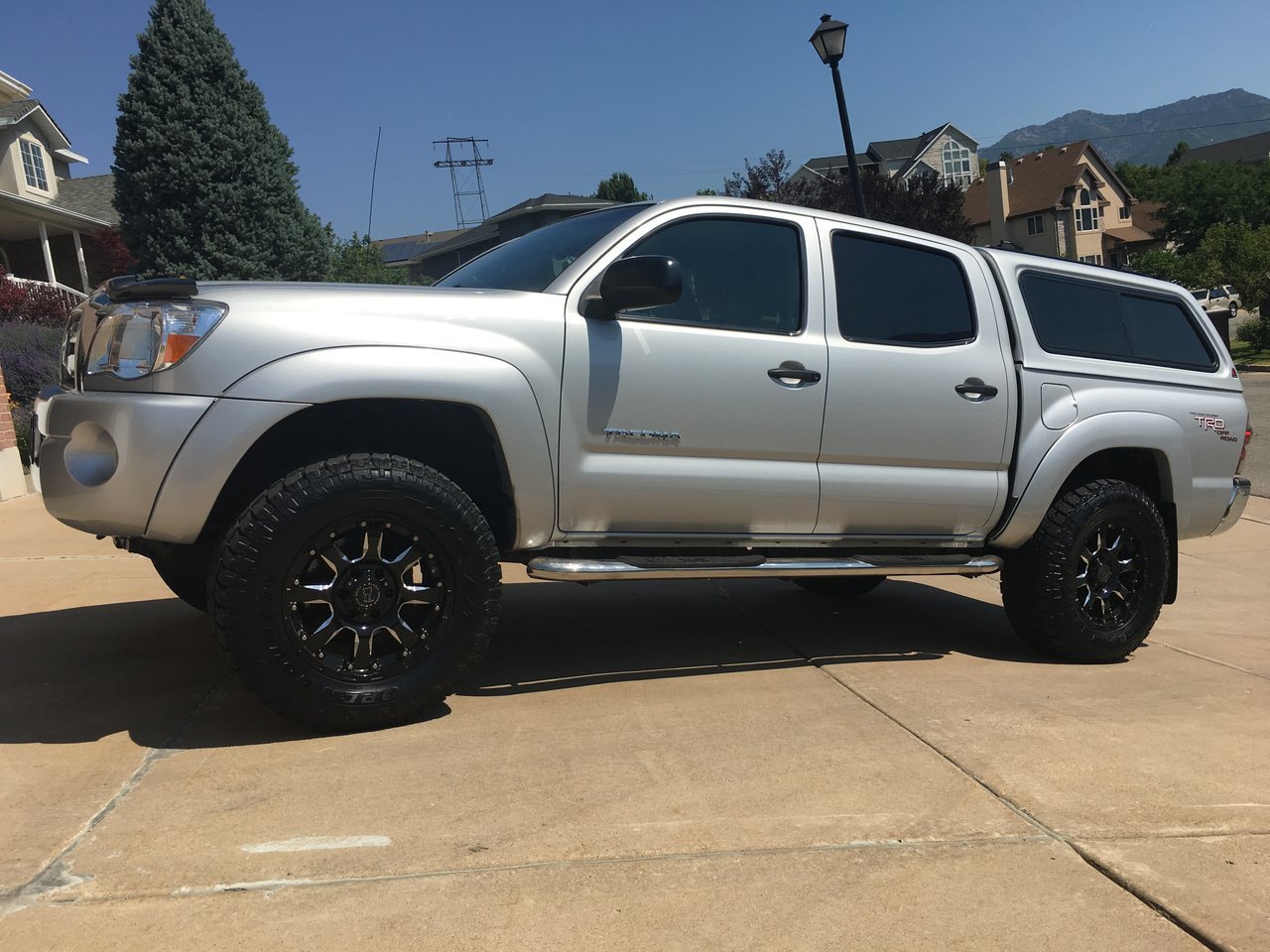

    Ok, here is the completed project. I am VERY happy with the results. Got 33's on it with only needing to remove the front mudflaps and heated up and pushed in the plastic inside the fender well slightly. No rubbing, ride quality is very close to what it was.IMG_4322.jpg IMG_4321.jpg
