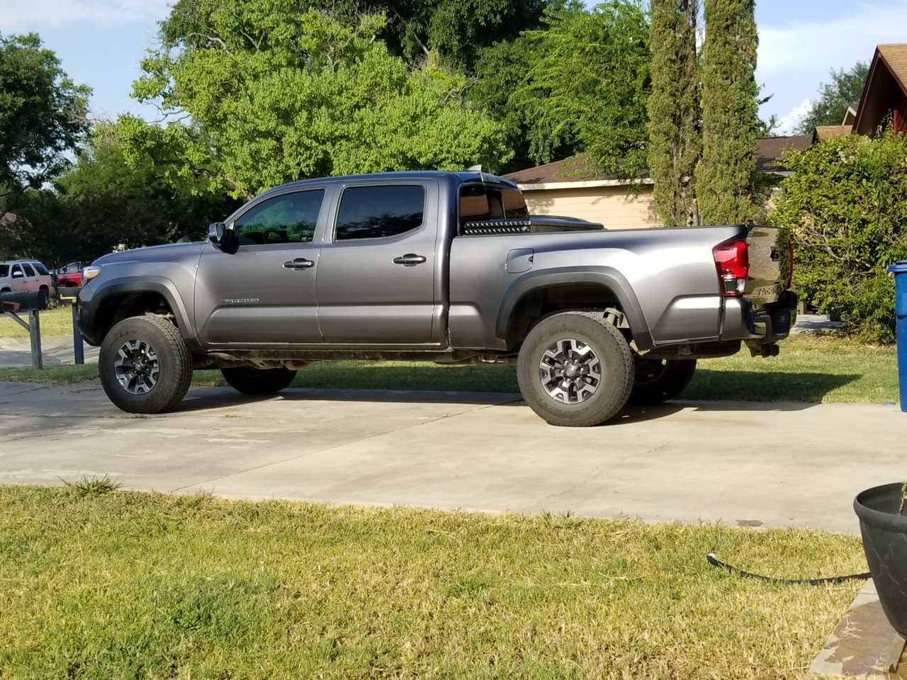

  20. Aug 6, 2019 at 3:21 PM
    #20
    Nash2017taco
    Nash2017taco Member
    Aug 6, 2019
    #301426
    9
    Dustin
    2017 Tacoma TRD Sport
    None yet
    What tires do you have on that? They look great! I’m thinking I may copy cat your lift and tire size.
