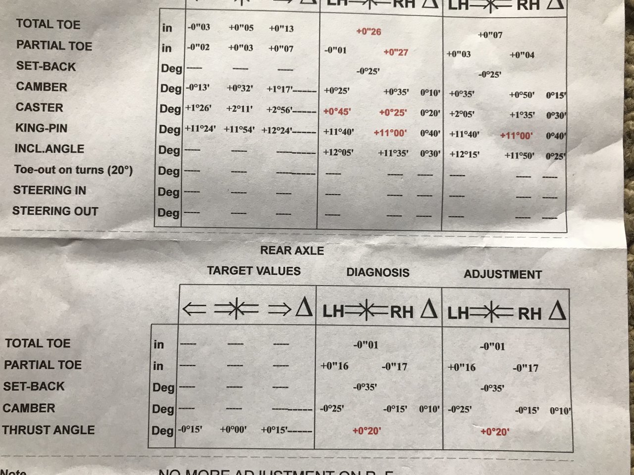

    2016 Sport with Bilstein all around, 887 OME coils .25” spacer drivers side and 1.5” AAL. The alignment shop is telling me they can’t get my steering wheel straight without sacrificing alignment numbers? Is this the case or are they being lazy? Thank you! 00F007A1-83DD-48CE-862E-6CBF13E8FC67.jpg

    I normally can read alignment specs but this confuses the hell out of me. Do you have OEM UCA's or aftermarket?

    That would have helped...I have OEM UCA’s. I am taking it back next week. The numbers confused me also!

    Lazy . steering wheel alignment is done with the tie rods. Nothing to do with camber or caster bolts/cams.
