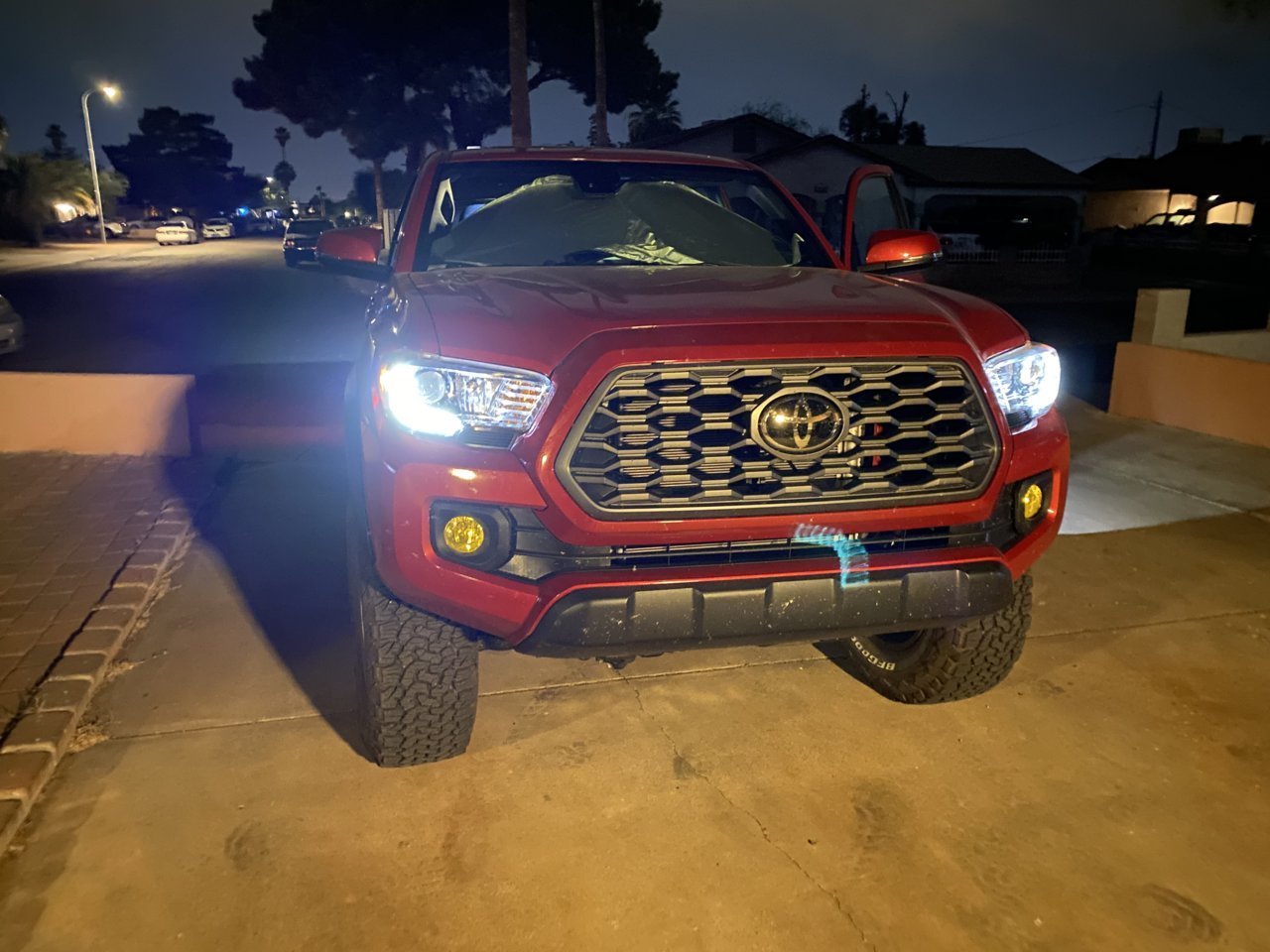

    285/70/17C BFG All Terrain TA KO2 Method 701 - Bronze 3”F/1"R Spacer Lift Sprint Booster MESO: Gasshole, Map Lights, Sequential Turn Signals Rough Country: Speedometer Calibrator, F/R Seat Covers R4T: Tail Gate Remote Rago: Center Console Molle Panel sPOD: Switch Controller Lamin-x: Amber Fog Light Covers ARB: Twin Compressor Slee Off Road: ARB Twin Compressor Mount Expedition Essentials: 3TPAM Accessory Mount RAM Mounts: Short, Long, Long arm, GoPro Mount
    285/70/17 KO2
    3”F 2”R spacer lift (for now).
    Method 701: 4.75” backspace, +0
    No wheel spacers.
    No rub.

    beautiful truck, nicely done.
    charliehex[QUOTED] likes this.
    Thanks for not bullying me for having a spacer lift.
    Quinnb88[QUOTED][OP] likes this.

    I got the lift from 4WP at about 300 miles so I kinda noticed a little bit of sluggishness and my Speedo needed calibration but the Rough Country calibrator fixed it. I get about 17.7 mpg on average; mostly city driving in Phoenix. Lots of 75-85 mph on the freeway.
    I added a Sprint Booster to remedy throttle lag and I’m going to stack an OV tune on top of that to improve shift points and hopefully mpg.

    I did the LaminX fog covers.

    They work for dusty trails at night. I’ll eventually go with higher powered fogs after some research and a bumper.

    This is real nice. I have a 2". With the adjustable coil overs, I've been debating pushing it to 2.5" or 3". You running any UCA with that 3"? Any driveline issues identified? I thought about pushing it to 3" and picking up the 2" blocks someone has for sale.

    No control arm mods yet. No rubbing or driveline issues on road or trail. I’ve put 9000 miles on it since the end of January and a lot of that has been high speed freeway and 250 mile drives from Phoenix to SW NM. Lots of variation in driving with no issues.
