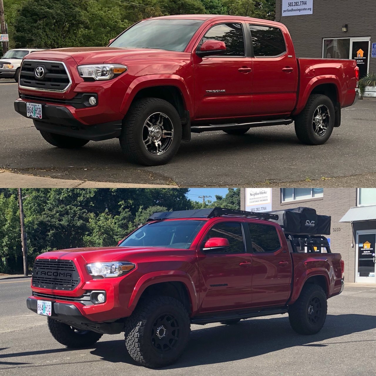

    I'm in the same boat, I just went with a Revtek leveling kit. Made is so I could get 33" tires.

    Nope not trimming at all. I haven't rubbed at all yet but only done some mild offroading no wheeling or anything.

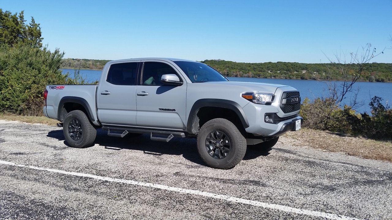

    Bought my 2018 TRD O/R 4x4 at the end of Sept. Took it to 4wheel Auto Parts and had the 2.25 Pro Comp front level with the front
    differential drop installed. The diff. drop is important to keep the cv joints at factory angle. I'm no pro at wheeling, just wanted something to be able to add some aggressive rubber when my stock tires finally wear out. Eventually may do a suspension lift, again nothing extreme, so I'm thinking 5100 Bilstiens all around just to level out and to not hamper the trucks ability stock.
    **EDIT** diff drop for 4 wheel drive models of course...

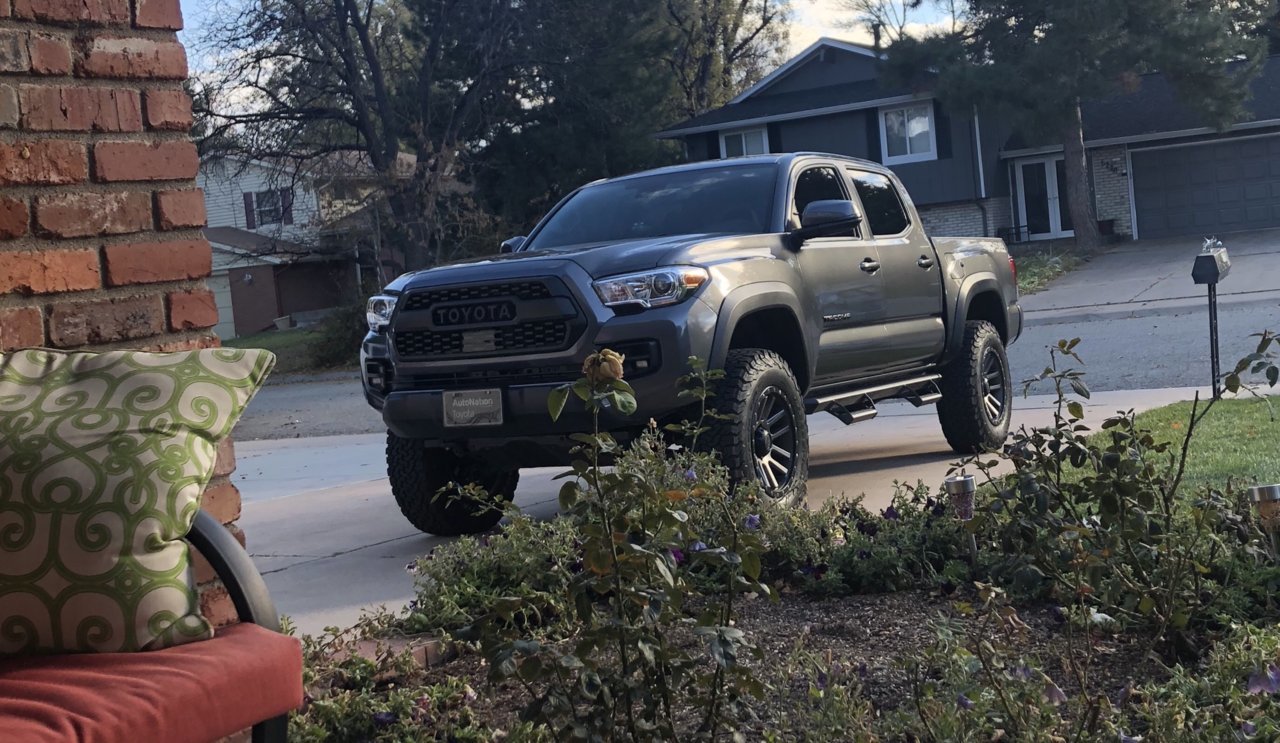

    3 inch low range off road lift / level kit 255 85 16s20170827_144848.jpg

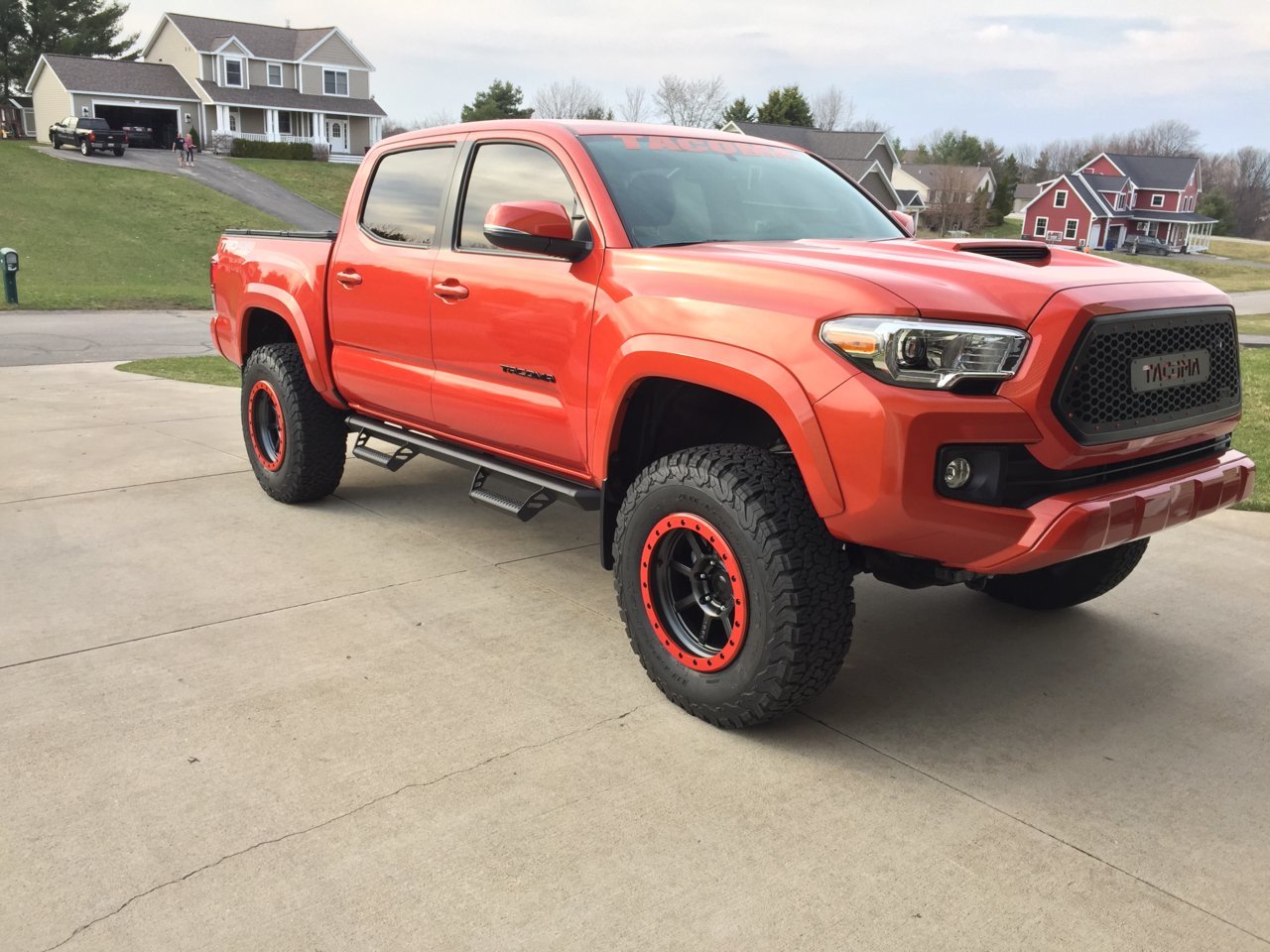

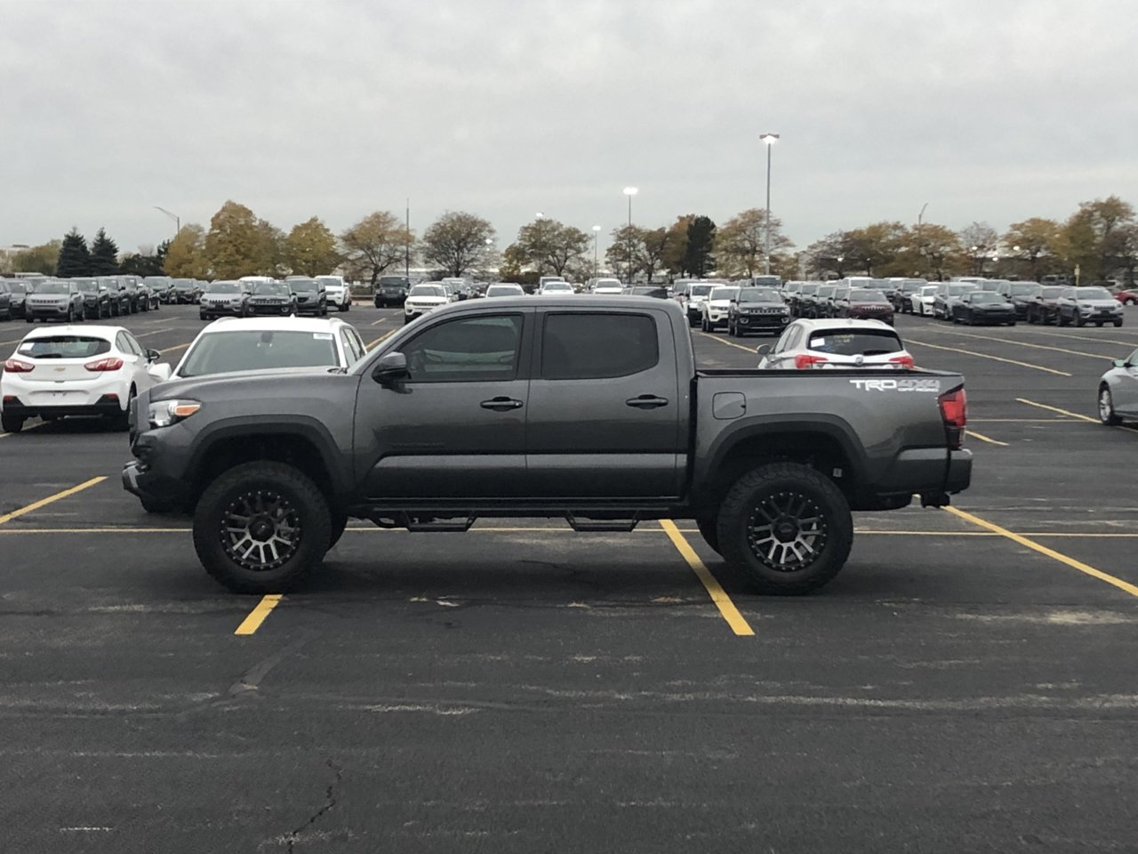

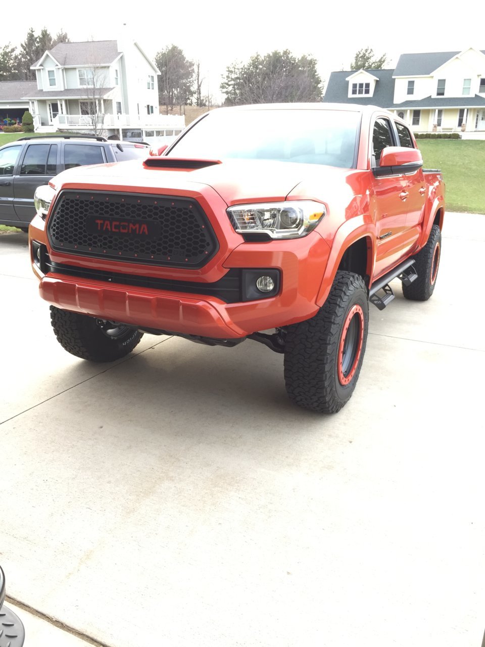

    3” motofab leveling kit. 285/70R17
    FAA519ED-9739-4B88-A309-CF52CC3C50E7.jpg 5563FEB8-7991-4A14-B26E-63E362E300BE.jpg

    Yep all stock, just added a spacer in the front suspension and a block in the back

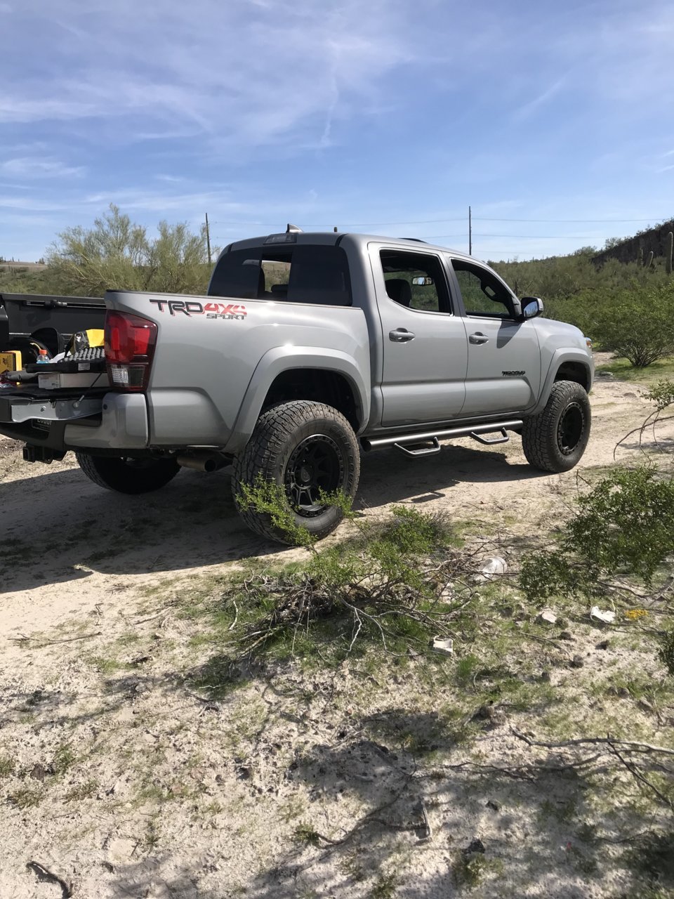

    ReadyLift 3” Front 1” Rear SST Lift Kit 285/70/17 American Racing Wheels with Toyo AT 33”
    Really lift 3/1 SST kit. 285/70/17 no rubbing.

    In my case, the 2.25 Pro comp front has felt pretty much like stock. This was what i was looking for when i took it to 4wheel auto parts and this kit is what the tech recomended. So far with nearly 3000 miles I've been happy.
