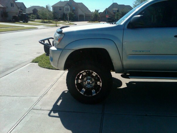

    Nope i didnt cut anything....they fit perfect but they rub on the mud flad but i am thinking about shaving were they scrub...thanks i worked all summer for them rims and tires...wat kind of rims and tires you want?

    Awsome. everyone is telling me i am gonna have to trim my fenders and cab mounts. and i did not just buy a new truck so i could do that ya know. thanks for the help again. everyone that runs there mouth i just been using y0our pic as a example...

    i had to get a .25 wheel spacer cuz it was rubbing the uca but that was it....make sure you get the right backspacing..call the people were your getting the lift and they will tell you everything...no prob best luck to ya

    you do not need new UCA's...i have pro comp 3 inch and i have 33's on 20's....i dont know anything about the lift your talking about but if u get the pro comp 3 you can run 33's or 20's

    it is a good idea to get new uca's with a 3" lift. It will help get your alignment dialed in post lift. Plus it takes some stress off of your upper ball joints.

    ppl that alignmented mine with no prob....it all up2 you to be honest...pro comp didnt say anything about getting new UCA's

    jswmsw10....the pro comp lift calls for no more that 20x9...i have 20x8.5 but the backspacing is off by .10..procomp says back spacing is gota be no more that 5.00 and mine are 5.10...the only rub on mud flap

    My wheels are 20x9 with 5.0 backspacing so thats perfect right? Sorry not exactly good with backspacing and all that lol. How does the procomp ride btw? That just might be what I will get
