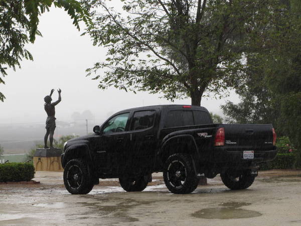

    3 inch with 33s, went to RCD recently so it's a bit taller now.

    Awesome looking set up!!
