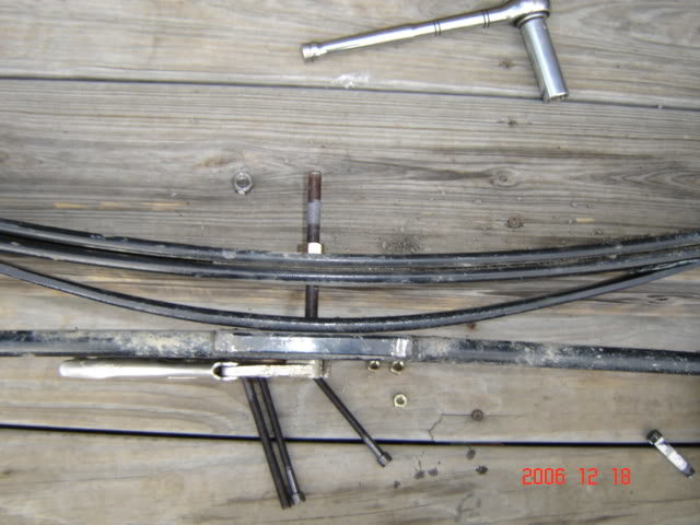

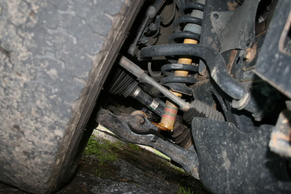

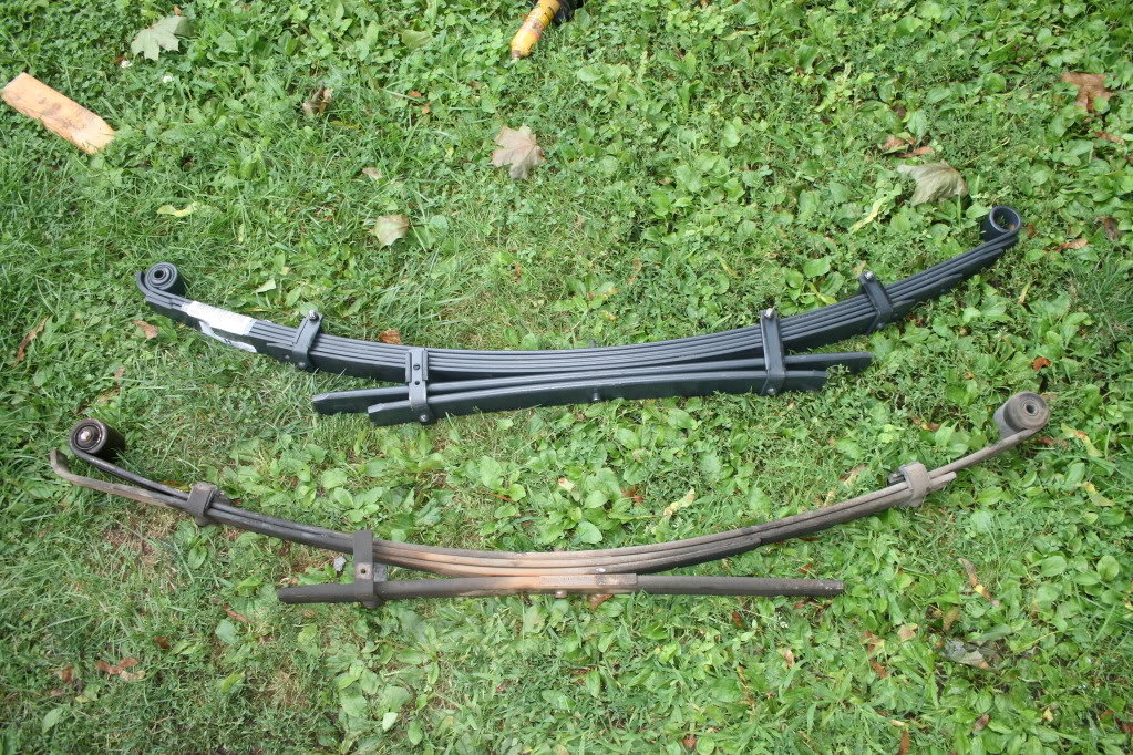

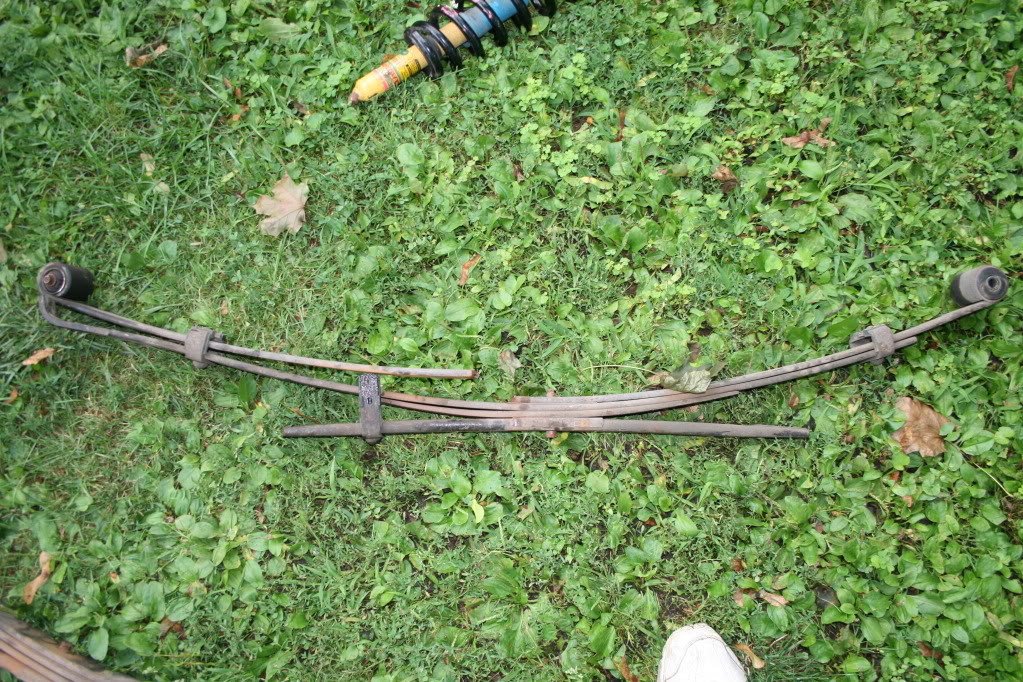

  15. Aug 2, 2011 at 6:53 PM
    #55
    Rich Beauregard
    Rich Beauregard Well-Known Member
    Sep 2, 2009
    #22179
    623
    Rich
    New London, CT
    17 Taco 4x4 SR5 Access Cab White
    CS047R
    Stock leaf with an Add a leaf vs the OME/Dakar leaf pack
    Front OME 886 coilover with OME struts, compared to stock TRD Bilstein
    NOTE: Stock Bilstein strurt broke
    Stock Bilstein shock vs OME shock
    I really enjoy the OME suspension with Dakar leaf springs.
    I added 3 degree toy tec shims to the rear leaf springs to help angle the pumpkin more in line with the driveshaft.
  16. Aug 2, 2011 at 7:25 PM
    #56
    thebigk
    thebigk 6 Double 5 3 2 1
    Aug 25, 2008
    #8770
    3,321
    Ken....
    Odessa, TX
    I went with OME 885's, OME shocks, and Toytec AAL. Put it on myself....probably won't do that again LOL. Happy with lift though.

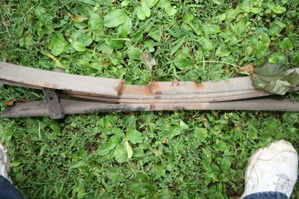

  17. Aug 2, 2011 at 9:01 PM
    #57
    Rich Beauregard
    Sep 2, 2009
    #22179
    623
    Rich
    New London, CT
    I originally did the Add a leafs,Rearadd-a-leaf003_bee3d6718b32a0fd351aac49799dd872b96db16f.jpg
    but that was only for about 1 year till the passenger side leaf spring broke.
    This is when I went to the OME/Dakar Leaf Springs!

  20. Aug 7, 2011 at 8:48 PM
    #60
    tacomtn
    tacomtn Well-Known Member
    May 31, 2011
    #57551
    1,036
    TRD OR,OME,Deaver AAL
    What caused the OE spring to break? Do you wheel often or was it time and hauling?
