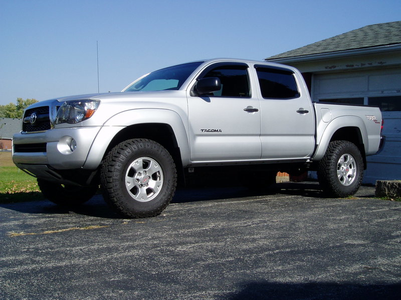

    I already have a set of rough country rear shocks that came with my block kit that are set up for a 2 inch lift, so I figure that I can probably use those until I find a better option

    You can see mine in this pic. Ubolts are flipped upside down, with new plates that sit on top of the springs. Gets the hardware up and out of the way so they don't get hung up on rocks and trail stuff.

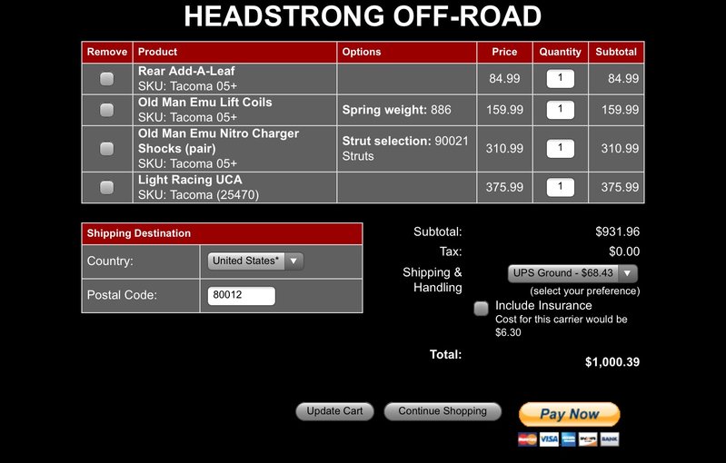

    I also just found this kit. I'm wondering if I should just buy and install this and Say f**k it. Seems like it would be everything that I need for a pretty reasonable price for what you get.image.jpg

    Yes, that kit is a good one. I think headstrong has it for less. There is also a thread for all this info you can post in.

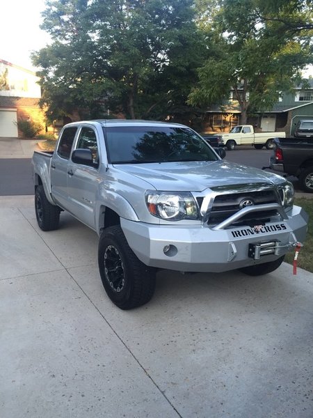

    Nice set up! If you do an OME lift on the front of recommend the 886 coils due to your bumper and winch weight.
    I have Dakars on my rear and rarely carry anything. It looks great and find smooth on roads. Over bumps the rear end is stiff. On rough roads that would be a bit bouncy.
    There are other leaf spring packs that are not as stiff from other companies.
