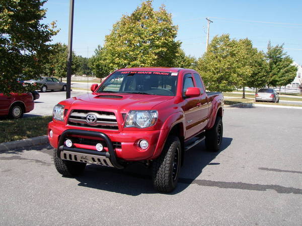

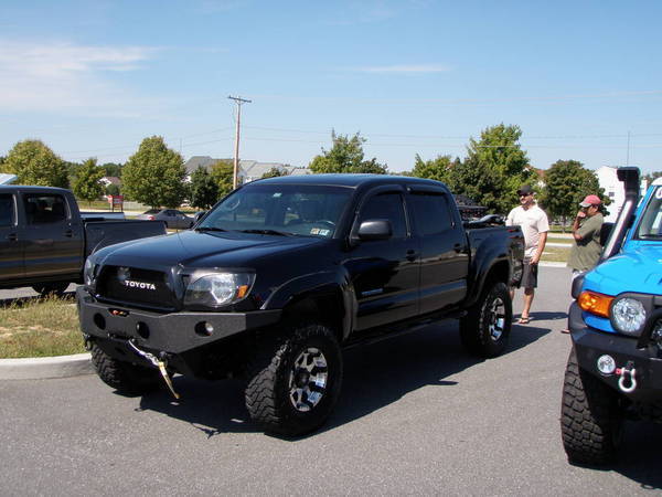

    I am looking for a little bigger tire a wider stance. The truck as it sits, is not proportionate IMO.
    I would like it to sit like this:
    or
