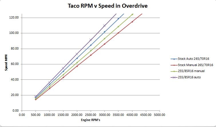

    I've been contemplating running the 255/85R16's and have been trying to decide if 3.73's and the 6 spd would be sufficient. It appears as though with the manual and 33's you'd still be running higher RPMs at freeway speed than an auto with OEM tires. I've created the following (someone, anyone, feel free to check my math).

    Nicely done Lostsheep. If your math is correct that deserves a sticky.

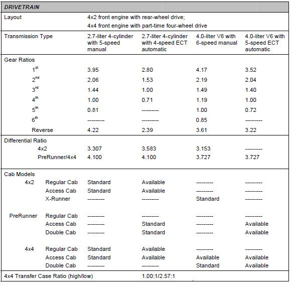

    From Toyota's Website (this is for 2013 models)
