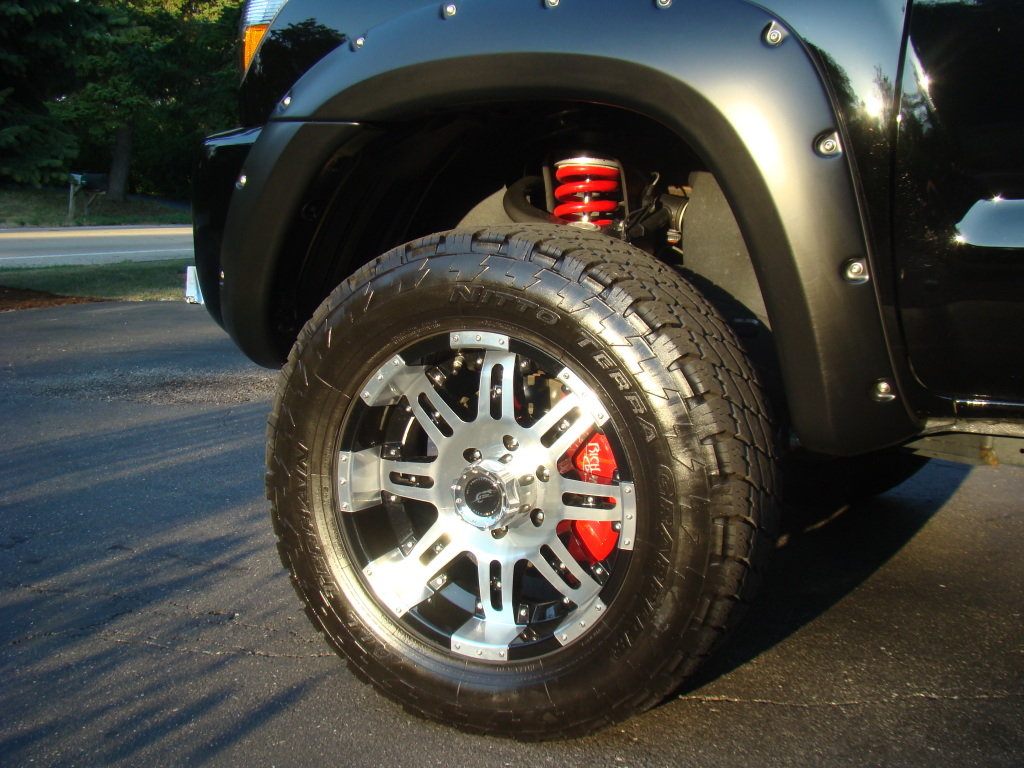

    285/60/18's. toytec ULK@full 3". -12 offset. very little trimming of the plastic in the wheelwell as well as some in front of the bushwackers. no cmc needed. I did have to shed the oem mudflaps but run some custom ones in the winter which do not rub (made of a very thin rubber-like material). trimming is very easy and best determined exactly where after install, but def not difficult. hope this helps.

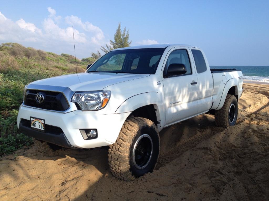

    3" Toytec spacer lift. 285/75R16 BFG KM2s. 16x8 Method Double Standards with 4.5" backspacing. No trimming at all. Removed the mud flaps and trim piece in the front of wheel well.

    Did you need new UCA's ? Truck looks awesome!

    Thanks. No the control arms are stock.
