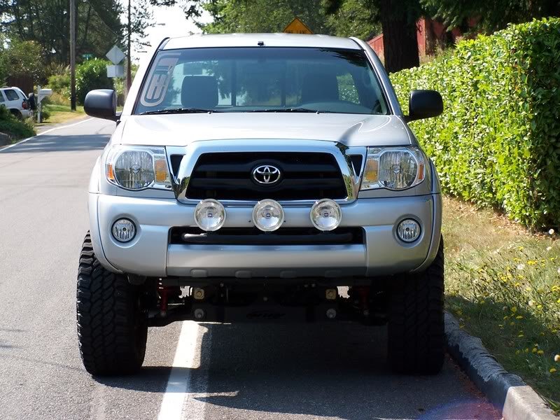

    Look at the cross member in this pic. To me it doesn't look like your gaining any suspension clearance, and what gains you do get come from the tires, not the lift. You're also not gaining any flex.
    They look awesome, yes. But if your more into Off Roading then I prefer the 3". Not to mention your gas mileage will go to shit with 35"s without regrearing.

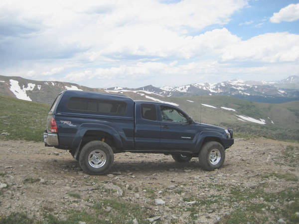

    This is my daily driver. 2 1/2" OME with 33s and the 4.0L V6 has no issues with power on the street, on the freeway, or in the dirt. Plenty of clearance and great stability in the rough. Looks awesome as well (IMHO).
