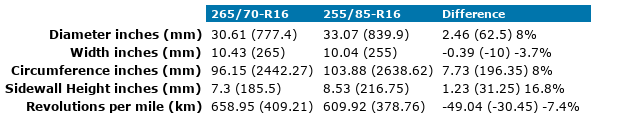

    from the online tire size calculator
    youll probably just have to trim the pinch weld and maybe a little on the front bumper. you should be clear of the UCA but you may rub on the frame at full lock with the stock wheels.
