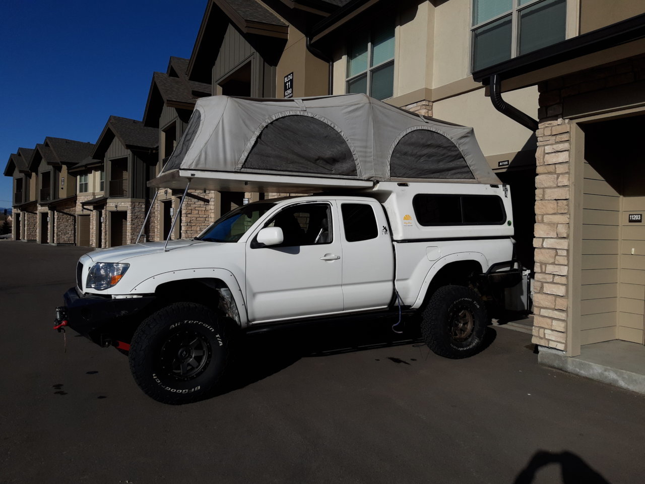

    Parking lot shot 5/2/20:
    I bought this truck in my twenties when it was bone stock in 2014 when I was living outside Philly with the intention of modifying the shit out of it and taking it to places most people can’t get to.
    Prior to owning this truck, I had never been off road or heavily modified a vehicle. The previous fall I had my first off-roading experience on a rented Triumph Tiger 800 that I took over Ophir Pass in Telluride while visiting a friend who moved out to Boulder. Needless to say, the experience solidified my childhood obsession with the Colorado Rockies, and the fantasy of spending my weekends far away from the hustle and bustle of the city. I debated between buying and adventure bike and the Tacoma, but ultimately I decided that I wanted four wheels on the ground and the comfort of heat, A/C, and being able to carry gear for a few days.
    With the help of some advice and encouragement from my long time friend and brother from another mother, @HomerTaco, I found an unadulterated 2009 Toyota Tacoma Access Cab Sport 4.0L V6 4x4. The only thing aftermarket were the bug deflectors and window visors.
    I started out offroading at Rausch Creek, and exploring the old coal mines around Shamokin, PA.
    This truck moved me across the country and has taken me to some amazing places. I have met some awesome people who have taught me a lot and shared some amazing experiences exploring new trails and places.

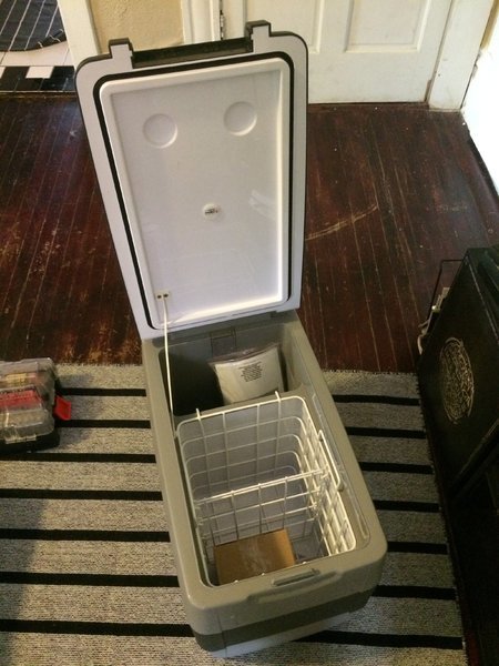

    Indel B 40L truck fridge

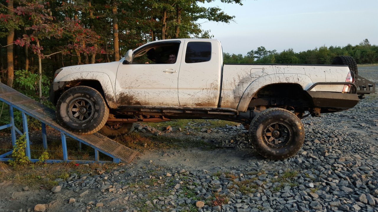

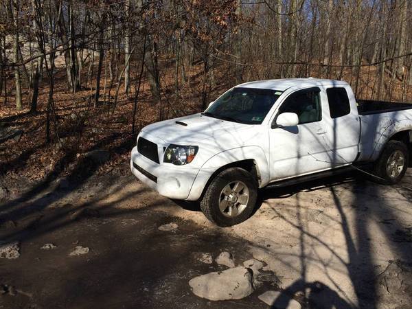

    I headed up to Rausch Creek and left my truck in the parking lot while I rode shotgun with @HomerTaco to see what wheeling was all about. I was pretty much hooked instantly.

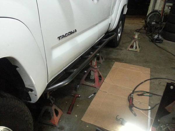

    Modding started with removal of the factory steps ("damage mutipliers" as Craig calls them) and Grillcraft insert installed by the master grill maker himself, @HomerTaco.

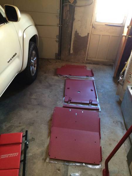

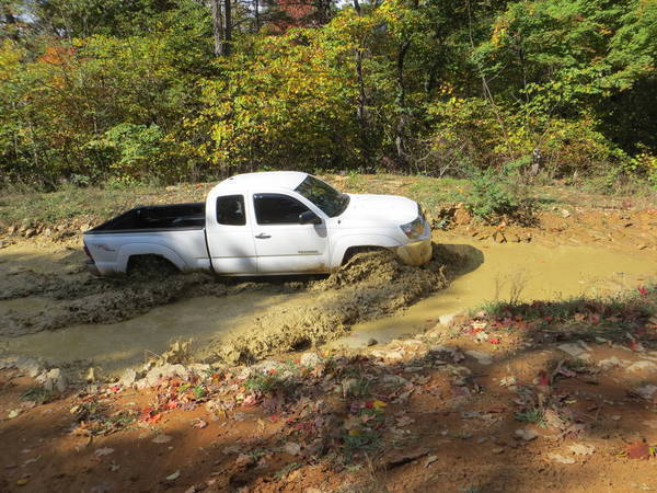

    Last minute preparations for my first wheeling trip at Big Dogs included installing skid plates and having my new sliders welded on and painted. I went with BudBuilt skids for the quality and ease of install, and 4x innovations weld-on sliders for the price.
    My first time off-roading and getting stuck down in Gore, VA at Big Dogs.

    Flexing out at Rausch Creek. One of my last trips before moving to Colorado.

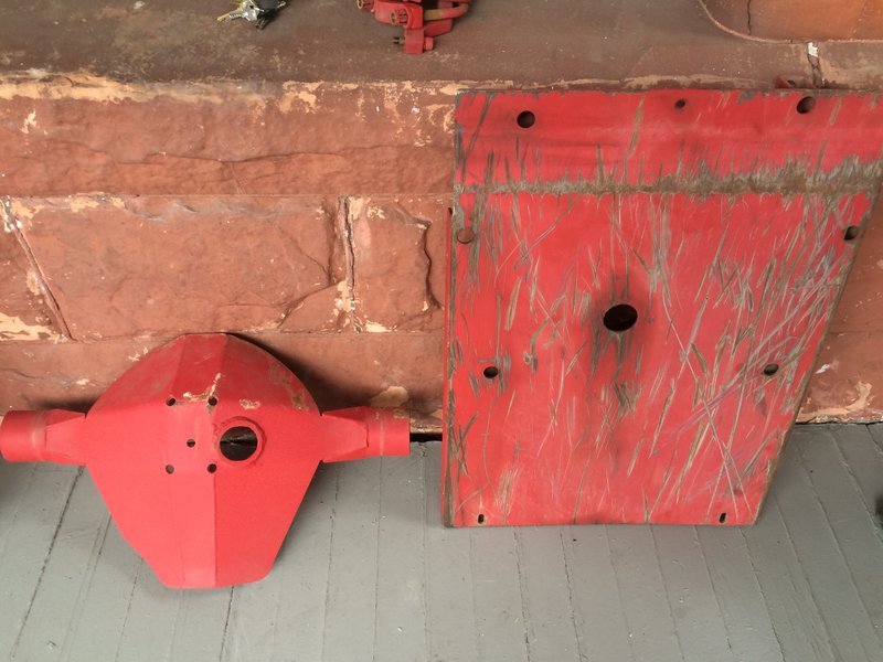

    After waiting months for my Pelfreybuilt diff skid plate that never arrived, I went with a cheaper option, Boztec. Unfortunately, the diff skid didn't quite fit...the hole wasn't drilled in the right location and the collar was welded on slightly crooked. The guy who built it tried to tell me that on some trucks the drain hole was in a slightly different spot and I should ground down the protective ring around the drain bolt. WTF?
    Instead, we modified the part to fit the truck. With a lot of grinding to the drain hole, and the collar, we made it fit.

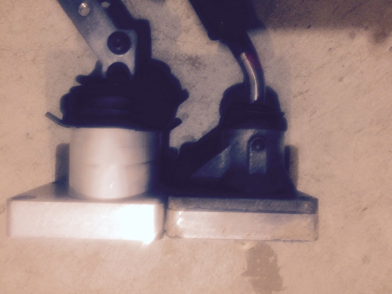

    The URD is basically just a spacer on the factory shifter that effectively moves the fulcrum up on the shifter, giving you less movement up top for the same movement down low. Simple. 44% reduction in throw.
    The Hurst replaces the whole mechanism, with a 30% reduction in throw and a sexy chrome shaft.
    Hurst on the left, OEM with URD spacer on the right.
    Despite the numbers claimed by manufacturers, the hurst feels tighter.

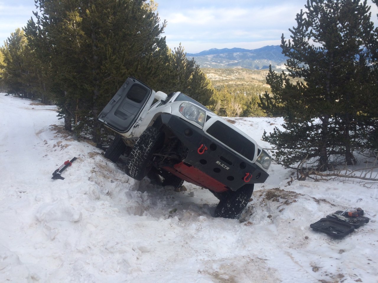

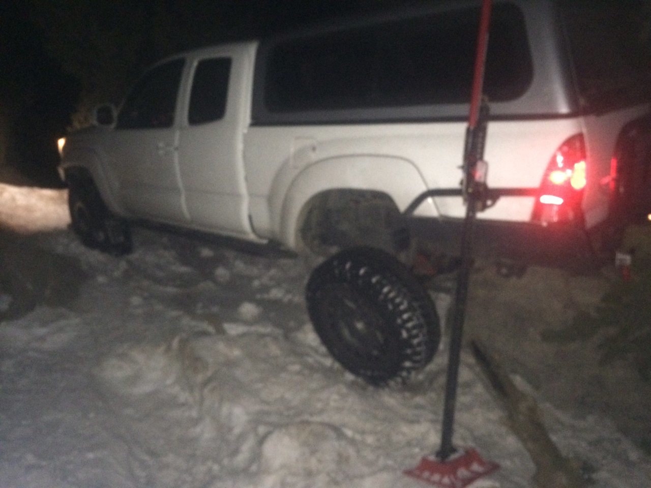

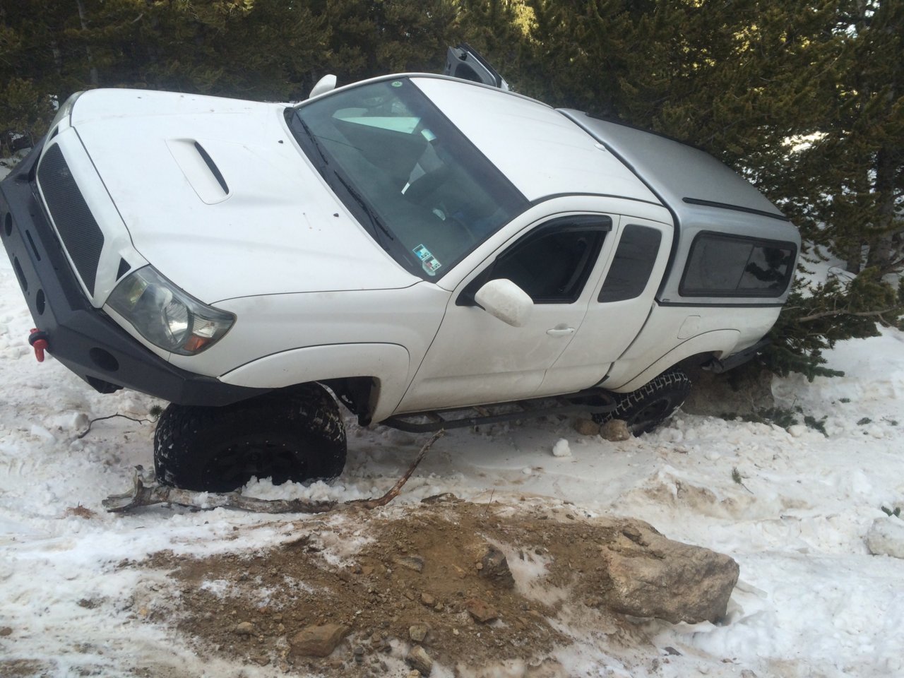

    I got in over my head. Way over my head. Being new to Colorado, I took off on my own into the mountains and got myself stuck in a bad way. I slid off the trail trying to avoid a snow drift and almost rolled my truck. I was afraid to get out the drive side.
    Thankfully I had service on my cell phone, and the wonderful folks of Tacoma World in Colorado saved my ass.
    It was after this experience that I got serious about recovery gear, bought the winch, and installed lockers.

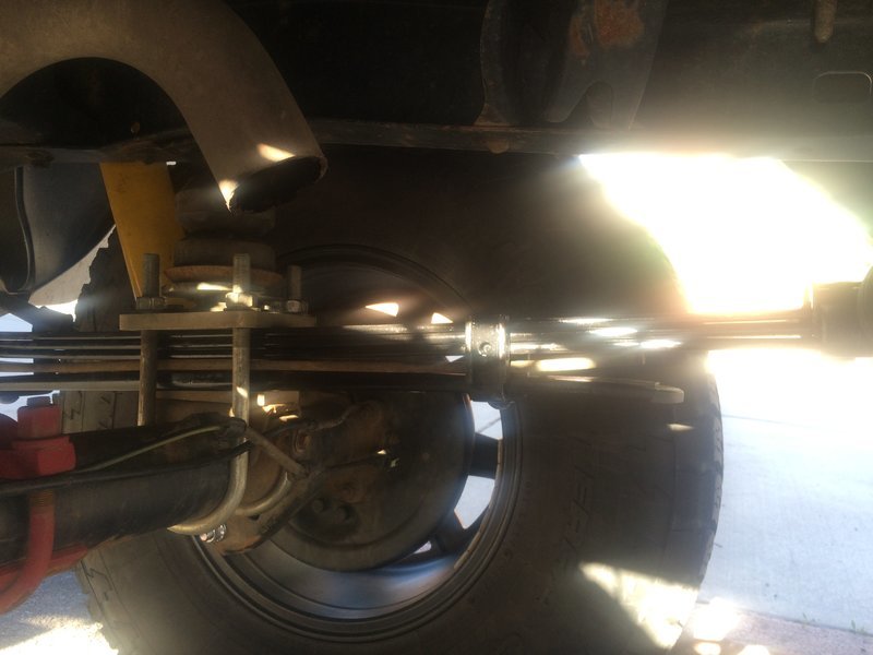

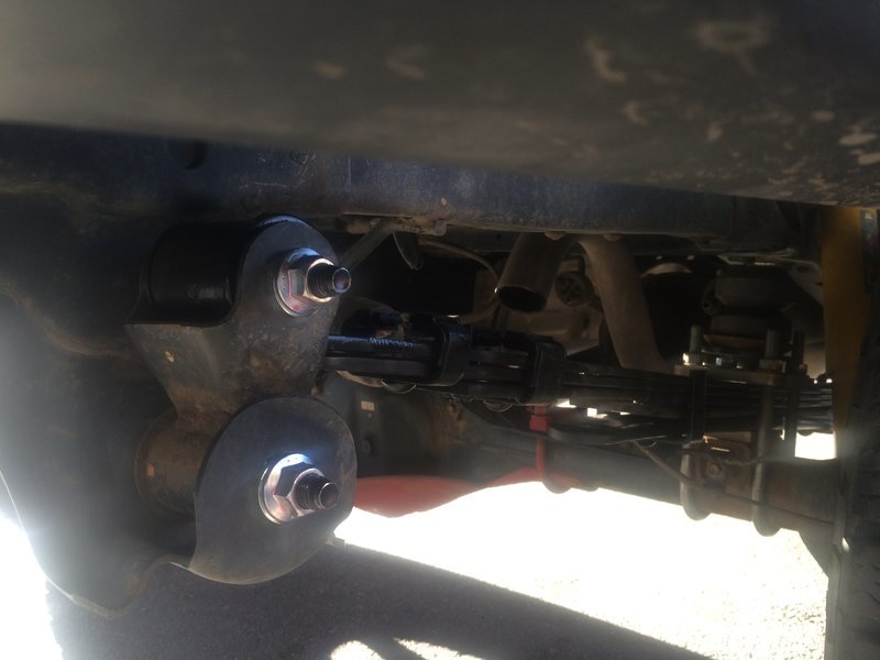

    Leaf spring recall done at Stevinsin Toyota, and had them swap over my AAL.

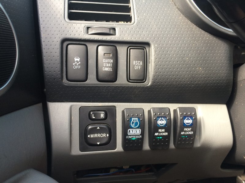

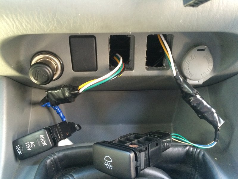

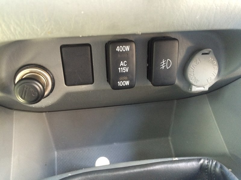

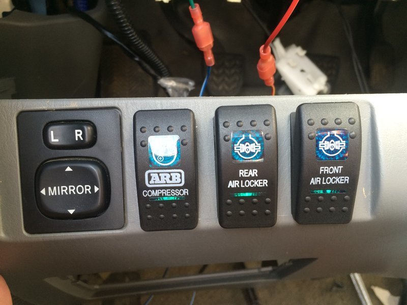

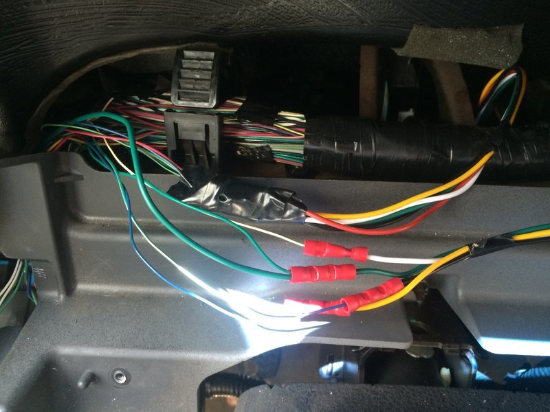

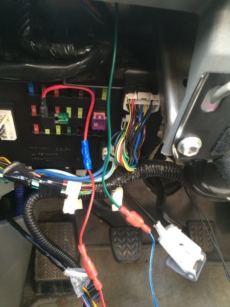

    Relocated converter and fog light switches to center console. Relocated RSCA, traction, and clutch cancel switches to make room for compressor and lockers

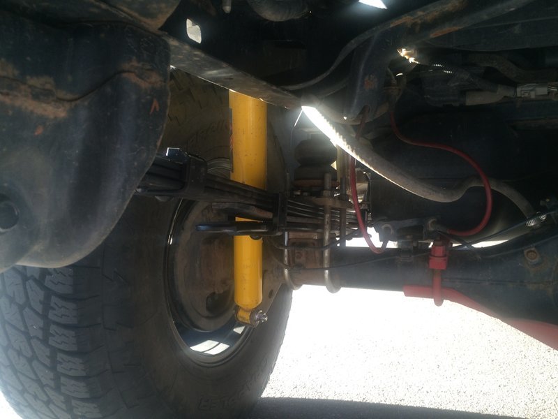

    Bought the fox 2.0s to replace a blown Billstein 5100 but realized they were almost 2" shorter and quickly picked up some of the older N182s from Old Man Emu.

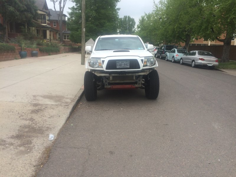

    Money well spent. No regrets. Removed in preparation for ARB lockers and re-gear to 4.56.

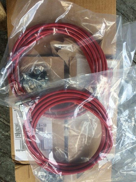

    And my airlines are in from Crown :thumbsup: So glad I decided to upgrade. These are nice...

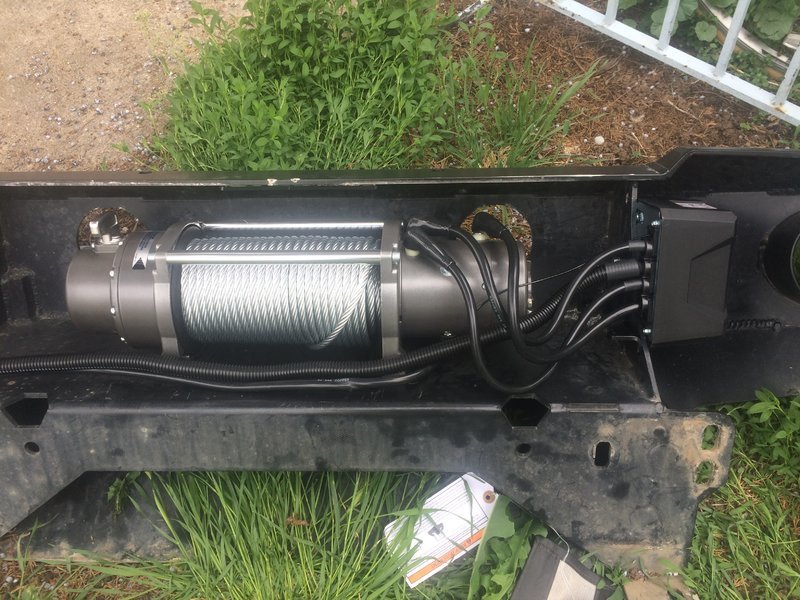

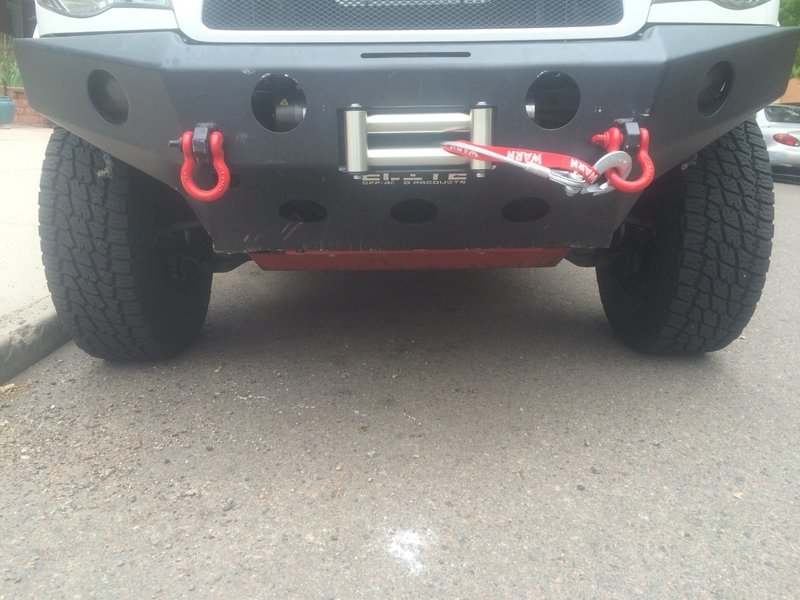

    Thanks to advice from @3378jakesr5 and @tdubd, I'm going to save a bunch of money by waiting till after Moab to borrow some spare diffs and swap out gears / lockers myself (and hopefully a little guidance :D) instead of paying a shop.
    Since I've already mentally spent the money and justified the cost of the install by selling my Lancer back in Philly, I decided to invest some of the money I would have spent on capability into recovery. I'm done F'ing with a hi-lift / come-along as a winch after my seperate experiences on Yankee hill with @aero3685, @Reh5108, and @ashrr213. That shit sucked.
    I've read nothing but good things about the M8000 as being a reliable entry level winch for the Tacoma, and with the aluminum bumper I should have no issue getting away with the weight of the steel cable on my stock coils for a little while. @80lbs, the winch ways more than the bumper and I doubt the two are over 150lbs together.
    Can't wait to use it.
    Had to pull the whole bumper and drill 1 extra hole to mount the control pack. It all fits nicely back there, and won't be too exposed. Happy with the purchase and looking forward to being the guy who has the winch, instead of the guy who needs one :thumbsup:

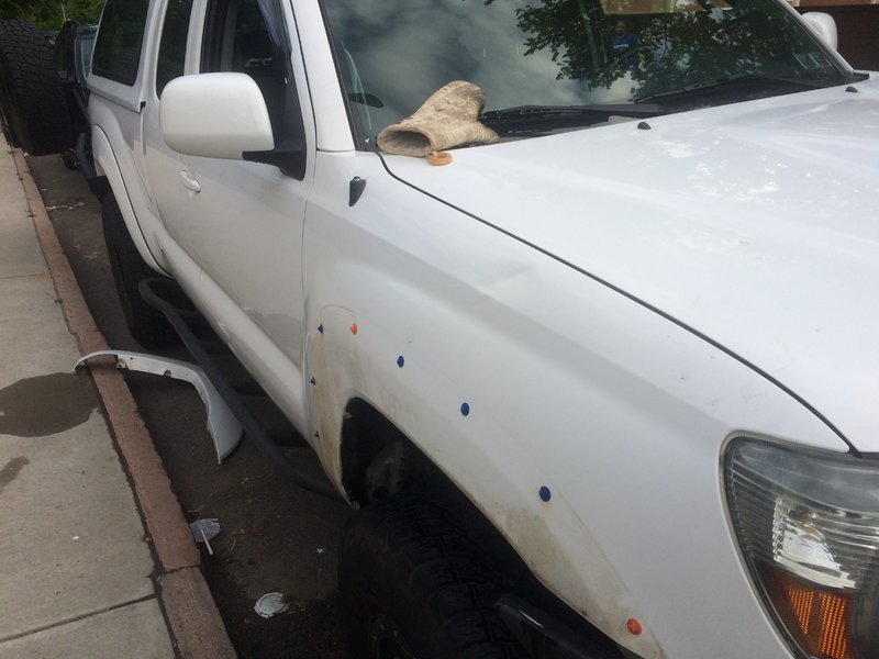

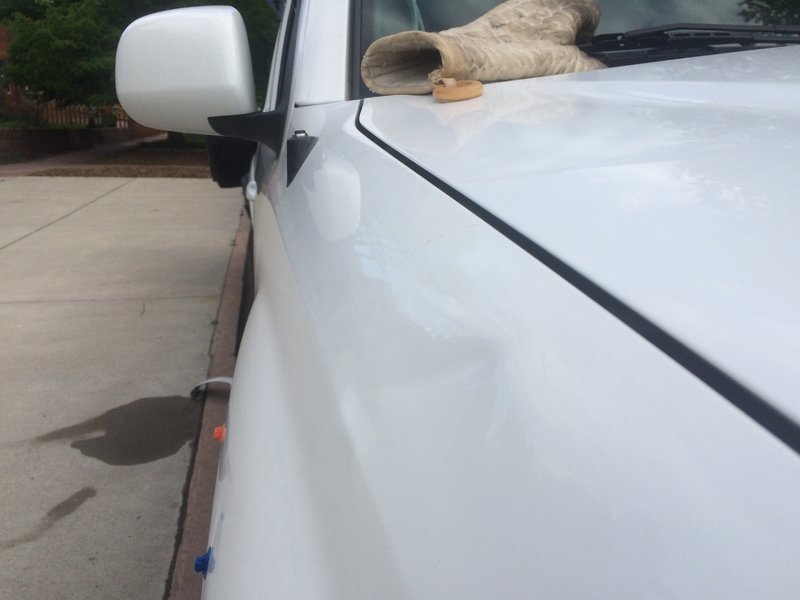

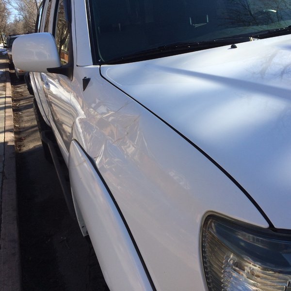

    Gave the fender some much needed love after my last trip to Yankee hill.
    I didn't think I'd get it to pop out as well as I did. :thumbsup:

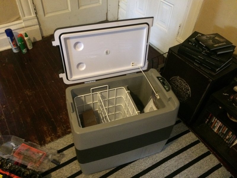

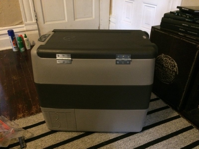

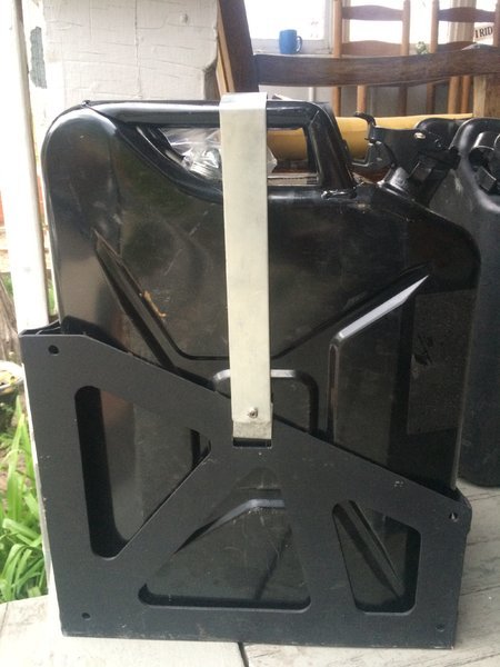

    Just in time for Moab.
    Started modding before I even plugged it in :anonymous:

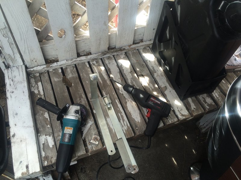

    Not as glamorous as @aero3685's hinges, it'll do. Still need to decide on a latch.
    I also did my hinges opposite him...this is going behind the passenger seat, so I wanted the lid to open against the back of the cab, with the controls and wires facing me and the center console.
    Nice heavy duty base pops right on and off with a three ball shaped studs. +$35 option

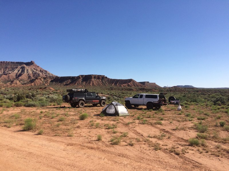

    Pre-rock therapy with @HomerTaco.
    Left Monday @ 8ish. Hauled ass across Colorado. Blew past Moab and headed straight for Zion National Park. Camped in the middle of nowhere, Utah.
    Made delicious breakfast of pork roll and eggs, then headed to Zion to ascend Angel's Landing...the most spectacular hike I've done yet. Finished the day at Emerald pools and then camped again further in the middle of nowhere, Utah.
