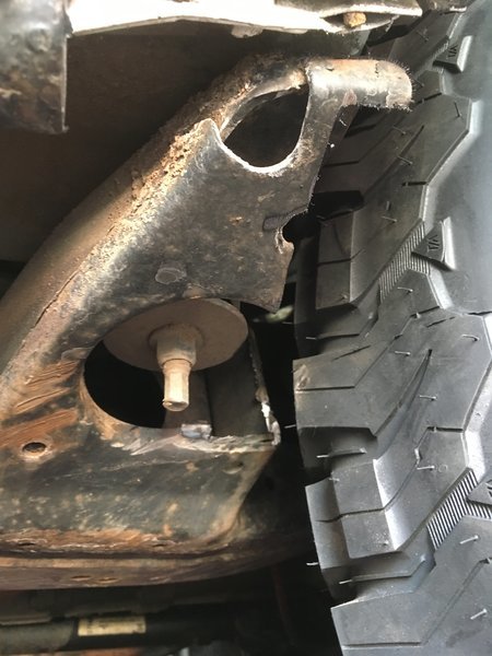

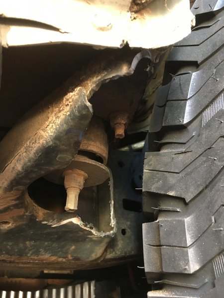

    Starting point, for reference. This is where @HomerTaco cut me down to for the 33s about 2 years ago.
    I'm clearing the factory UCAs w/ no flexing...wasn't expecting that.

  2. Mar 3, 2017 at 10:49 AM
    #182
    HomerTaco
    Mar 28, 2010
    #34129
    45,874
    HomerTaco
    HomerTaco
    HomerTaco
    Kiss half that can mount goodbye.

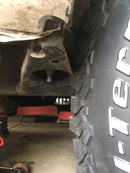

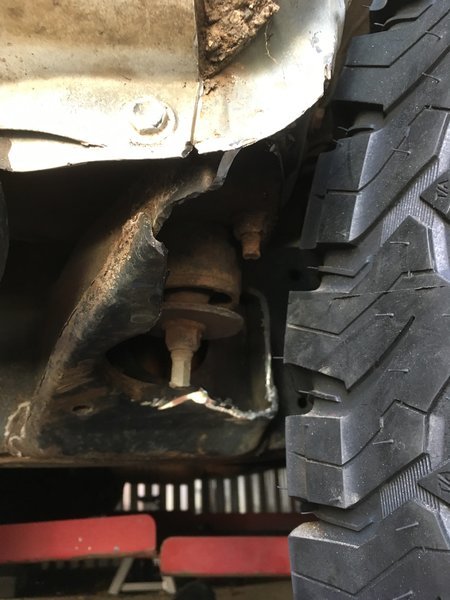

    I think that should do it...
    ChadsPride likes this.
  4. Mar 3, 2017 at 11:35 AM
    #184
    HomerTaco
    Mar 28, 2010
    #34129
    45,874
    HomerTaco
    HomerTaco
    HomerTaco
    Moar!

    Better?

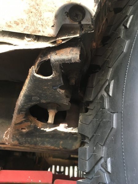

    One fender cut...
    hoverlover, ChadsPride and Stig like this.
  7. Mar 3, 2017 at 1:51 PM
    #187
    HomerTaco
    Mar 28, 2010
    #34129
    45,874
    HomerTaco
    HomerTaco
    HomerTaco
    Looks good. Wish I was able to be there to help. :(

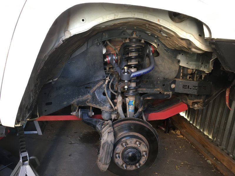

  12. Mar 4, 2017 at 1:07 PM
    #192
    Littles
    Littles [OP] Stupid is as stupid does.
    May 14, 2014
    #129837
    3,397
    Bryan
    Elizabeth, CO
    3 tons of fun

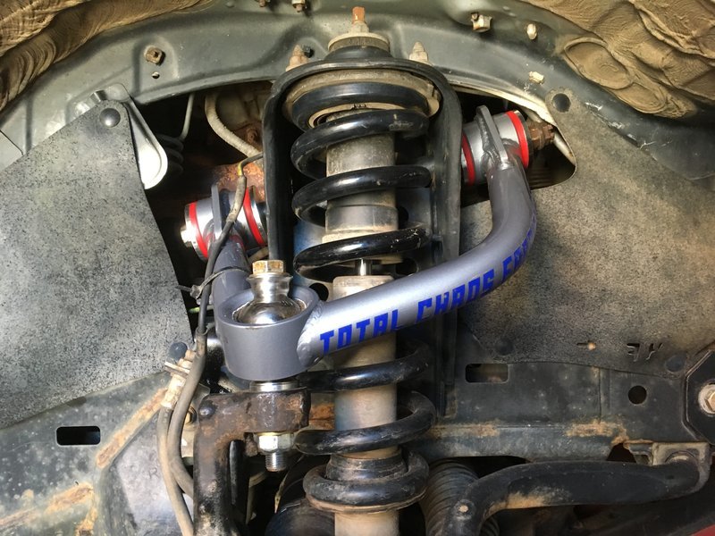

    Uppers in. Those UCA bolts were a bitch. Pretty sure I bent them a little. What asshole decided to put that fender there? I also think my torque wrench is broken... the head never clicked at 85lbs and I was wrenching pretty hard when I heard bolt pop...now it wont tighten or loosen, so I'm thinking I broke some threads on either the bolt or the nut since the shaft still turns. I'll have to order a replacement, but in the meantime, I threw one of the extra castle nuts from the OEM ball joint on the end to lock it and get the torque I need.

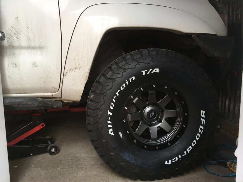

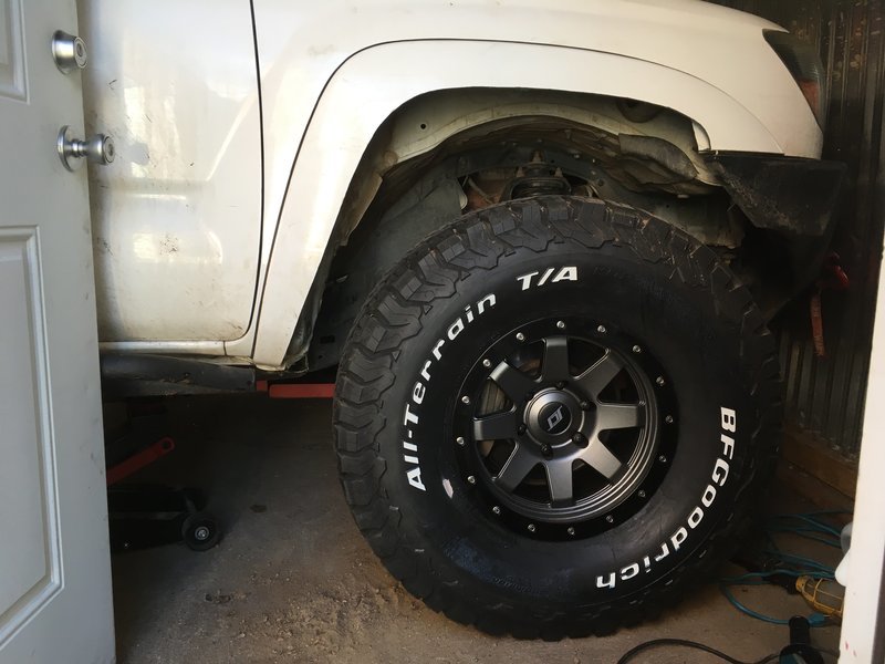

  13. Mar 6, 2017 at 2:05 PM
    #193
    Littles
    May 14, 2014
    #129837
    3,397
    Bryan
    Elizabeth, CO
    3 tons of fun

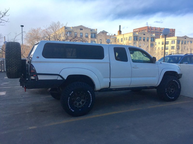

  14. Mar 6, 2017 at 2:06 PM
    #194
    ChadsPride
    Nov 26, 2014
    #143119
    127,312
    Sponsored by TacomaWorld.com
    Love love loooove the white lettering out.
    Looking damn good!!
  15. Mar 6, 2017 at 2:09 PM
    #195
    Littles
    May 14, 2014
    #129837
    3,397
    Bryan
    Elizabeth, CO
    3 tons of fun
    Thanks Chad! I was all about it. I love the look of these tires. Really happy with the way this turned out.

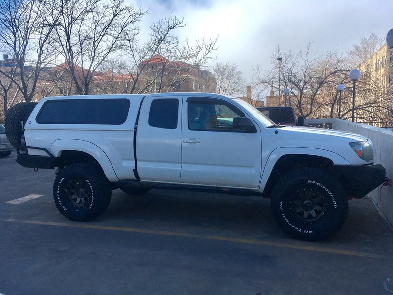

    3 tons of fun
    Dead sexy.
