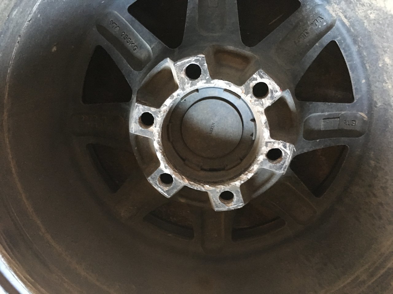

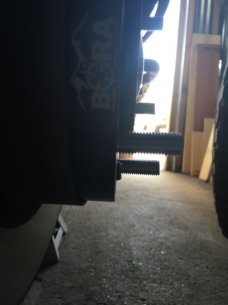

    After all the usual deliberation that goes along with wheel spacers, I just installed a set of .75" BORA wheel spacers (Bulletproof Off-Road Adapters) purchased from @Wheeler's Off-Road Inc to deal with my rubbing on the sway bar, UCA, and frame front and back after going to 35s. I used some stacked up washers to test clearances and determined that I could get by with a 1/4" disc spacer and some extended studs, but after researching I liked the idea of the adapter style just a little better and these were priced reasonably @$90.00 for hub and wheel centric from what I've seen.
    @SCSPerformance gets another +1 from me on these SR8 wheels. I hadn't contemplated running spacers with these wheels when I bought them for my 33s a few years ago, but as a bonus feature, the hub mounting surface is cut such that it doesn't require cutting the factory studs to accommodate a thin adapter style spacer like this where the studs protrude through the spacer. I don't think this is listed as a feature, but it should be.
    Very happy with the end result so far. No more rubbing on the ground pulling into / out of the garage, and close to 1/2" clearance all around. It definitely changes the way the truck feels on the road...seems like it wants to wander a little more.
