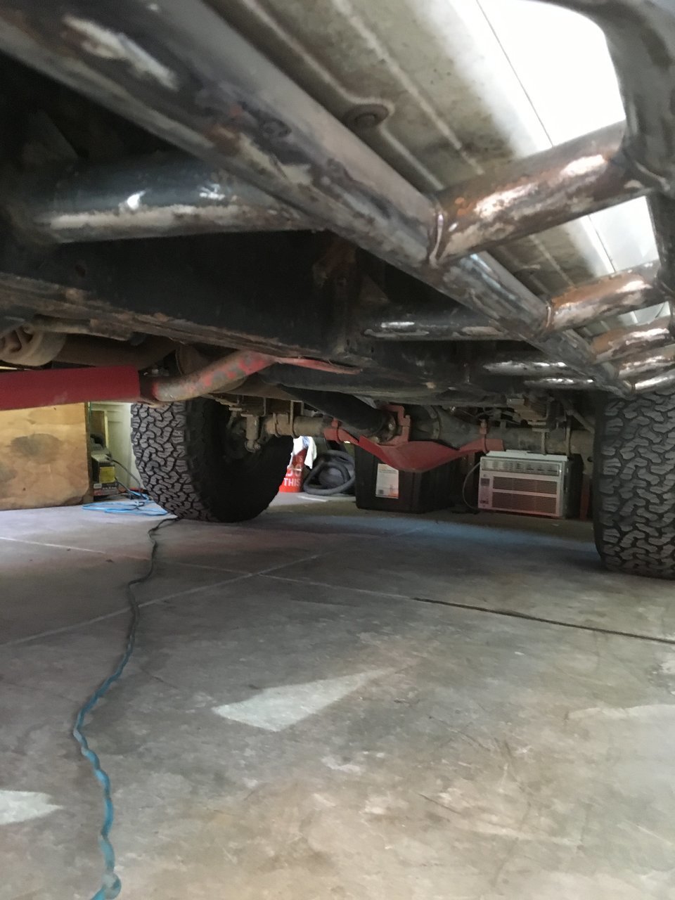

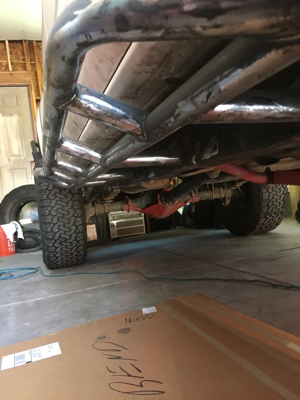

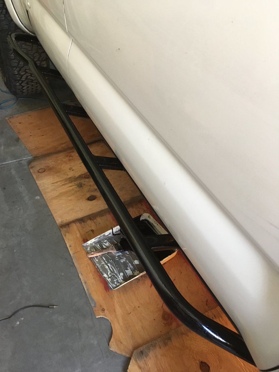

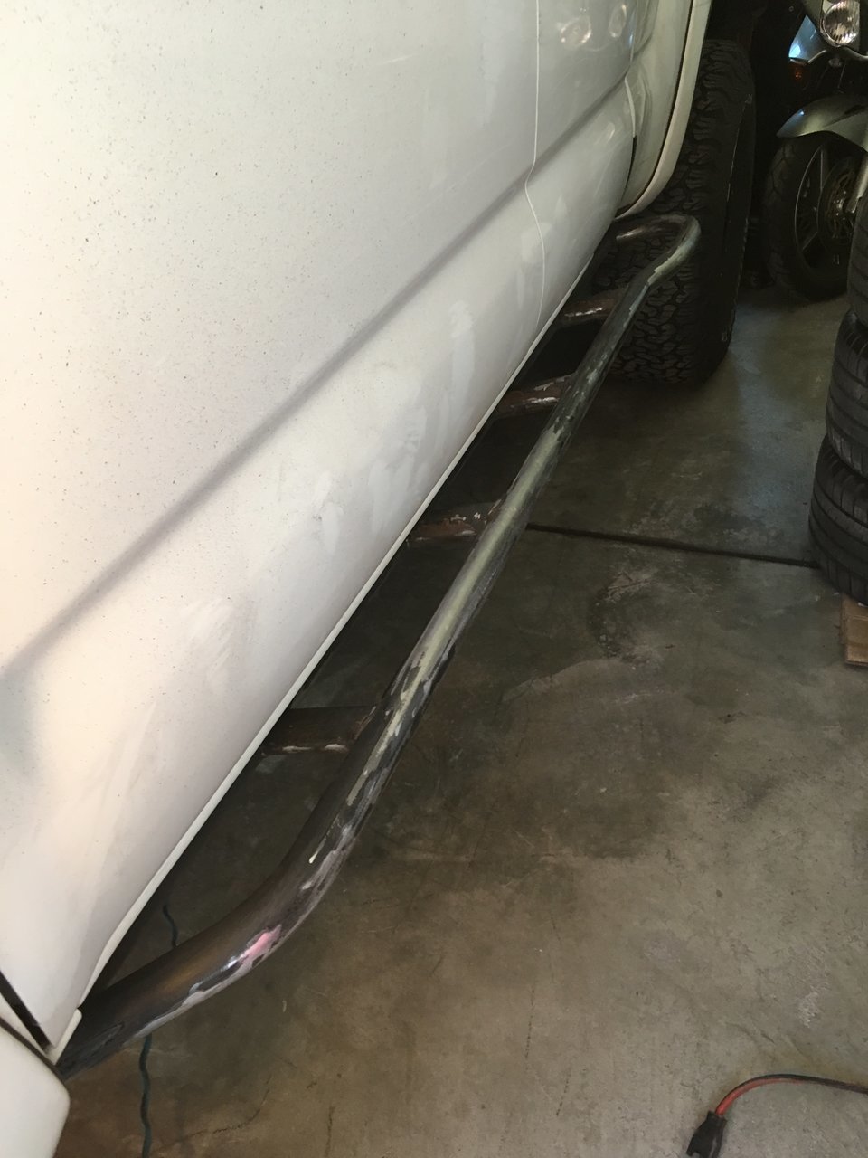

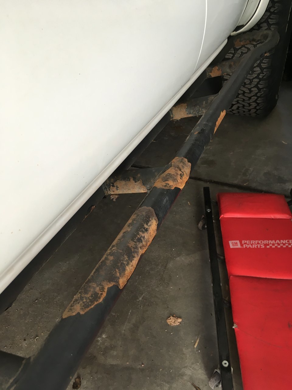

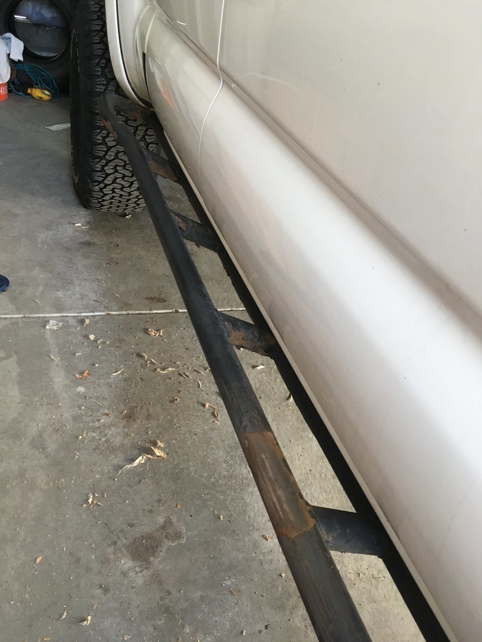

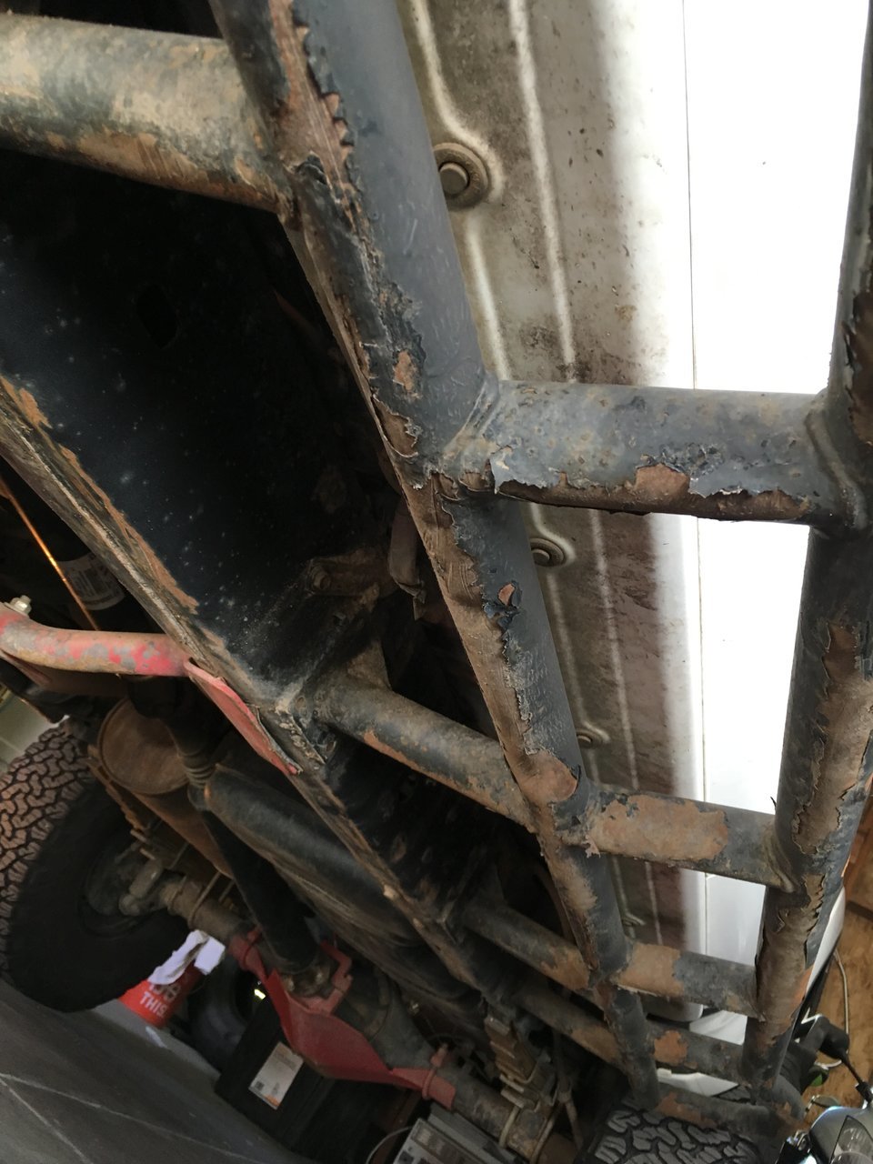

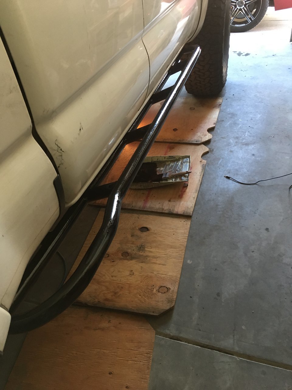

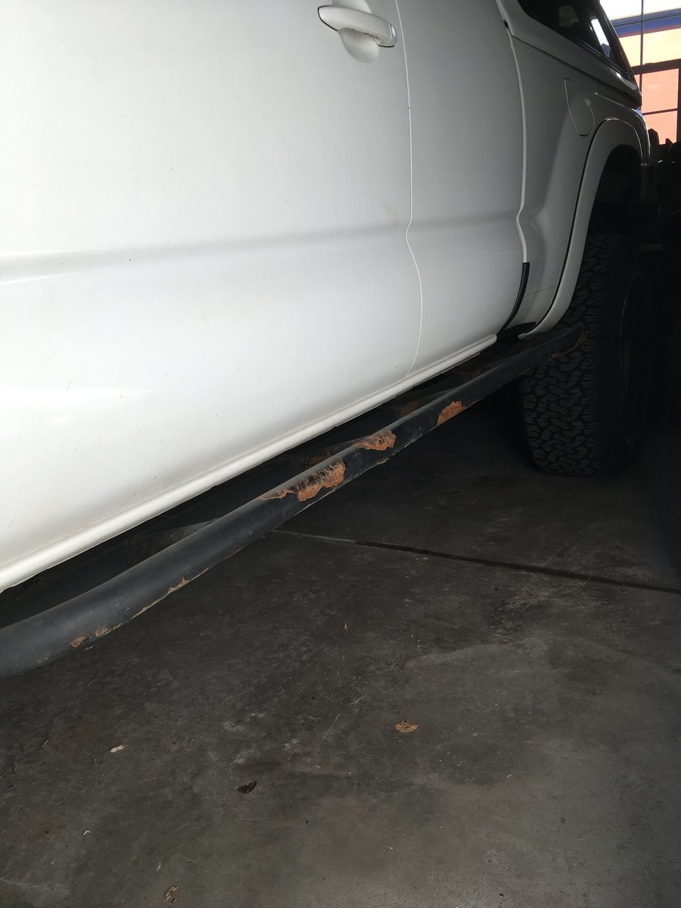

    Spent some quality time with the truck and re-painted the sliders today. This didn’t suck any less than I remember it sucking the first time. Speaking of which, I while I was laying under there I started to remember staying up till 2am to get one last coating of Rustoleum over the POR15 the night before my first ever wheeling trip down in Gore, Virginia at Big Dogs.
    Looking at all the dents, I realized I haven’t used them as much recently as I did those first few years. Between the 35s and a lift and staying off trail 13 at Rausch Creek, they just haven’t been needed as much. Probably one of the best mods I did and sure glad I did it first.
    They were in pretty rough shape. I had to grind away a lot of oxidation that worked it’s way under the coating. Considering how bad I abused these my first year or too, I shouldnt be too surprised. They have been peeling for awhile and I knew I’d have to do this eventually.
    I spent about 60-90 minutes on each side with the flap wheel to get the major rust off and any flaking paint. I know I should have done more, but some spots were tough to hit and honestly I was just ready to be done after having metal and black paint flung in my face for 3 hours. I’ll do a better job removing the rust next time around.

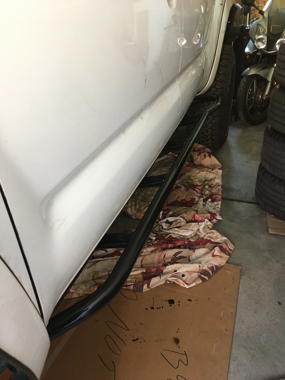

    I didn’t do an etching primer so we’ll see how this goes. I gave zero fucks and just painted over the rust I couldn’t sand. By the way, I hate POR15. I don’t know why this is the hardest paint can I’ve ever had to open both times I did it, but I fucked up the lid so bad I can’t re-seal it AGAIN. So I use it or loose it on another expensive ass quart of paint. The shit stains your skin and gets everywhere no matter how careful you are.
    So there’s one coat...i’ll Probably do at least one or two more. I hit the frame with the flap wheel and some leftover POR15 in a few spots while I was under there. Now it’s time to wait for the paint to dry at the closest brewery in walking distance to my garage, Prost Breweing. Solid German style brews.

    Nice work. Mine are at Chucks right now getting sandblasted & powder coated. :cool:

    I understand why you gave up on prepping yours and let him blast them. The plus on powder coating is that even if you damage it, I don’t think it works it’s way underneath the finish the way oxidation does with paint.

    Exactly. That’s why I did the skids too. Next I’ll get the bumpers redone.

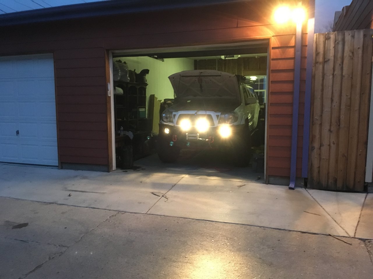

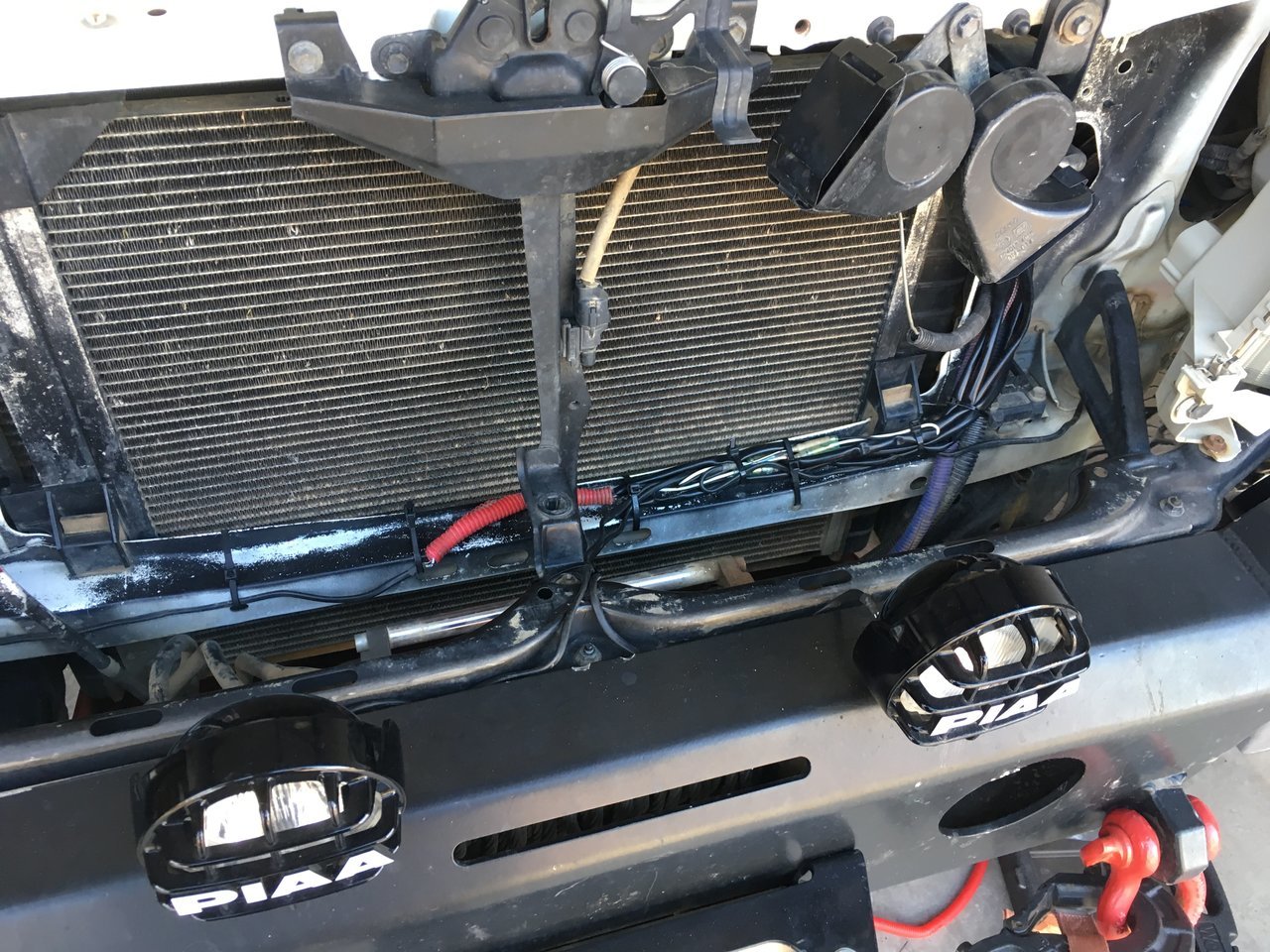

    I threw another coat of POR15 on the sliders today and will do one more before I hit the trails tomorrow, for a total of 4.
    I also ran a new CB cable to replace the one I severed and repaired in Moab last year. Hoping to get a clearer signal now that wires aren’t spliced together all ghetto fabulous. Remember this?
    While I was working on wiring, I figured I’d start tackling my backlog of electric on the aux fuse box by testing my setup and getting my PIAA lights wired up.
    Since I’m using my own relays on rocker switches in the cab, I cut the PIAA provided wires at the relay harness and wired it directly to my fuse panel with a single switch connected to the relay. Much to my dismay, I’m blowing the dedicated fuse I wired up that powers my switches every time I hit flip the rocker to activate the relay.
    After some trouble shooting with a spare relay, I think I have figured out my problem. Let’s go back 18 months ago to the relative start of this mod, when I had this great idea to solder on flyback diodes to prevent premature degradation of my switches and relays.
    I’m pretty sure that I soldered all my flyback diodes on backwards. :anonymous:. See that little gray band on the diode? Yea, it’s on the wrong side, and letting current from from the white wire that triggers switch
    So all that extra time I spent meticulously taking apart the relay harnessss and soldering those little fuckers on to lengthen the life of my switches and relays was in vain because now the shit is all put together and wired up and it’s wrong:annoyed:
    So now I have to decide if I take the time to pull everything apart and re-solder new diodes on the right way, or just say fuck it and cut them off and move forward with the install.

    I’m pretty sure I fried relay #1. After clipping the flyback diode that looked blown apart, and trying again, it stopped tripping the fuse, but didn’t turn on the lights when the rocker switch was flipped. Progress?
    To test my theory, I clipped the flyback diode on relay #2 and wired both lights up to switch #2 and things worked as expected. No blown fuses. Score! I feel better now knowing that I got everything right on wiring from the start except that stupid diode. Once I get that fixed on the other 8 relays, I’ll run the switch wires through the firewall and build my IggyCorp switch panel for the cab.
    hoverlover and HomerTaco like this.
