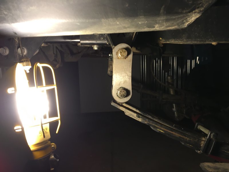

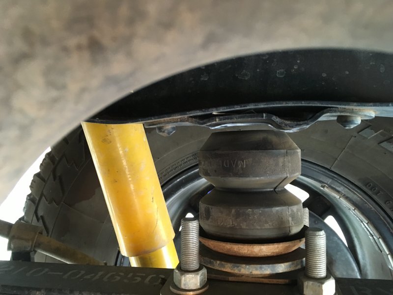

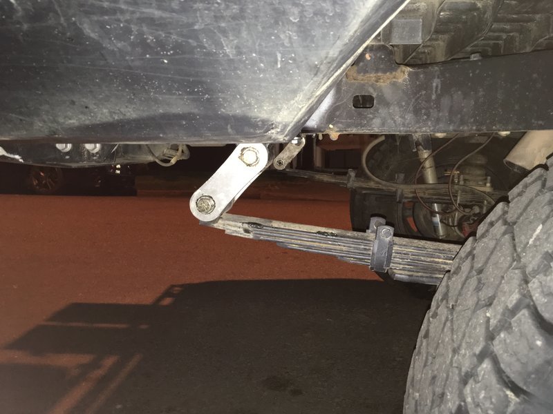

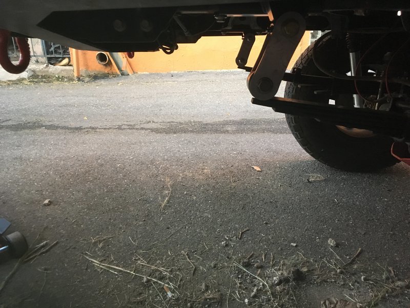

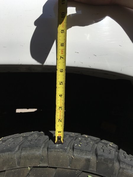

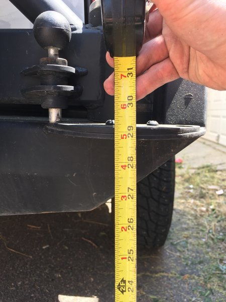

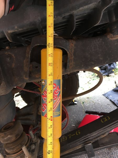

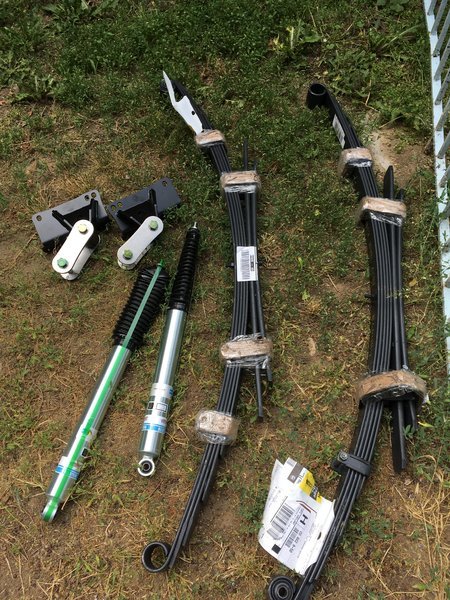

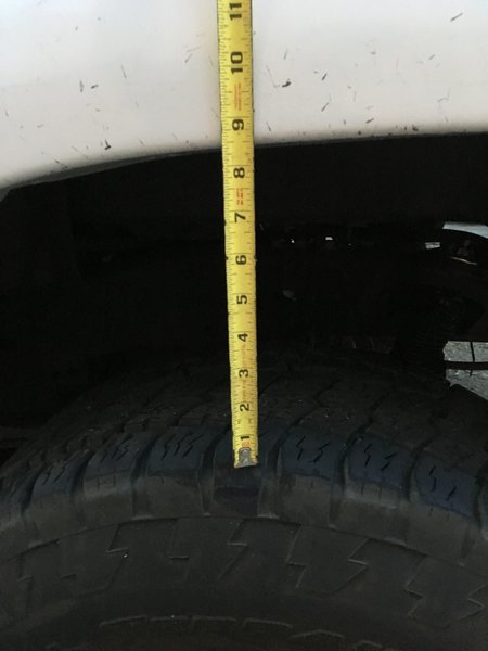

    Dakars and B110s installed. Couldn't wait till the weekend.
    Lots of before and after pics...which I'll caption later. Looks like I'm up about 3.25" before its settled.
    Picked up about 3" of droop before the shackle flip.
    :bananadance::broccoli::dancingbacon:

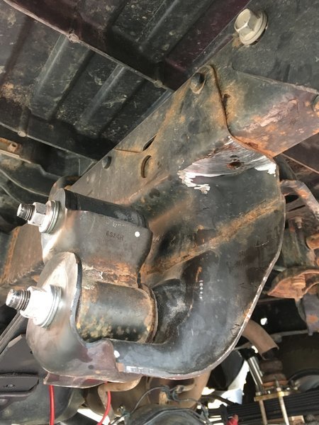

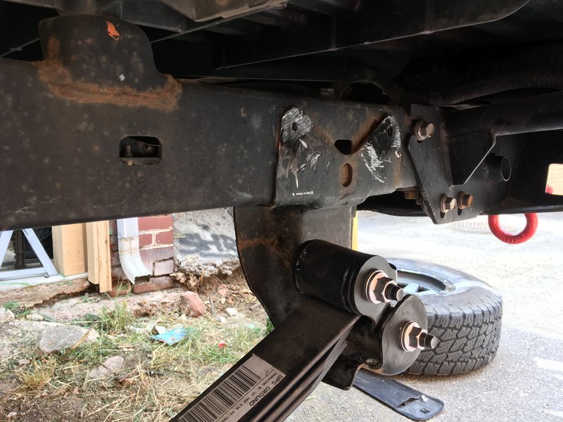

    Here's the angles with the bracket in the foremost position out of the box:
    Here's the final result after some adjustments:
    I wasn't able to get the angles suggested to me without moving the kit forward an inch by drilling my own holes in the frame, and one new one in the bracket.
