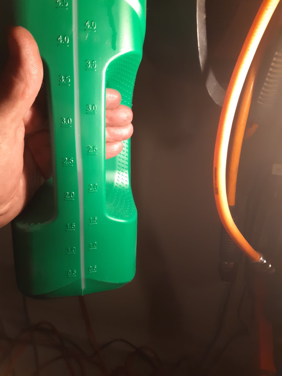

    Wyatt at RST told me 2qt exactly in the marlin or it'll do just that... this was also confirmed by another TW member who got a response from marlin. MT is limited, however, when mated to a AT, the crawlbox requires a lot more oil

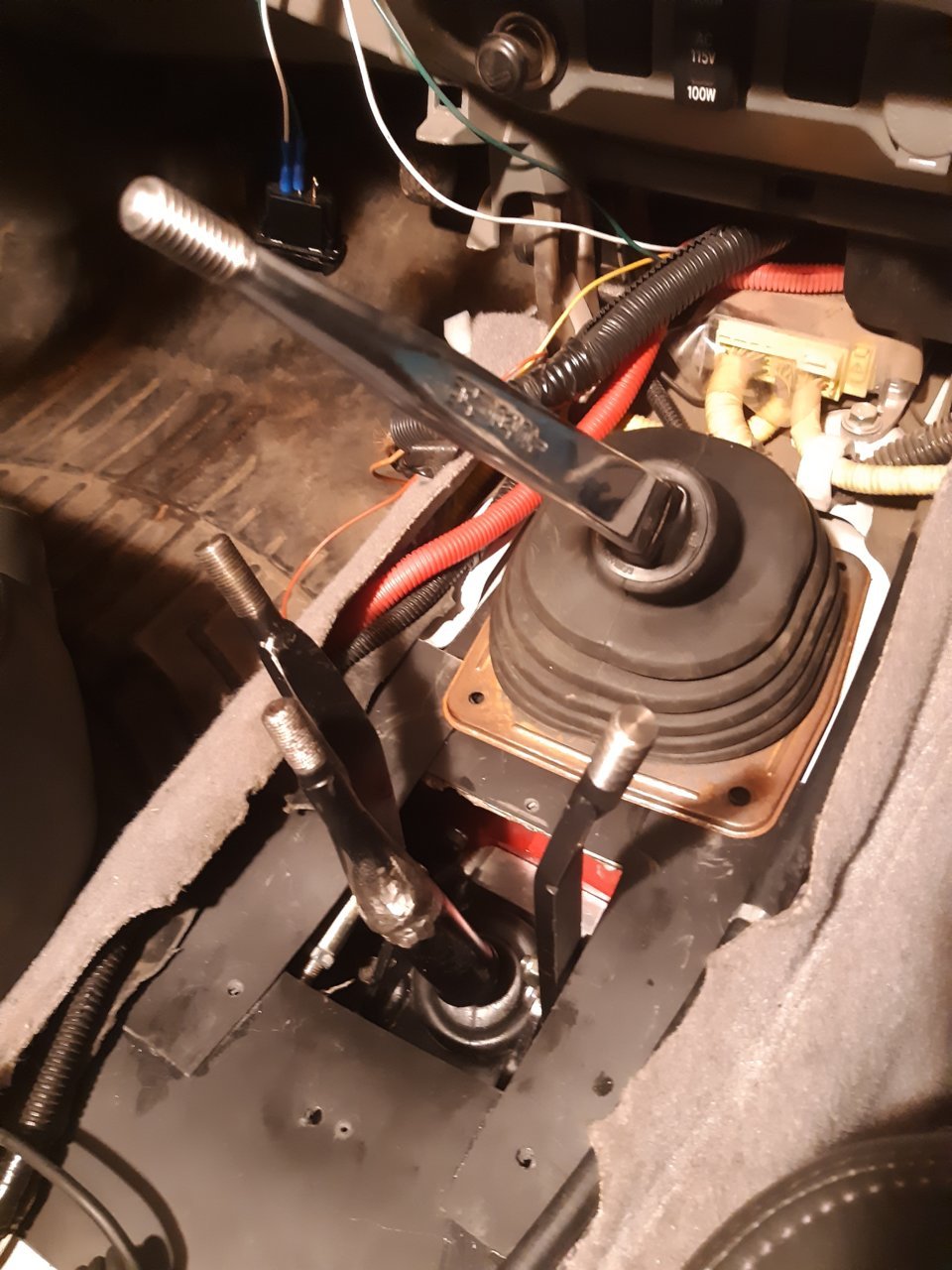

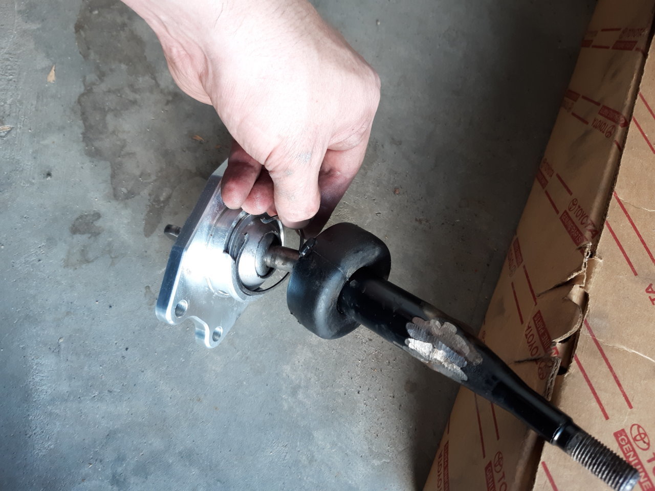

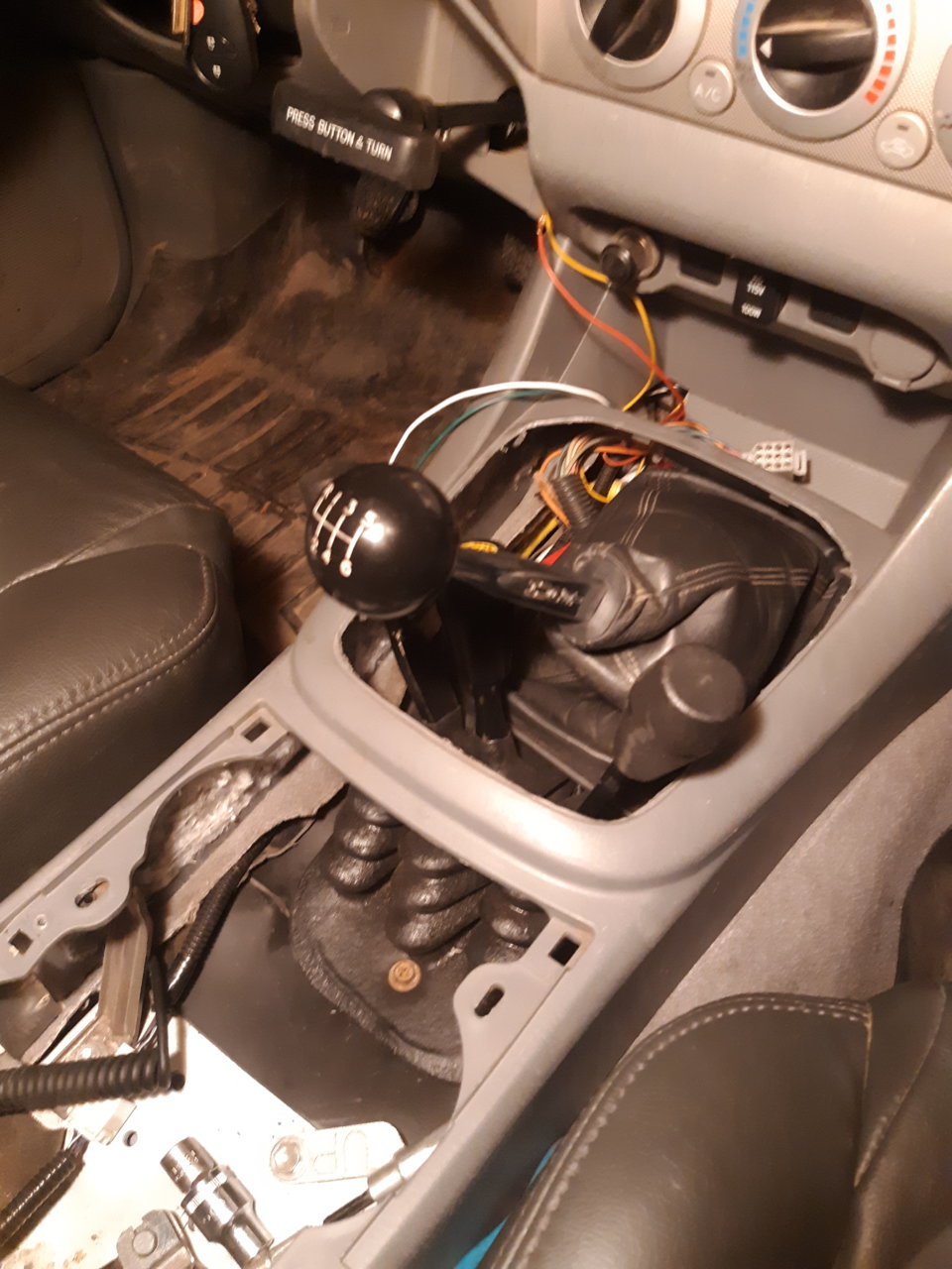

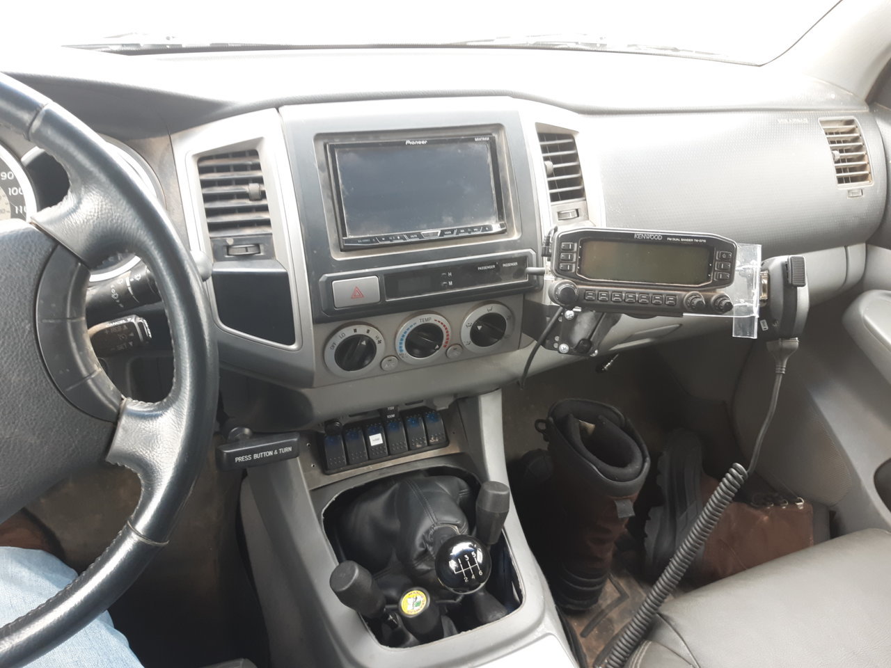

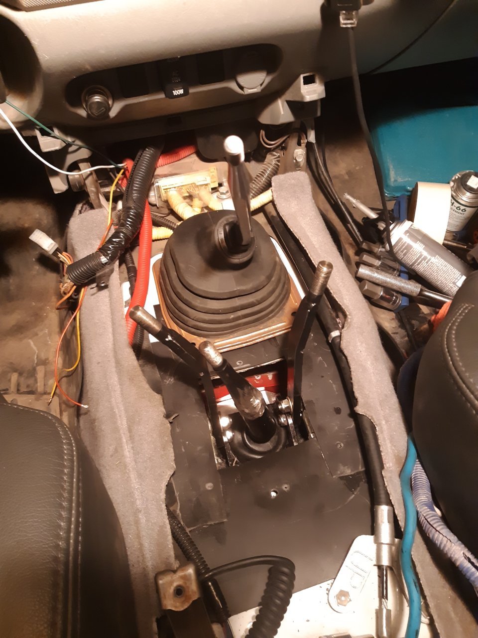

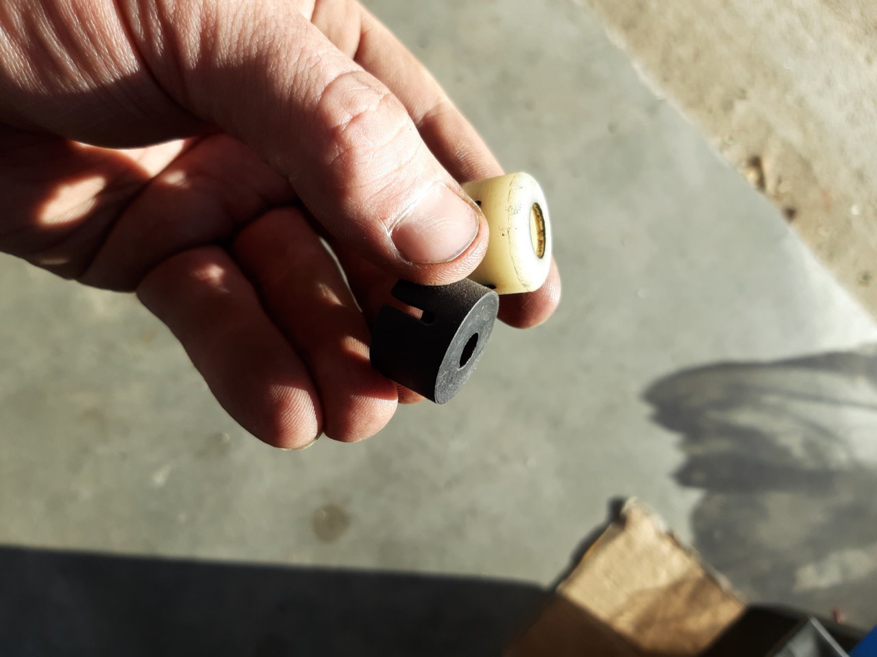

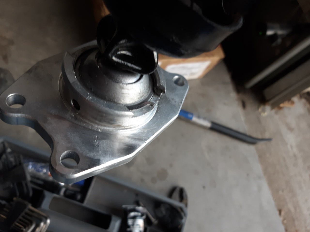

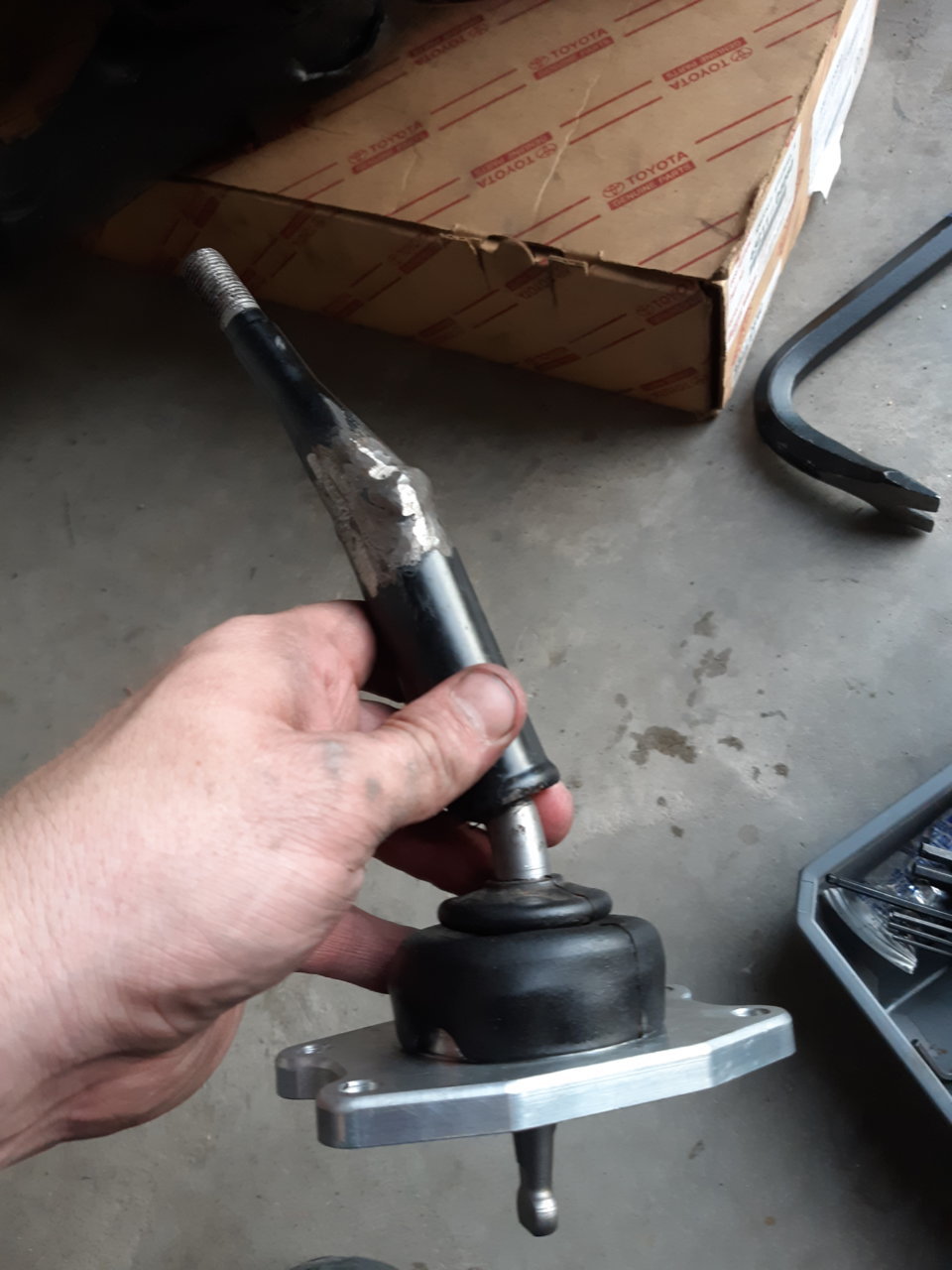

    I had purchased a new bushing for my hurst shifter as well a new shift boot since mine was deteriorating. I installed the shift boot but I never got around to installing the bushing. I had purchased the shifter used, and I've put 20 or 30k on it and it I had a rattle. I'm not sure if the rattle developed over time, or if it was there all along. We'll see if this helps. I also slapped a dab of RTV between the shifter base and the shifter to help avoid rattles there. It was only loosely fitted together when I left for Moab so there was a ton of slop in the shifter the past few weeks and gears have been hard to find. Gave the bolts a few good ugga duggas and its feeling a lot tighter now.

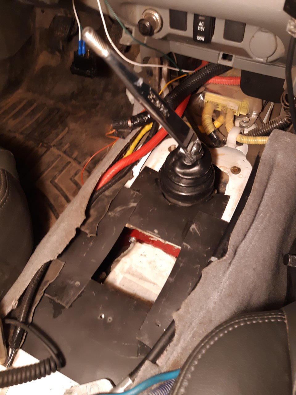

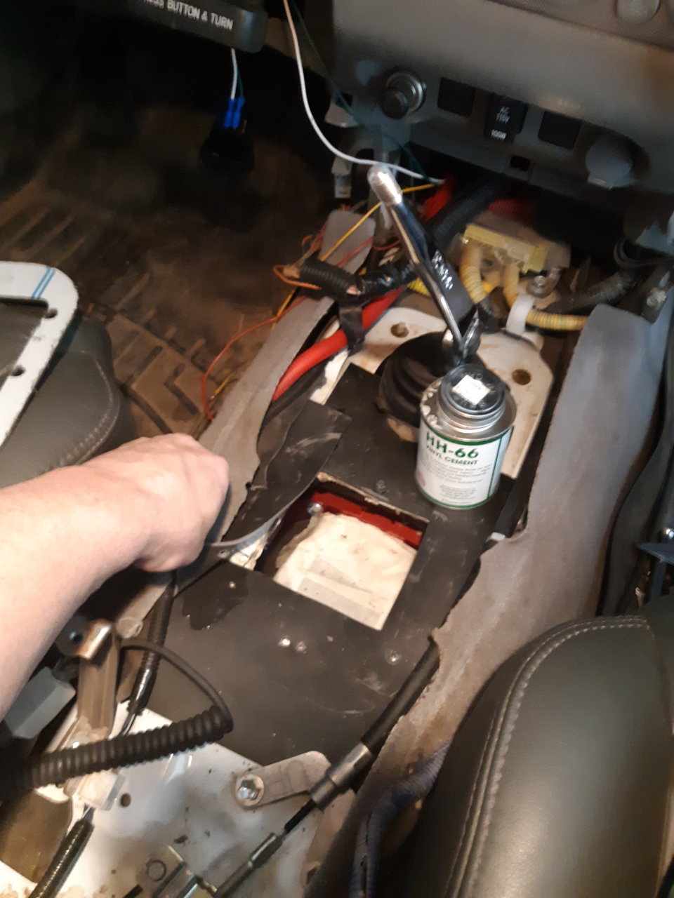

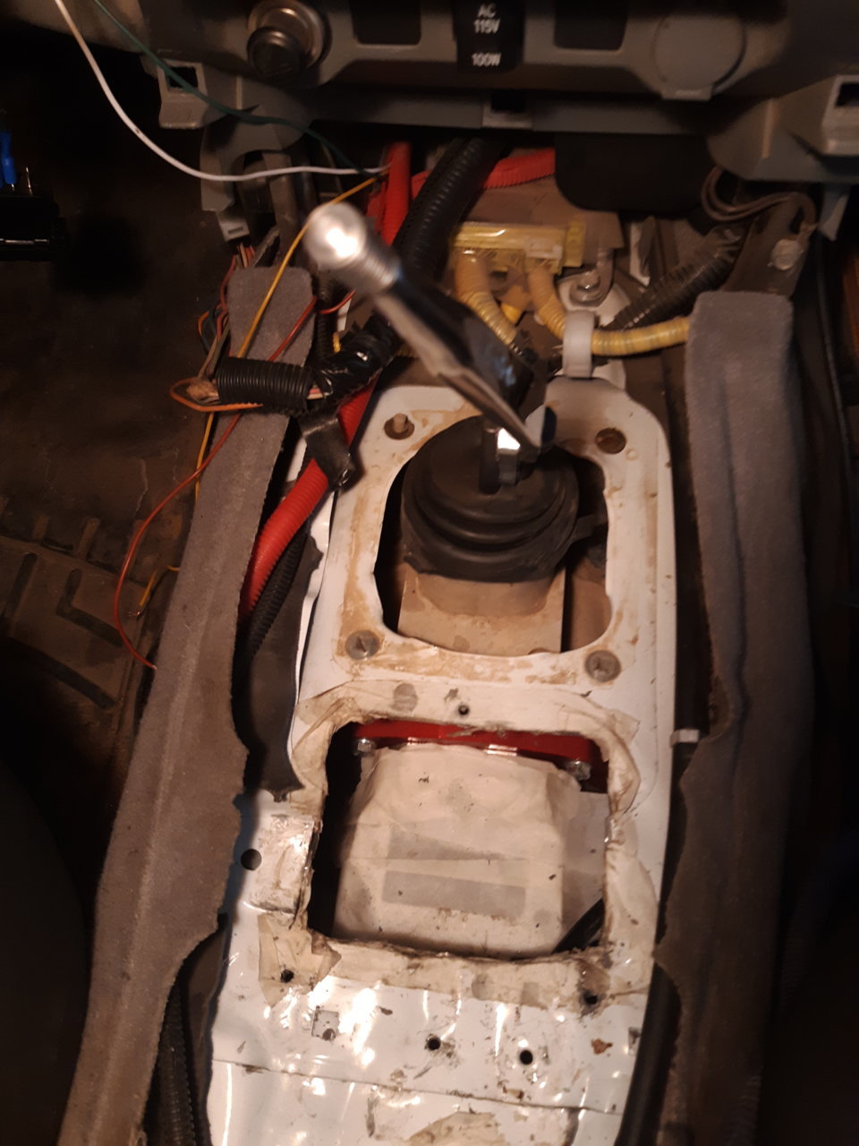

    I also didnt have time figure out how to seal the floor before Moab, so I have been running the truck with this giant hole I cut in in floor and the boot just kinda chillin over it. Needless to say it's been a bit loud in the cab, and the smell of gear oil spewing out the shift boot has been intoxicating.

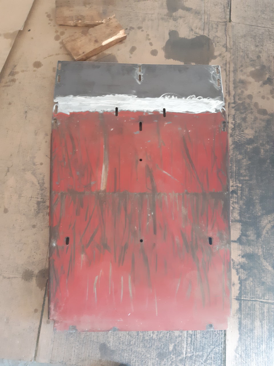

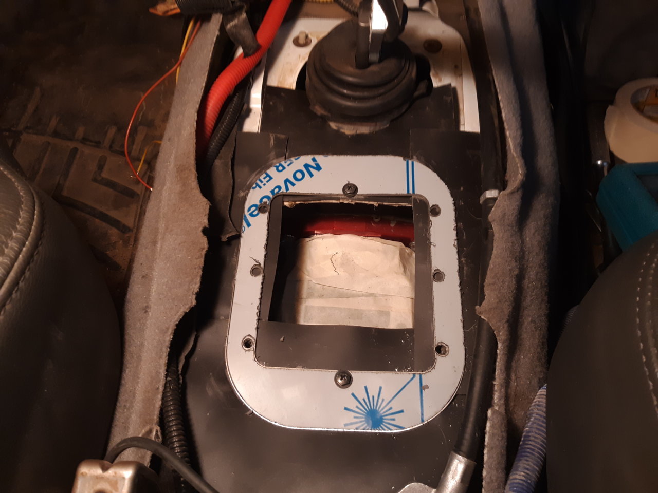

    Figured it was time to come up with something a little better. The floor of the truck where my hole is cut is incredibly uneven, due to just the shape of the floor and wailing on it with a hammer.
    To make the surface a little easier to seal with the boot I got from Radesigns with my triple shifter, I used some leftover mass loaded vinyl from sound proofing the back of my cab and I cut that up around the hole and glued the pieces together. I also cut a piece to fit closer up around the trans shifter to keep noise down up ther . Ideally I would like to put a moisture barrier and a decoupling layer between the MLV and the floor, but for now this will be a huge improvement over a gaping hole.

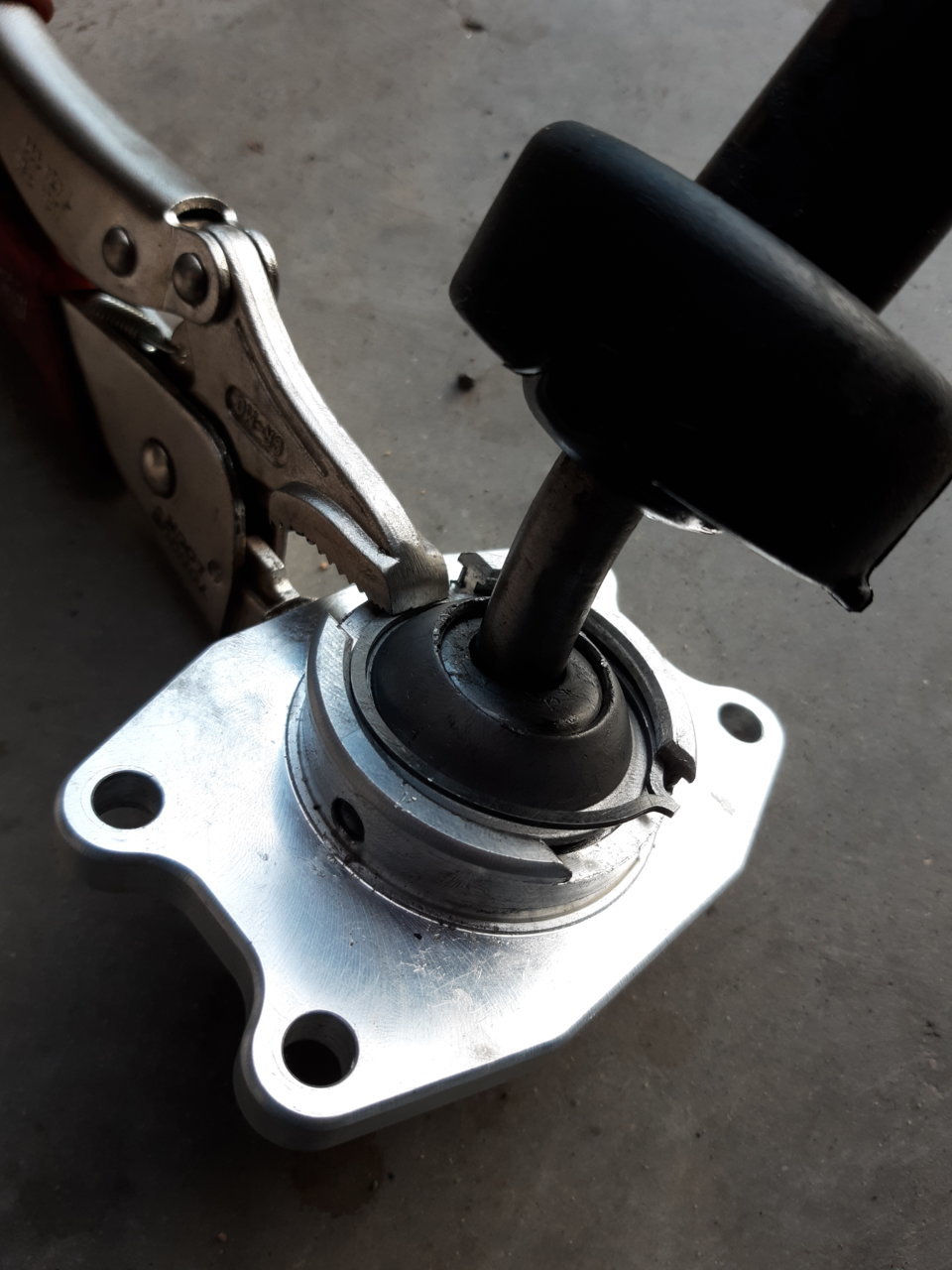

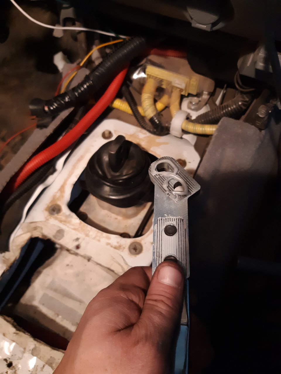

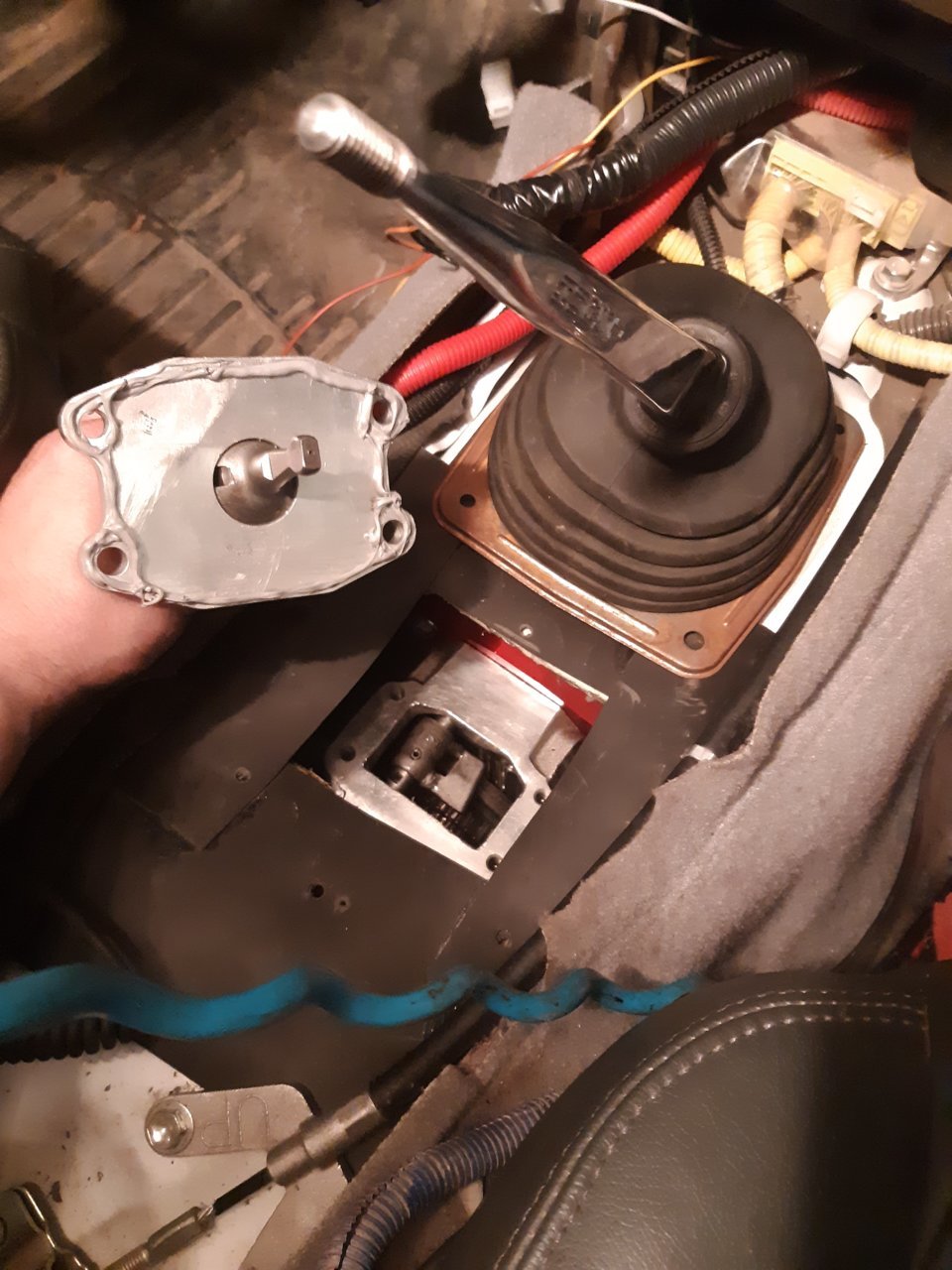

    Another thing that gave me hell with crawl box install was this damn c-clip for the shifter base. I tried like hell the day I was leaving for Moab to get it on with the shift base bolted to the crawl box and after 45 minutes of cursing and sweating, said screw it and just slid the boot over...knowing it would leak more and I would have to be 3xtra careful about not yanking it out when shifting. Only happened once on the trail. So I figured I would fix this today too...

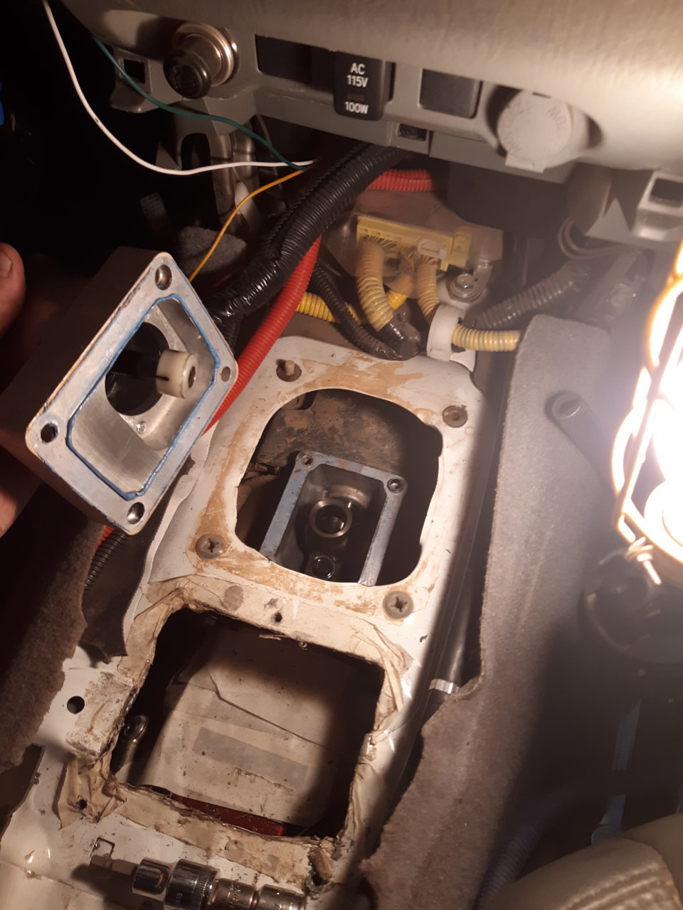

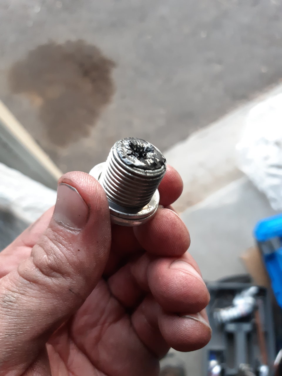

    With over 1,000 miles on the new crawl box and the shifter off, I figured I ought to change the oil. It was darker than I thought so I am glad I did. No major chunks on the magnet which is good. Roughly 2.25 came out so hopefully it wont spew so bad with just 2qts in there this time.
    Another thing I didnt do last time was seal the shift base...so that too could have contributed to my oil spewage.

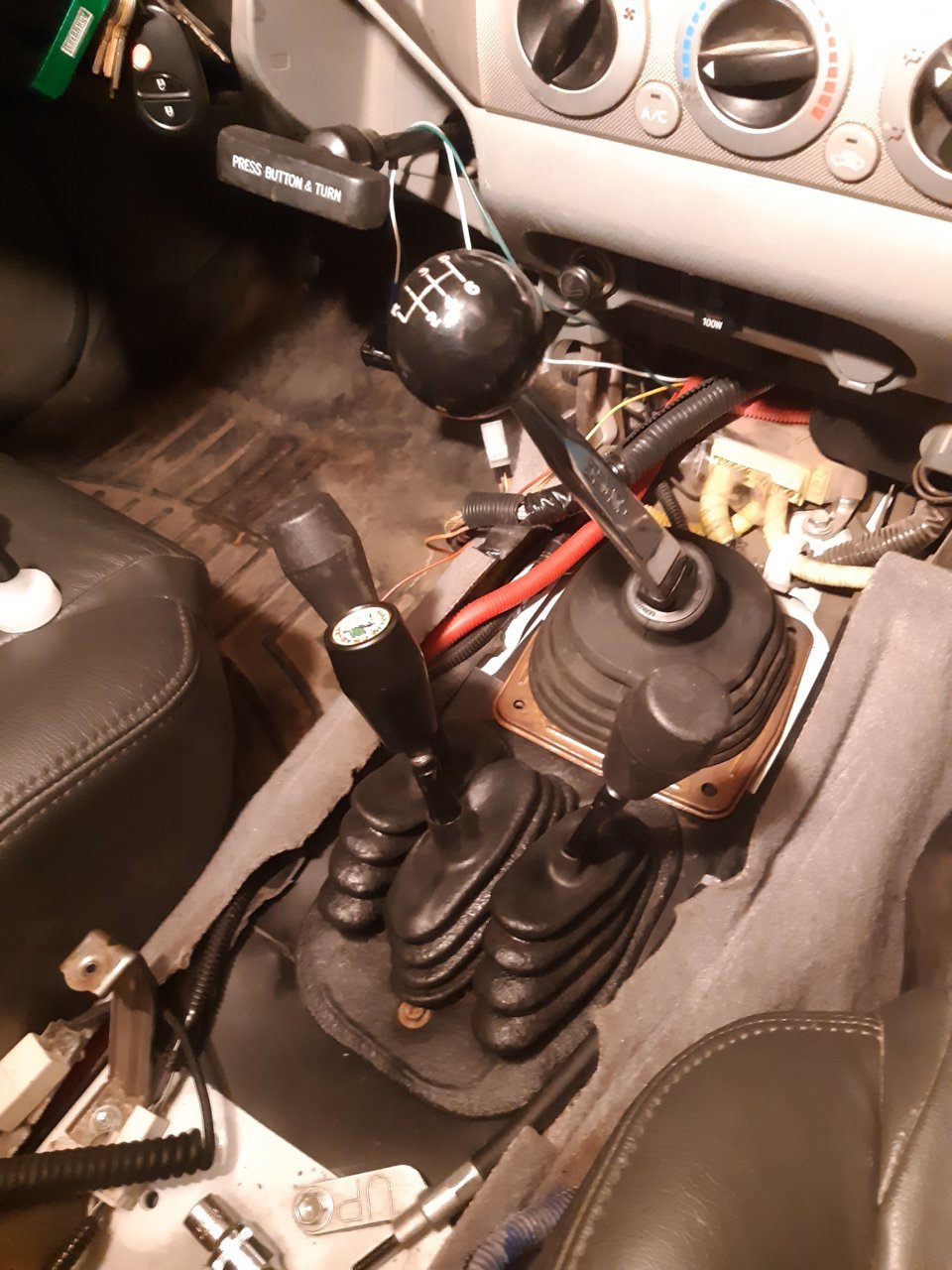

    And finally with the boot installed:
    The sticks do sit a little low inside the console. I need to raise them up a little higher so the knobs dont contact the center console before I finalize the interior boot.

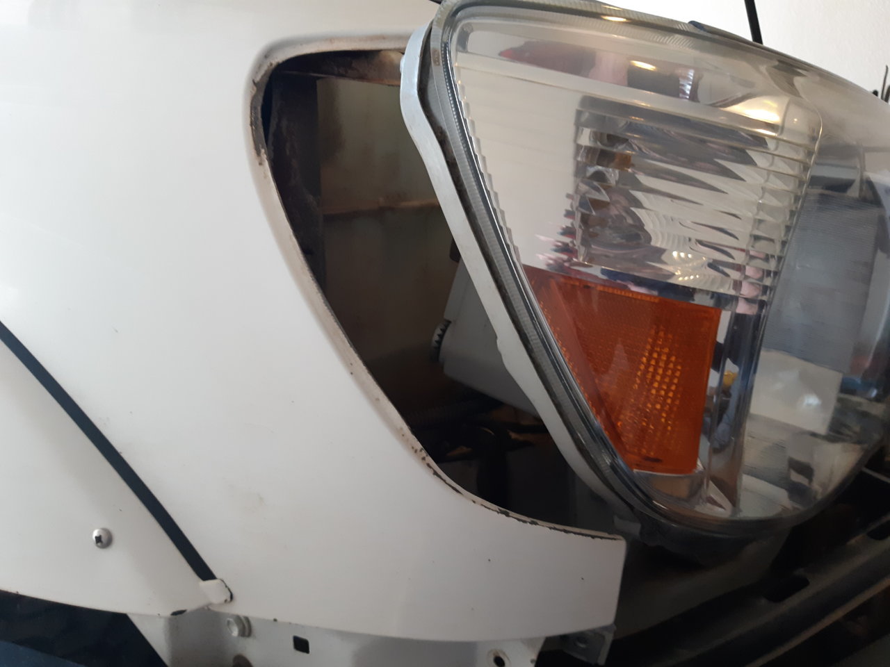

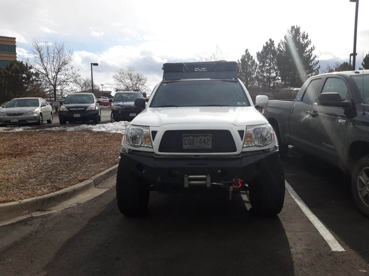

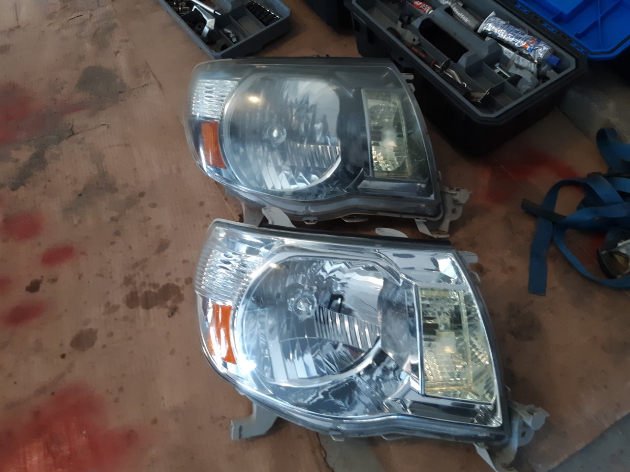

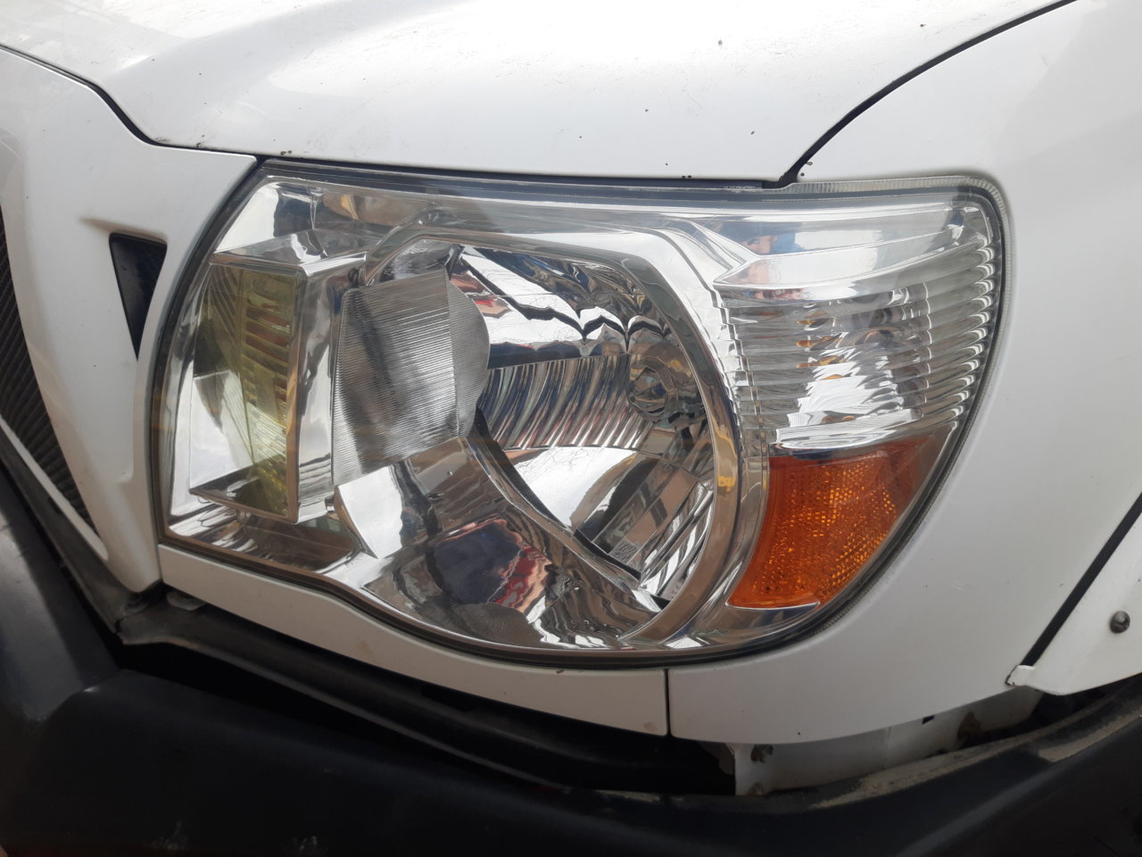

    Replaced headlights this past weekend with a set I got from @303tacoma. Thanks again Becca! They look so much better.
    I also touched up some paint chips around the lights and anywhere else I saw.

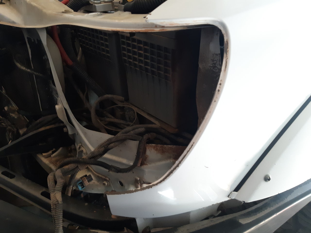

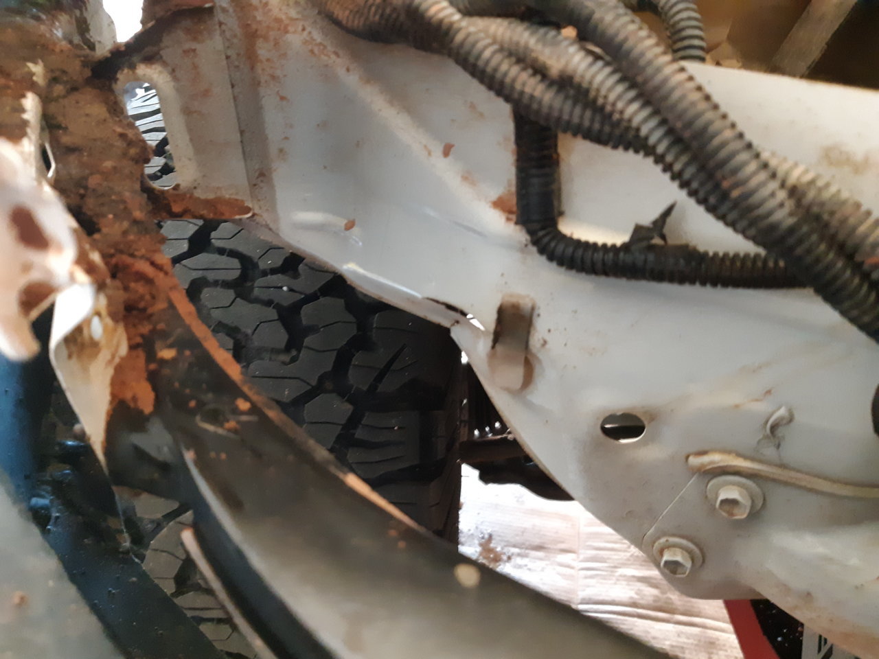

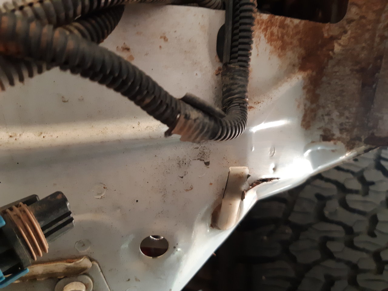

    Found some pretty awesome cracks in the core support while I was in there. Not sure what to do about that at the moment so I just put the headlights back in and will do my best not to think about for awhile.
    I had high hopes of being able to put my voltage monitor and dual battery disconnect switch in the old 4wd switch location next to the A/c controls and finally finish that off by taking advantage of some real estate I picked up with the FJ case swap, but I didnt think two switches would fit side by side in that blank so I tucked the wires in and popped in the blank for now. Its nice not having wires dangling for the first time since October.
    I need to do some work on my triple sticks to raise them up a bit before I have my boot made to finish that off.

    ICONS Front & extended Rears DAKARS LR UCAS Wheelers Super Bumps F/R Homersoshi & Bumper insert, Ultra Gauge, Wet Okole seat covers, AFE air filter, Truxedo tonneau cover, LED White Cluster swap by yosh2000, Audio upgrade, ECGS Bushing, rcbs204 Lighted 4x4switch, Bullaculla trailer harness relocate bracket SOS Concepts IFS skid & sliders Anti- Dark RedLine Hood Struts Matt Gecko Bed Lights BHLM Depo Tailights Fog light anytime mod ABS cancel mod Rear diff breather mod Brake light 35watt mod Relentless u bolt flip Mobtown Recovery Bar Sound deadener doors rear wall
    Welcome B
    You should look into upgrading your harness (Theyre located in Centennial)
    The light output is awesome running higher wattage bulbs..
    https://www.tacomaworld.com/threads/the-ultimate-headlight-upgrade-h4-not-led-or-hid.398066/
