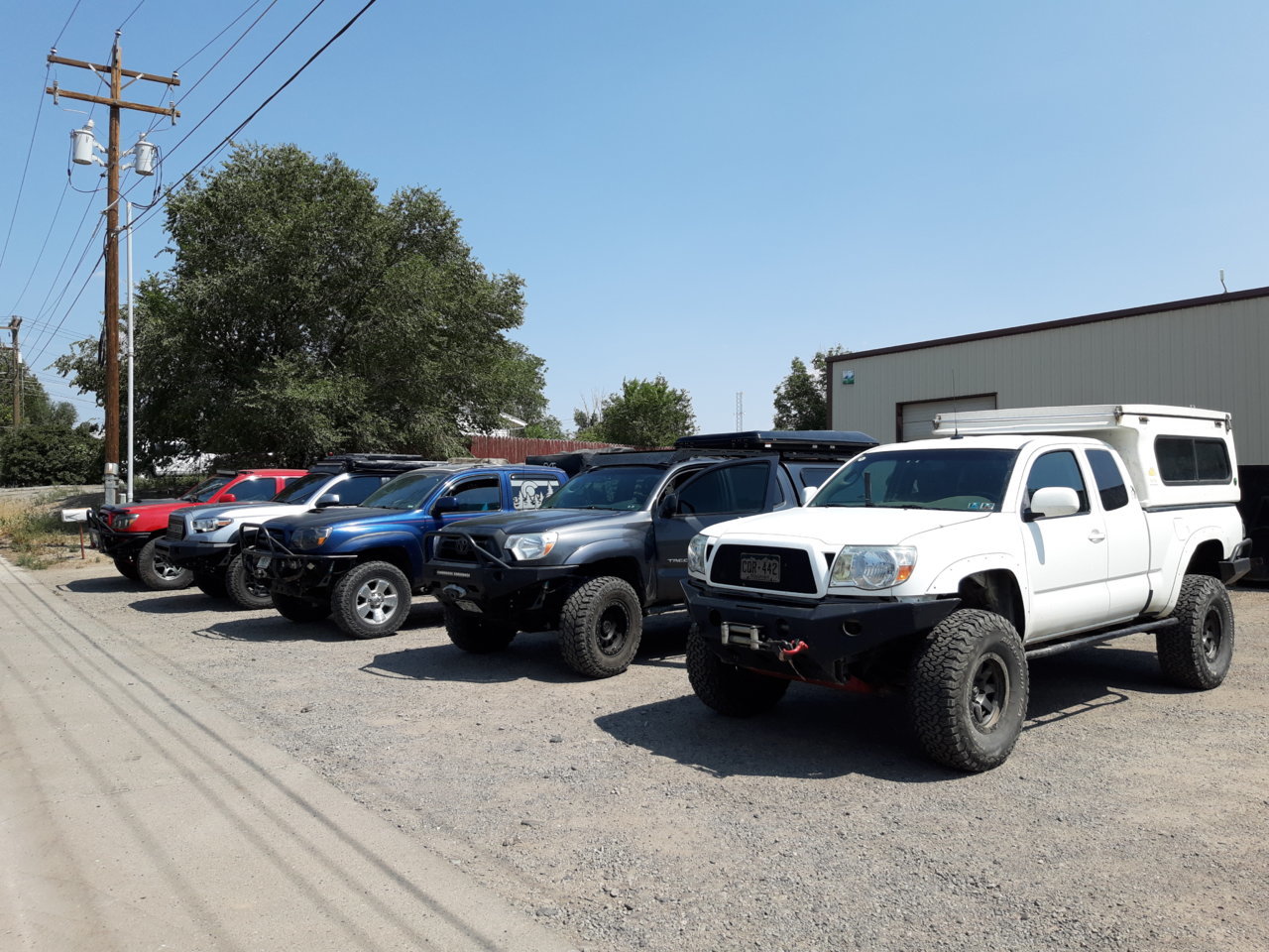

    Quick stop to see @In4aride and check out the progress on his 4-link setup in Montrose while we scarfed down some sammies.

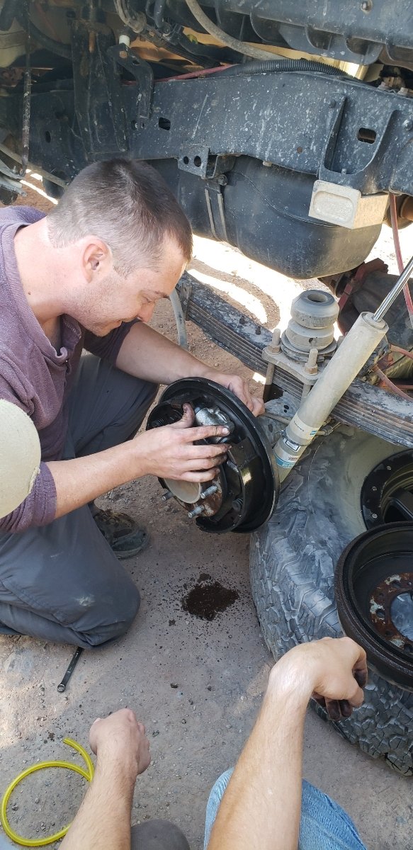

    It was right around this time, just before the switchbacks that my brake pedal started feeling squishy. My driver rear brake cylinder decided to blow an o-ring at the most important time to go slow. Fortunately I had the crawl box and ebrake to get me down safely otherwise i would have been strapping myself to the most willing participant and relying on them to stop me from rolling off the cliff. Oh and I also got to be a hero and drove a jeep down the first switchbacks because the driver was afraid.
    Not my photos as my mind was elsewhere, but damn...
    We left my truck in Telluride at the bottom of Black Bear. It was late and we scrambled to find camping and off Last Dollar road. Fortunately @Red Baron had a spare hammock for me to sleep in. I was snug as a bug in a rug until Alec, @bot102, aka my savior woke me up at 5:40am to make the almost 4 hour round trip journey to Montrose to get a replacement wheel cylinder. We met the rest of the gang back and my truck, swapped the cylinder and headed towards engineer pass by about 10:30am.
    Dont have any photos after this, but we ran engineer after about a 2 hour delay due to rolled jeep where the trail washed out back in June. I fucked up and couldn't remember how the trails connected, so unfortunately we missed Animas Forks, which is an absolutely awesome stop on the loop. Next time. Sorry guys.
    Aside from my brake debacle, it was an awesome friggin trip. I missed hanging out with everyone this year so it was good to sit around a campfire (albeit propane fueled) and catch up with my favorite people.

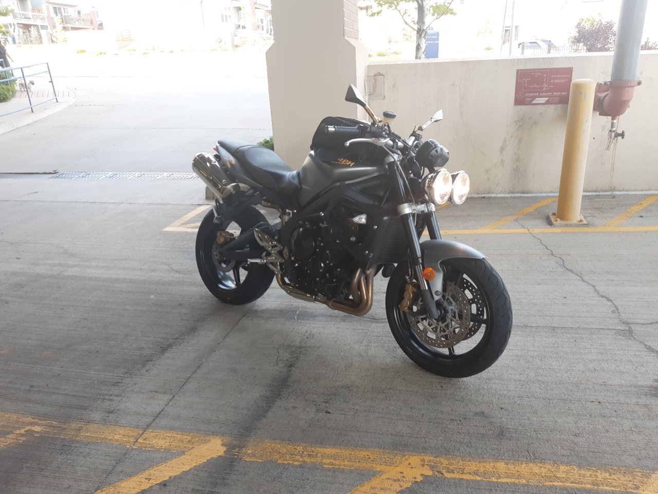

    I guess my final update is that I sold my sport touring honda VFR and bought a hooligan bike. The triumph street triple I have wanted since my early 20s.
    I fucking love this thing and being back in the saddle has been a source of internal peace I've been missing.

    Yeah it was definitely scary getting my brain to coordinate the first stops. I smashed it into gear a few times trying to change directions. We went up mineral. Considered poughkeepsie due to a jeep rollover at the mines but didnt have the time to run that route.

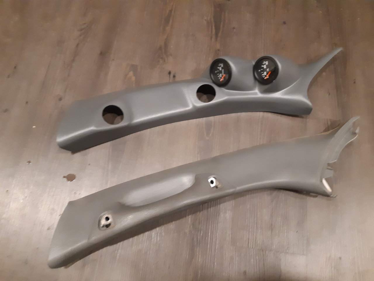

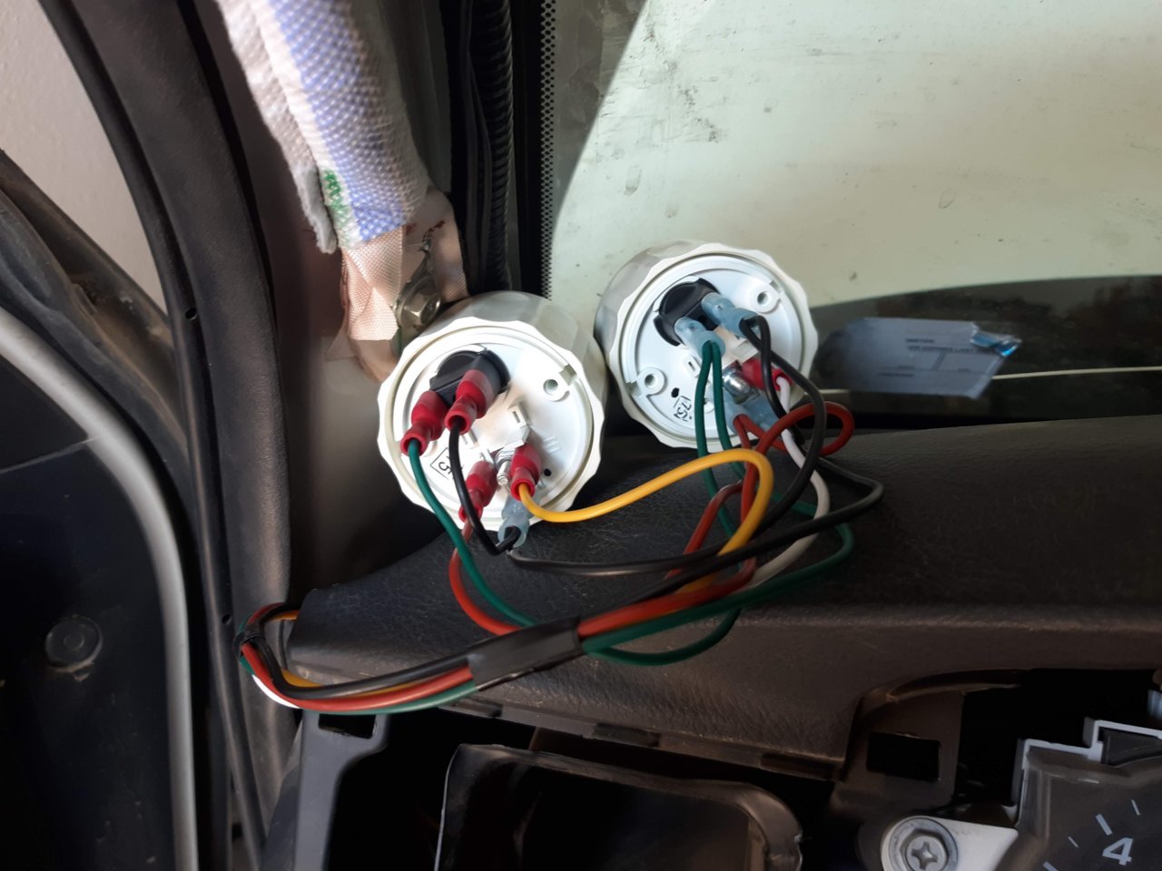

    https://www.tacomaworld.com/threads/transmission-temp-sensor-drain-plug.80034/#post-24283882

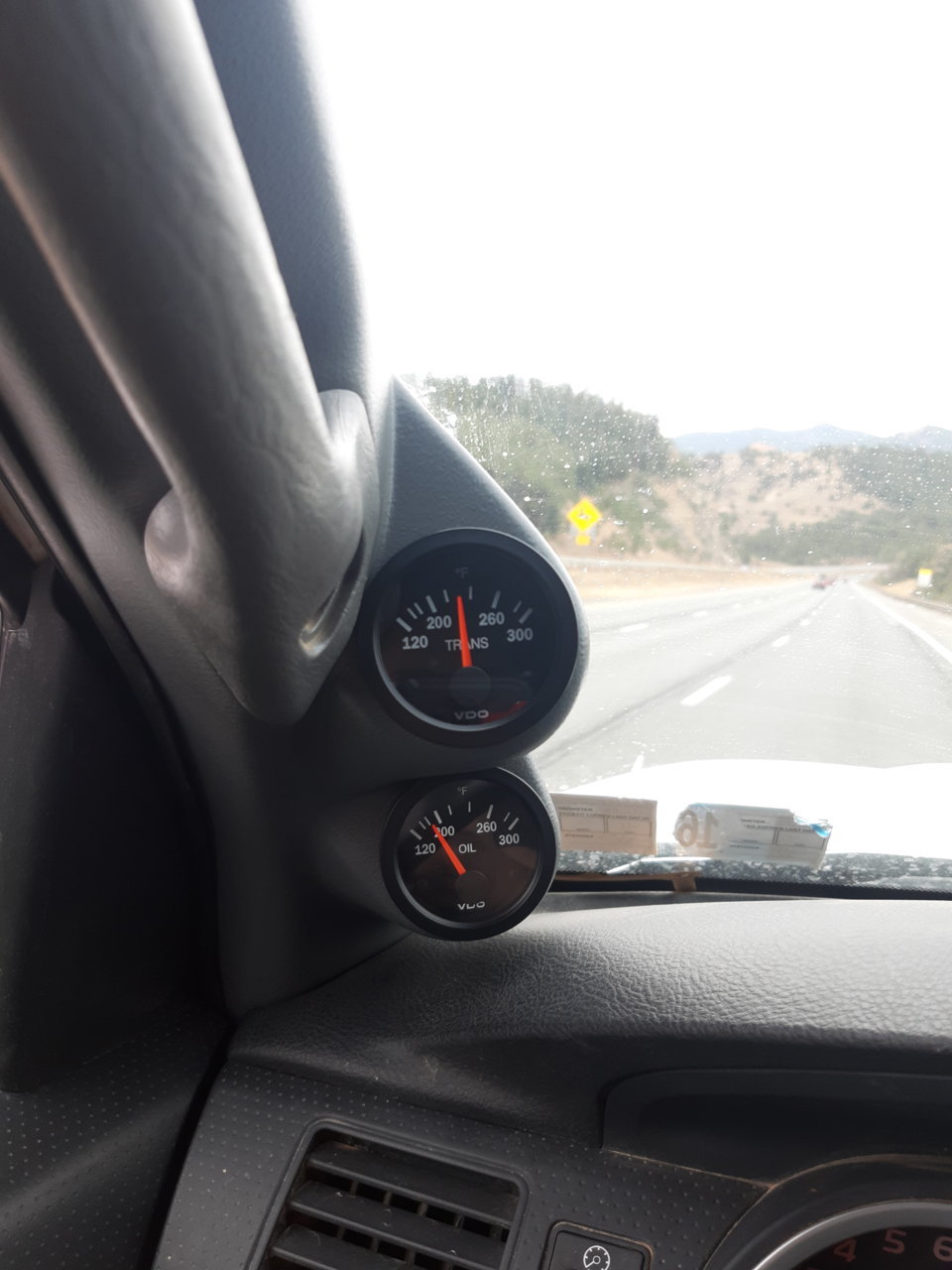

    After all these wondeful years of ignorance and bliss, I decided I needed more numbers to worry about. So, I installed temp sensors on my crawl box and trans and got my wish.
    I know all you naysayers think I'm a smacked ass for caring about the temp on a manual trans, but if I am to believe the readings, I've run my trans at 250+ degrees just climbing hills in CO and the fact is that oil is breaking down at that temp. So I am considering an oil cooler for the trans. Lots more research to do, but if theres any accuracy in my gauges that's too hot for me.

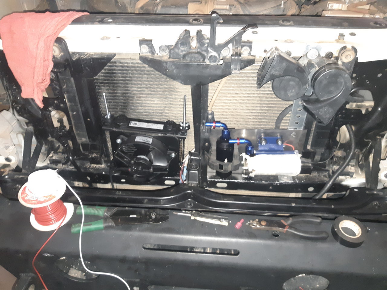

    Elizabeth, CO
    3 tons of fun

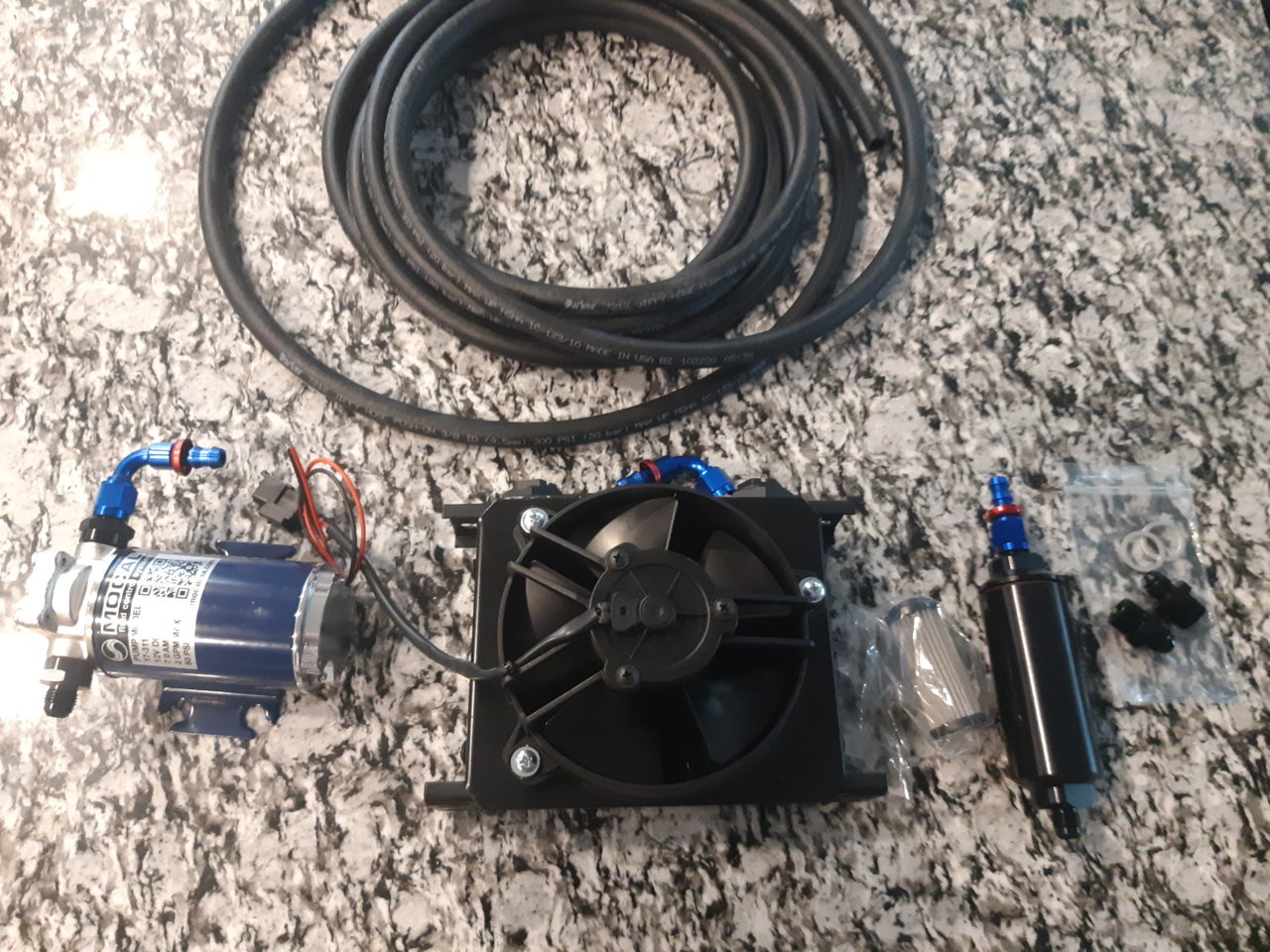

    Since installing my temp gauges on my manual transmission, I've seen temps over 240 degrees 3 times...yikes. Twice climbing a series of long hills in CO, and once on the trail after hammering it playing in the sand up near Walden.
    So it's no longer a maybe on the trans cooler. Called up drift motion and spoke to Odom who was extremely helpful. They do coolers for other R-series manual toyota transmissions in race vehicles outputting high horsepower. They use the existing drain and fill plugs which are the same thread pitch and everything so they've got most everything I need on hand to DIY. Tentative plans are as follows...hopefully this post will eventually become its own how-to thread since I haven't seen anyone with a trans cooler on a manual taco :cool:
    Parts List:
    1) Drift Motion Manual Transmission Oil Cooler Kit
    https://www.driftmotion.com/Driftmotion-Manual-Transmission-Oil-Cooler-Kit-p/dm3561.htm
    Options:
    • Filter:INCLUDE 240 Micron AN-6 Oil Filter
    • Oil Pump:INCLUDE Mocal 17-311 Metal Gear Pump
    • Thermostat Switch:INCLUDE Setrab 180 Deg. 10A Thermostat Switch
    • Transmission Cooler:INCLUDE Setrab FP119M22i Cooler With Fan
    • Transmission Fittings:ADD (2) 18mm to AN-6 Fittings With (2) Crush Washers
    2) 1 x AN-6 female to male 90 degree for transmission drain plug
    https://www.driftmotion.com/90-Degree-AN-Male-to-Female-Adapter-Plated-Steel-p/dm3478.htm
    3) 5 x AN-6 Push Lock 90 Degree Fittings for trans fill plug, filter output, pump input, cooler input, and cooler output
    https://www.driftmotion.com/ProductDetails.asp?ProductCode=DM2378
    4) 3 x AN-6 Push Lock straight Fittings filter input, pump output, transmission drain (attached to the dual inline fitting, after the sensors. See #7)
    5) 17ft x 3/8" push lock hose
    https://www.driftmotion.com/ProductDetails.asp?ProductCode=DM31
    -75" from trans to filter mounted vertical near with input near bottom of radiator mount driver side
    -12" from top of filter to oil cooler near center of radiator
    -24" from oil cooler output near top of radiator on passenger side to oil filter on driver side of radiator next to filter
    -75" from pump to trans fill plug
    Total 186" or 15.5 ft of hose + 1.5 ft of extra = 17ft

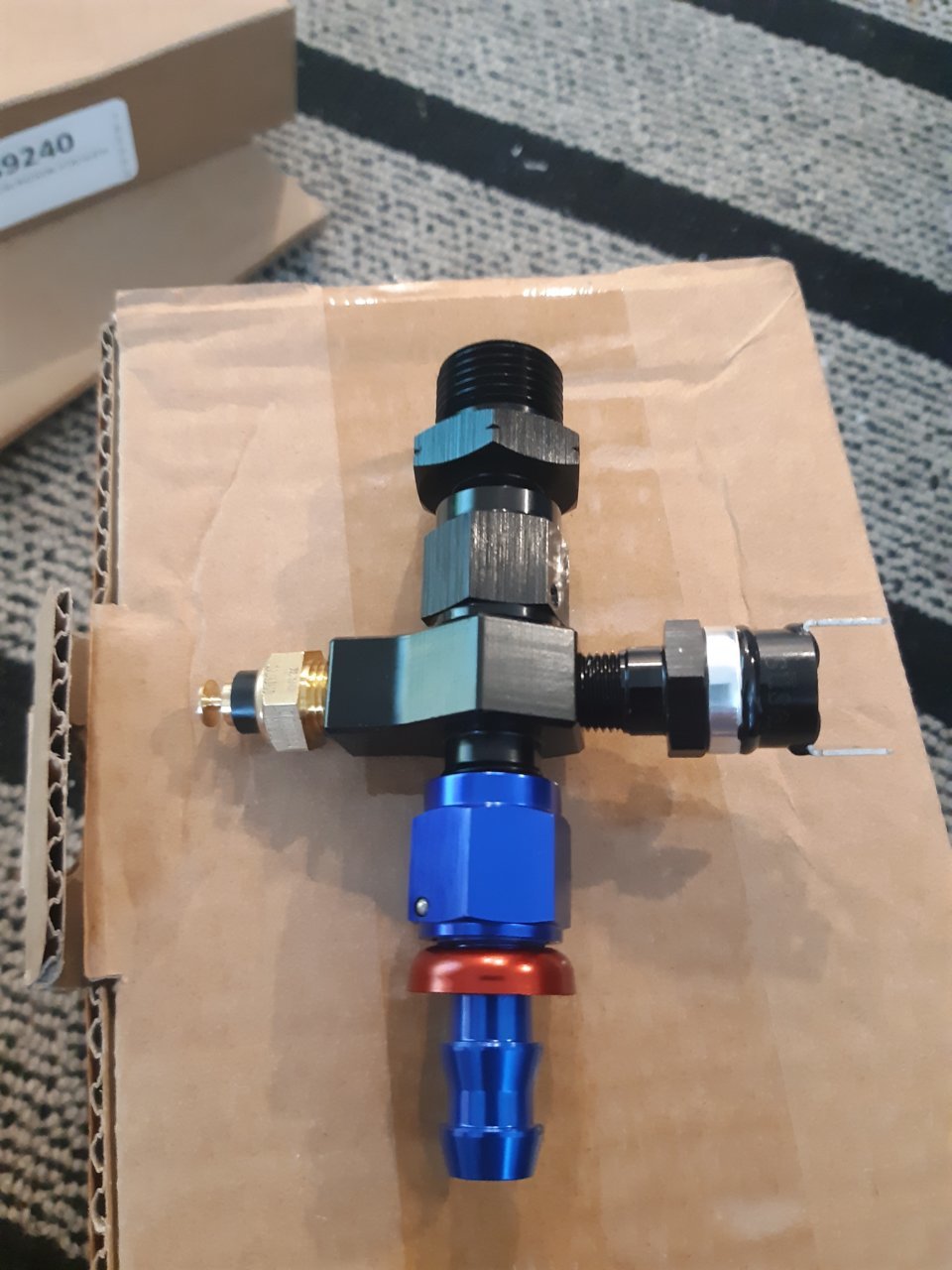

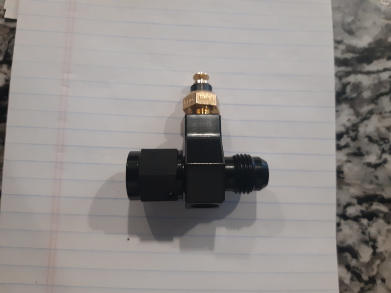

    6) VDO 0-300 degree temperature sender 1/8 npt
    https://www.vdo-gauges.com/300-f-150-c-1-8-27nptf-801-9-1.html
    7) AN-6 inline fitting with dual 1/8" NPT port for both the thermostat (included in drift motion kit) and temp sensor (see above):
    https://www.anhosefittings.com/an-male-flare-to-an-female-dual-1-8-npt-female-sensor-ports.html
    7) 10ft plastic conduit
    8) 1 x set of battery tie downs from AdvanceAuto (for cooler mount)

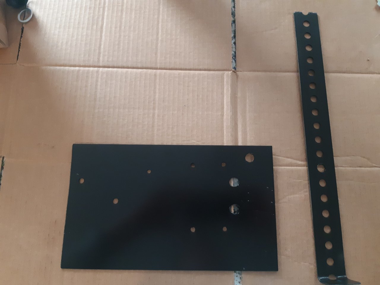

    9) 6 x 10.5" 18 gauge sheet steel
    10) 16" of 1 3/8" pre-drilled flat steel

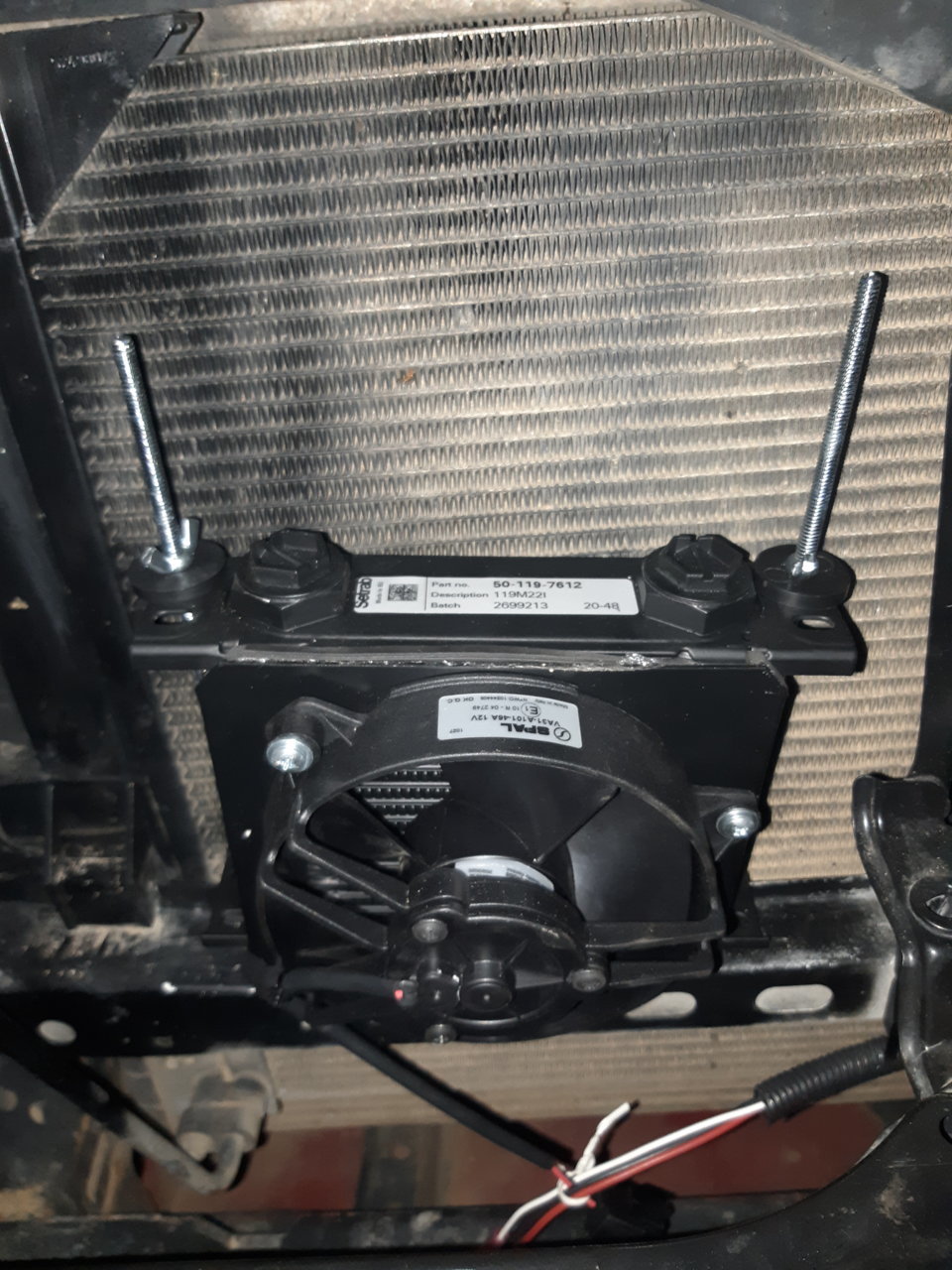

    Mounting
    Cooler:

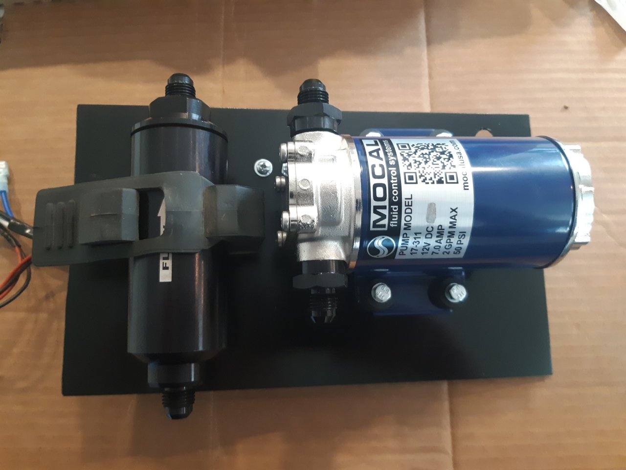

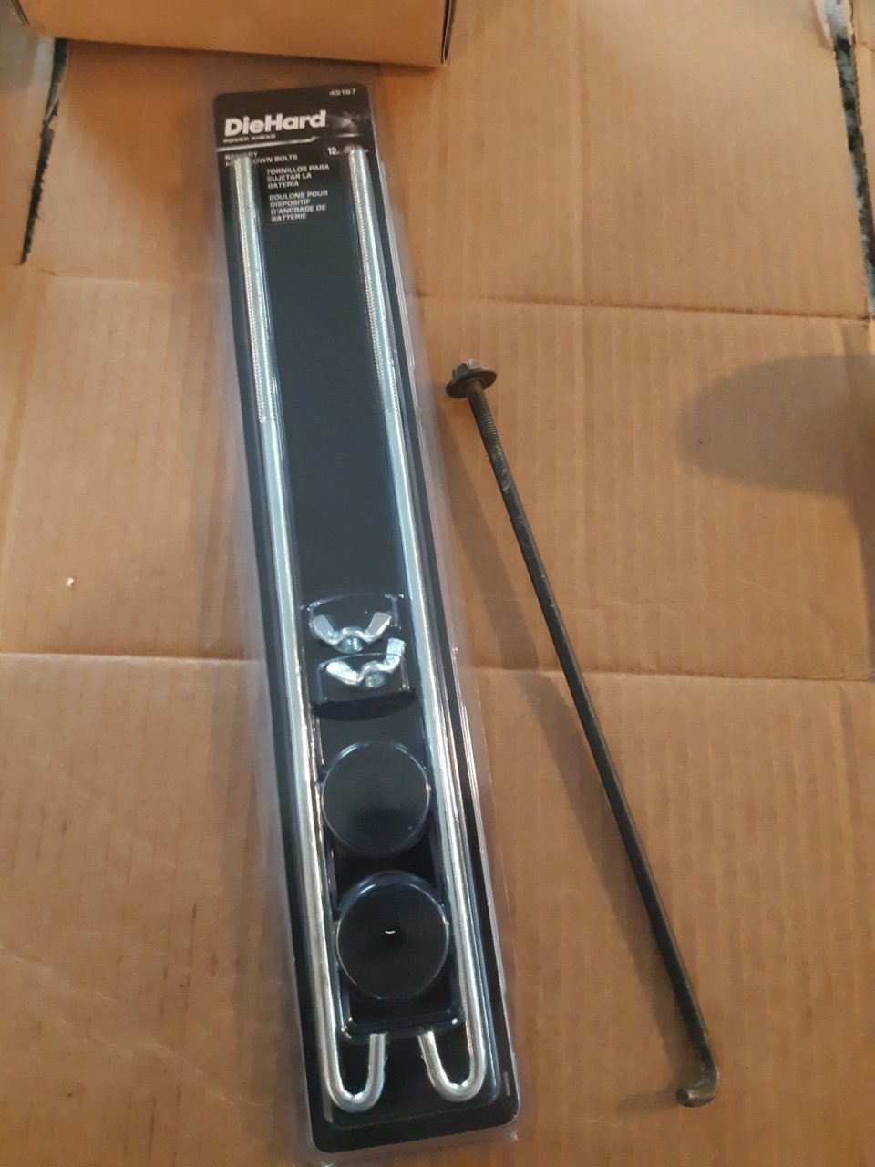

    After realizing that the threaded side of the factory battery tie down was perfect for this, I bought a matching set of battery tie downs from AdvanceAuto. Hooked right onto the bottom of the lower core support. I do have some concern that they could cause the core support to crack sooner. I will keep an eye on it.

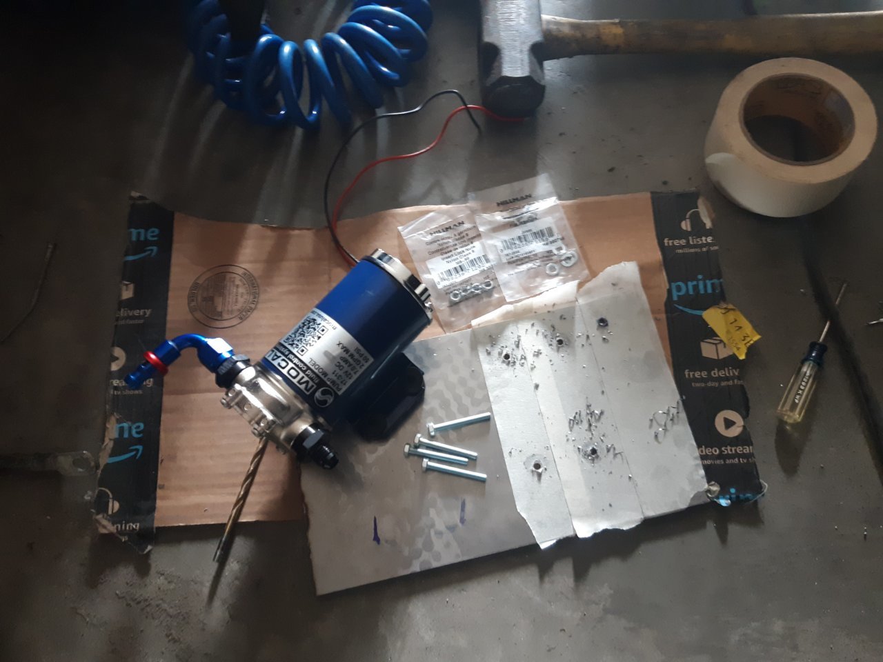

    Pump and filter:
    According to the install instructions, you can mount the pump any direction except the direction I was originally planning. I used a piece of 16 gauge steel from Lowes that I cut down to approx 6 x 10.25" and for the vertical support a piece of 1 3/8" drilled flat steel cut to approx 15.5" which I heated with torch and bent the bottom 90 degreees after fitting up the top to an existing bolt hole where my horns were.
    I marked my drill holes for the pump and attached with four M5-.80x40mm screws. I'd recommend x25mm or x30mm length as mine are excessively long. I also wound up drilling holes large enough to bring the pump wires through to the back plate with a spade connector on the end so that I can remove the pump later without cutting wires.
    For the filter mount, I had a rubber QuickFist laying around that used to hold my shovel on the truck. Works well enough for now.

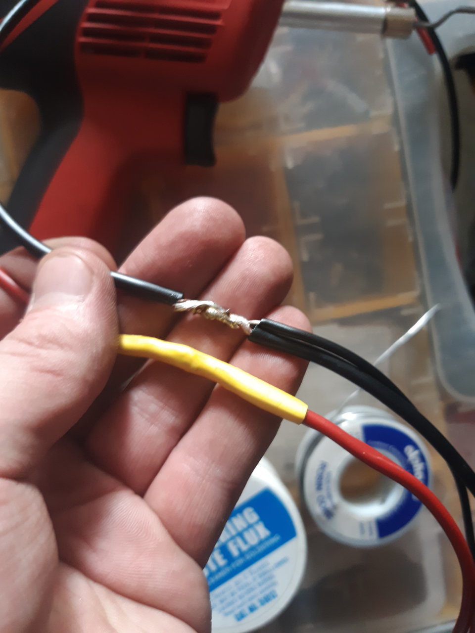

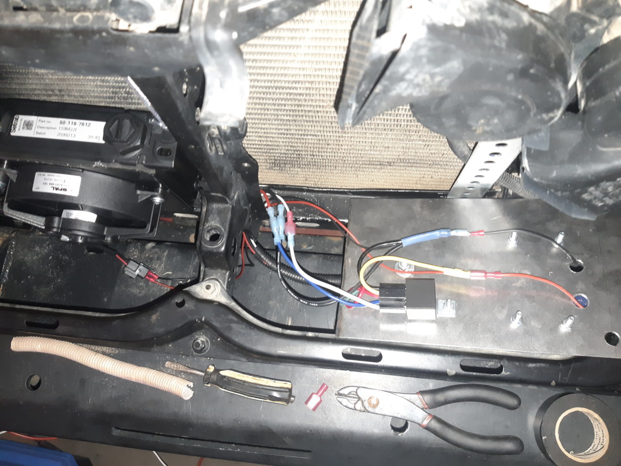

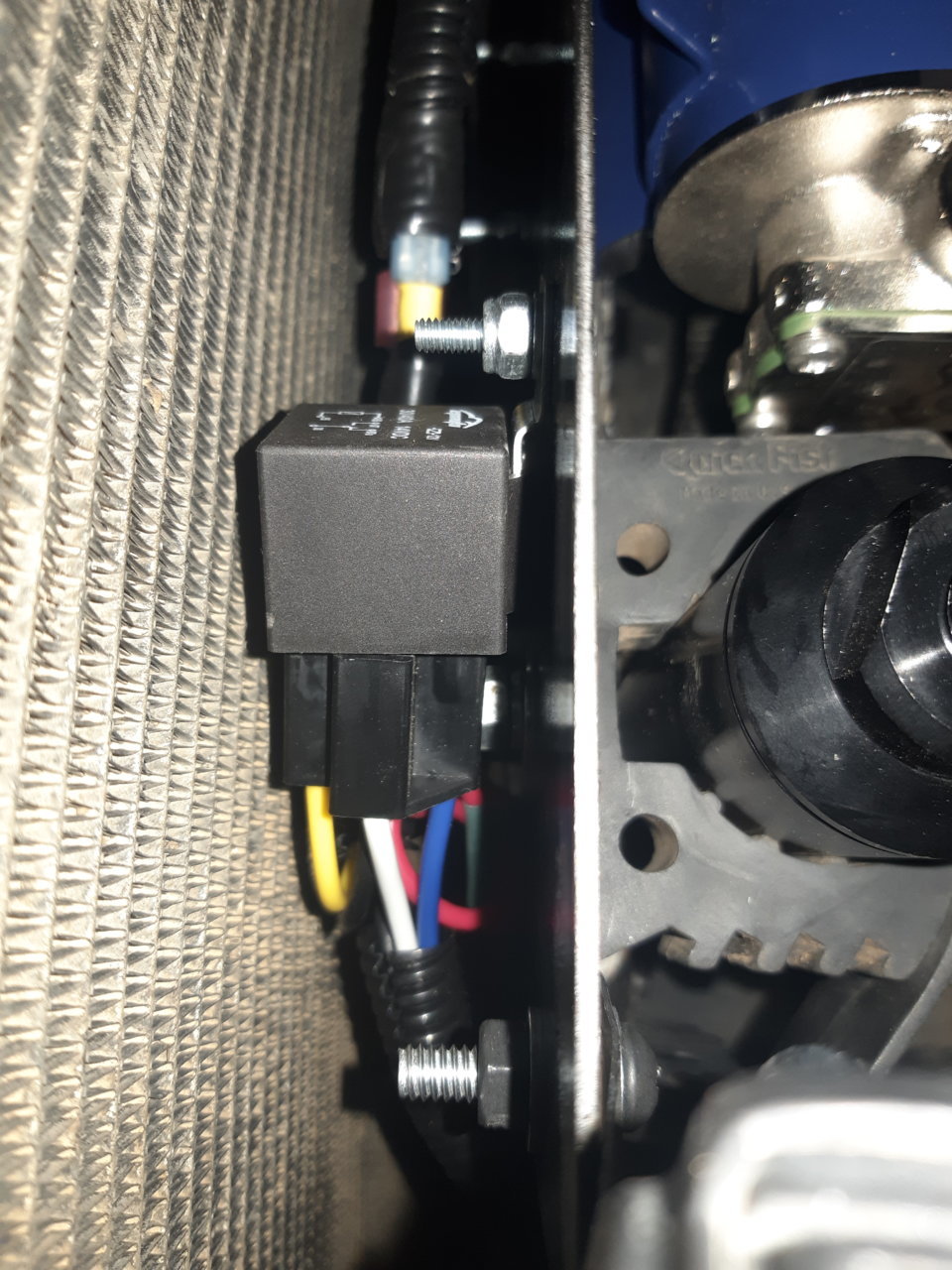

    Wiring:
    The pump, fan, and relay are intended to be easily disconnected with spade connectors. The relay and wiring are on the back of the mounting plate. The clearance between the mounting plate and radiator is tight, but there close to 1/4" of space so I think it will be fine.
    From my fuse panel, I ran about 12-14" of 14 gauge wire, which I then split off into a set of 18 gauge pos/neg wires to run down to the trans for the thermostat and sensor, as well as a set of 14 gauge pos/neg wires to run to my relay and power the fan and pump. Everything in plastic conduit.
    The red 18 gauge positive runs to the thermostat, which activates the relay once it hits 180 degrees through a white "trigger" wire that I ran from the trans up to the pump/fan assembly. The black 18 gauge negative wire will serve as a ground for the temperature sensor since the fittings will not conduct a ground for the sensor through the trans like my old did.
    The SPDT (single pole double throw) relay harness is confgured as follows:
    Red: HOT while relay is OFF (Not used)
    Yellow: Hot while relay is ON
    Blue: 12v positive source
    White: relay "trigger"
    Black: ground
    The YELLOW wire on the relay harness provides power to the pump and fan and is wired with 18 gauge wire and spade connectors so everything can be easily disconnected.
    The BLUE 12v positive input on the relay harness connects to the red 14 gauge wire I ran to the battery.
    The WHITE wire on the relay harness is connected to the white "trigger" wire that runs to the thermostat that gets installed at the transmission drain. This white wire will carry the positive 12v signal coming from the red 18 gauge positive wire on the other side of the thermostat once the temp reaches 180 degreees.
    The BLACK wire on the relay harness gets connected to the 18 gauge wires for the fan and the pump, and the black 14 gauge negative wire that I ran to the battery all with spade connectors.
    The final version of this has rubber grommets installed around the pump wires so they don't get cut open against the edge.
    Its tight but theres just enough space between the radiator. Wrapper all the wires in plastic conduit before install.

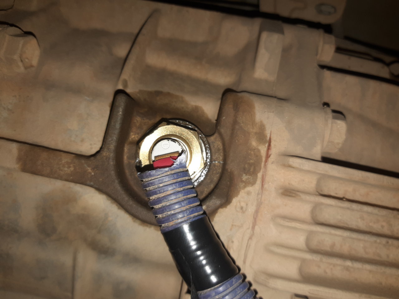

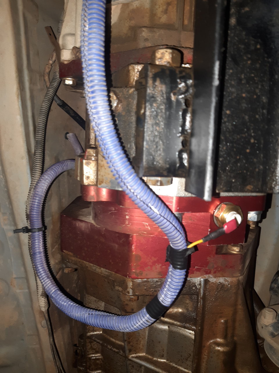

    Sensors:
    Pics with the 1/8 npt vdo sensor:
    Information:
    RA60F Manual Transmission drain and fill plug thread pitch is 18mm x 1.5mm
