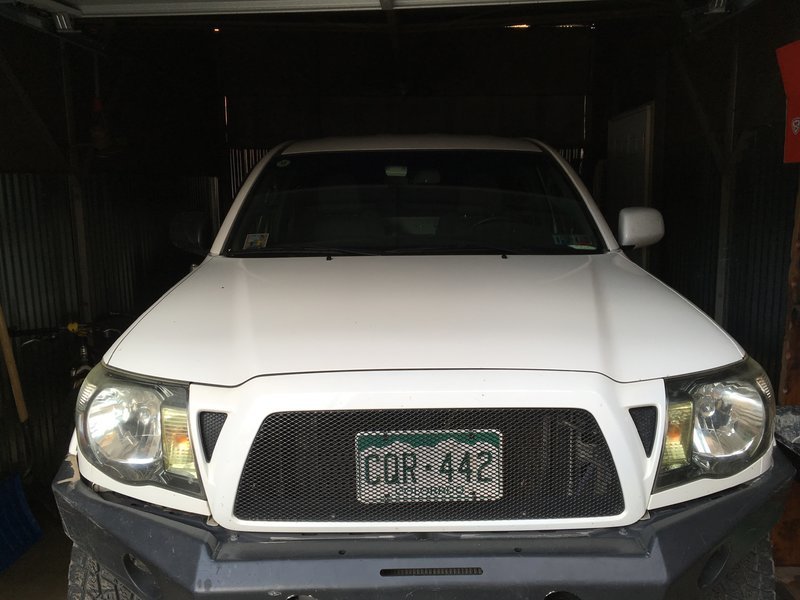

    Swapped out the sport hood this weekend with @IdRatherBNTheSanJuans. I like the new look :thumbsup:

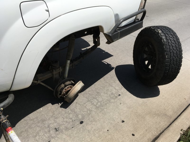

    Unfortunately on the way home, I went from a 6 lug pattern to a 5 lug pattern on my driver side rear wheel when it decided it didn't want to be on my truck anymore. Fortunately, it happened after I got of the highway doing 75mph, and I was approaching a traffic light and was going less than 10 mph.

    With all the suspension work I've done in the past month or so, I have no one to be blame but myself for not double checking and tightening the lug nuts down. I'm glad no one else was hurt, and I didn't screw up my nice new hood.
    I have six OEM studs coming in tomorrow, and trying get my hands two sets of replacement lugs to match what I've got...just to have an extra set.
    I think the tire is ok, but I was thinking that since theres damage to this wheel, and my current trail spare doesn't have any scratches yet, i should probably swap it out for safety reasons, and because I want all my wheels to match.

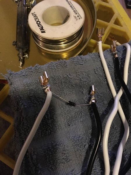

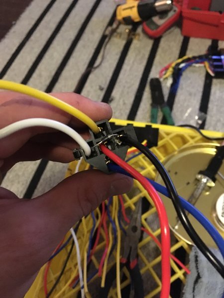

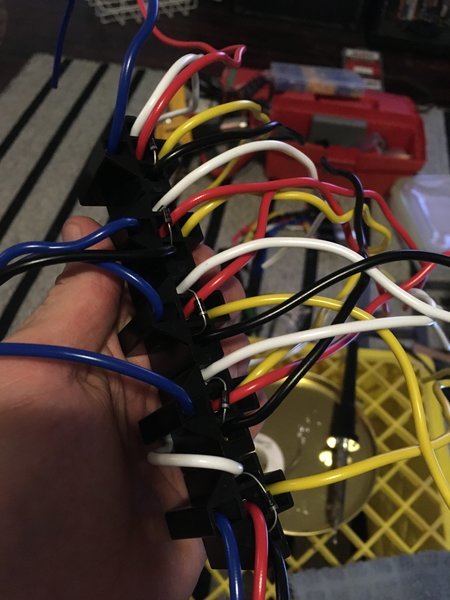

    Today I decided to start on some of the wiring for my aux fuse box. I don't really know what I'm doing here, but I read that a fly back diode will help extend the life of your relays by giving a path to discharge voltage when the relay is opened. For certain accessories, I believe this is actually necessary to protect the accessory, so I'm practicing my soldering by attaching diodes from pin 85 (-) to pin 86 (+) on all of my harnesses just to be safe.
    It's probably going to take me a few months to get this whole thing put together. I'm still thinking about how I want to do the Lexan, or if I'm going to put this in a water tight box.

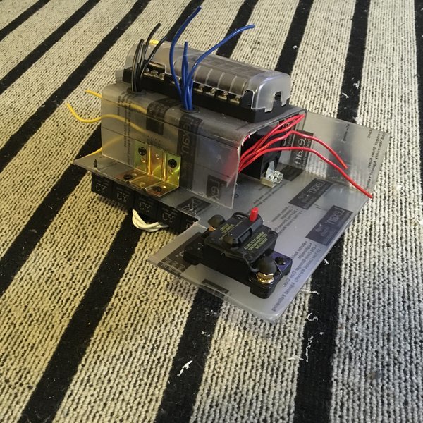

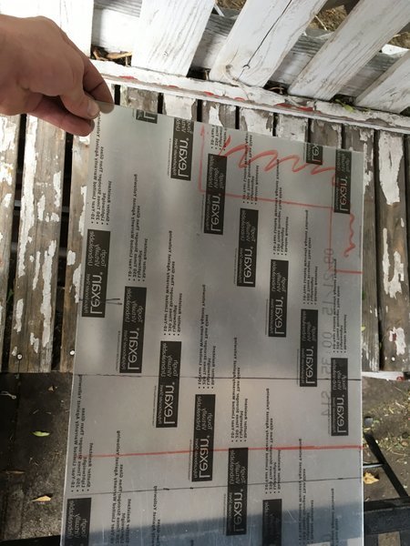

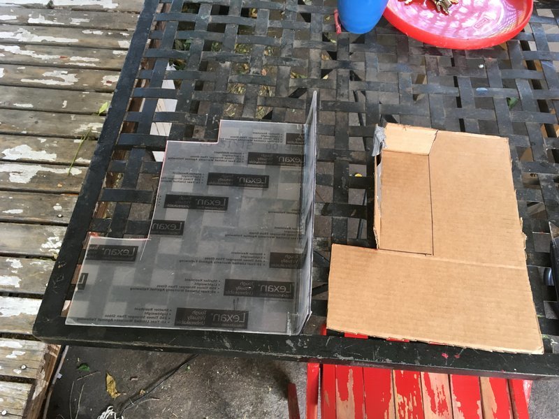

    Progress on the aux box...cut and shaped the Lexan, and mocked up the layout.
