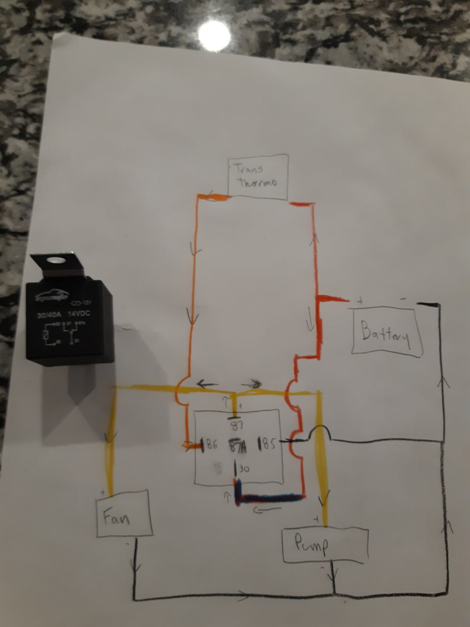

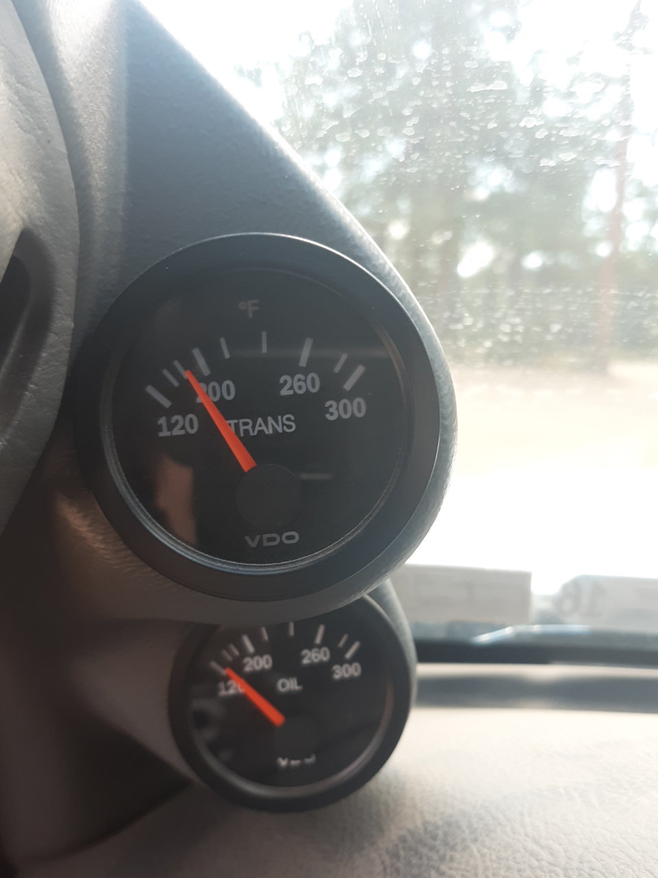

    Just completed another test drive.
    I flipped on the cooler after 22 miles when the crawl box was at 120. The trans gauge immediately shot up to about the 160/170 mark and stayed between there and 200 as I continued to drive. With this configuration I am only going to get an accurate reading when the pump is flowing, and it's pretty damn consistent with my pre-install observations using the new sensor. Otherwise it's off by 30 degrees warming up.
    Unfortunately I had to cut the test short when I heard what I thought was a loud pop. I shut everything down and looked over everything but saw no issues. In retrospect I think the pop I thought I heard may have just been my phone falling out of the holder and hitting my center console. At any rate, by the time I fired the truck back up and flipped everything back on, the trans was down to about 150/160 and continued to fall below the lower line which I'm guessing is 140. It stayed there the rest of the ride home during which I left the cooler running. Obviously I dont want it running that cold, but its all functioning mostly as planned.
    It certainly wasnt the long drive through the mountains situation I'm most concerned about, but I'm going to call that a promising, successful test result. I'll be out playing this weekend and headed to west slope in mid sept, so I'll have more data soon.
    I got to thinking about this on the drive and I really like this idea the more I think about it.
    I dont want to over complicate it, but I've already got two relays in the mix...so i could swap those out and use a time on delay and time off delay to run the pump for 3 minutes every 15 minutes, and default to the thermostat in between. That would allow thermostat to do its thing above 180 and and cycle the oil through periodically below that temp.
    SPDT time delay off relay
    https://www.qualitymobilevideo.com/bu509td.html
    HELLA 996152151 12 Volt 5 Pin 0-900s Delay On Time Control Unit https://www.amazon.com/dp/B003C508Y8
    Or I could drill some holes in the transmission and be done with it.
    Of course the big appeal to this setup for me was not having to drill.

    Those are time delayed. Not timer. I was meaning something like this:
    Timer WIFI 10 AMP 6V 12V 18V 24V TIME ON OFF DELAY CONFIGURABLE, CYCLING and OPTIONAL TRIGGER https://www.amazon.com/dp/B083HN673G

    Thanks, that's how I would have wired it as well, what I was asking was where in the schematic the thermostat (switch) was in reference to your relay coil. You have wired it positively switched which is what I would have expected. I'm guessing you had an intermittent connection on the contacts of the relay to the fan/pump. Did you check polarity to the fan/motor, perhaps they were spinning backwards from how you intended them to flow and hit some kind of flow restriction. I don't know how you plumbed the cooler or what's upstream/downstream of the cooling unit so you may have dead headed the pump? Just a guess.

    Gotcha. Thanks for the input. Polarity of the fan is correct. Flipping the wiring will just run it in reverse.

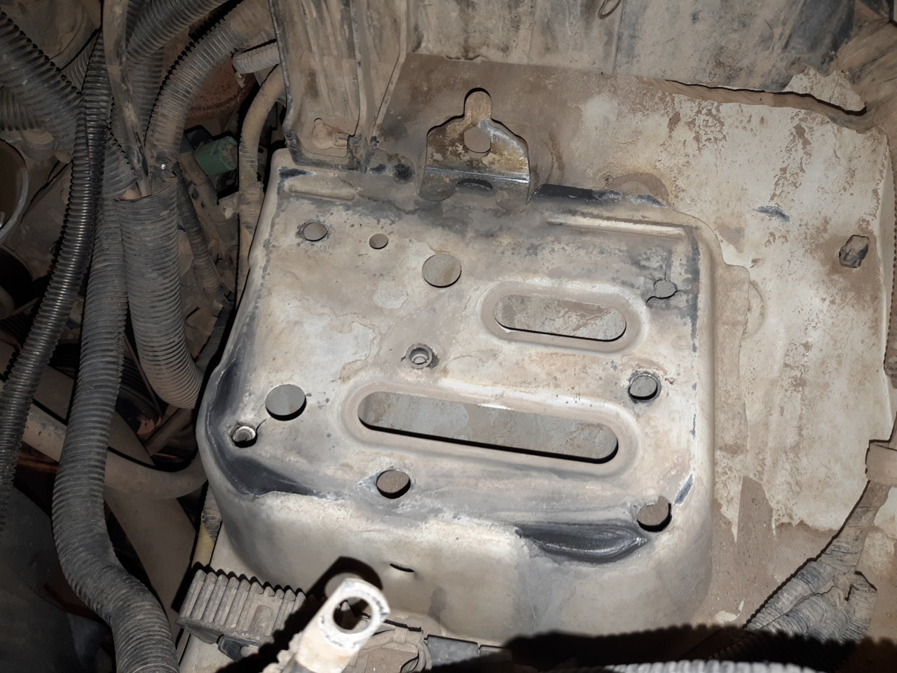

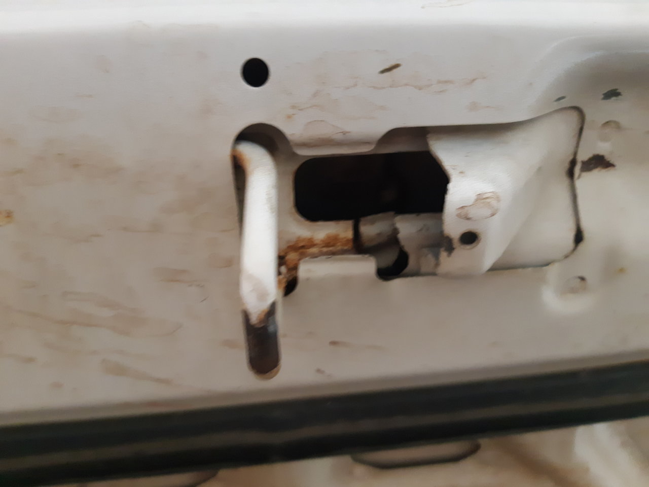

    Chasing down a few popping and clunking noises in my front end that have been getting worse. Two culprits identified. Skid plate and batteries.
    Both the square nuts that hold the front skid plate to the frame just behind the bumper broke off the frame. Easy enough to fix. I "welded" new nuts on but you dont get to see those because they look like shit.
    I also noticed the batteries seemed a bit loose, so I pulled those. Everyone said dont put duals in the factory location. I didnt listen. Every single mount point for my off grid engineering dual mount broke off. The shit was literally just sitting on top of the fender loose bouncing around. One or more of these are going to the bed, but that's a fair amount of work and probably more long term. Not sure what I'm doing just yet in the immediate term. I knew it wasnt a great idea but I didnt think it would break down this bad this fast.

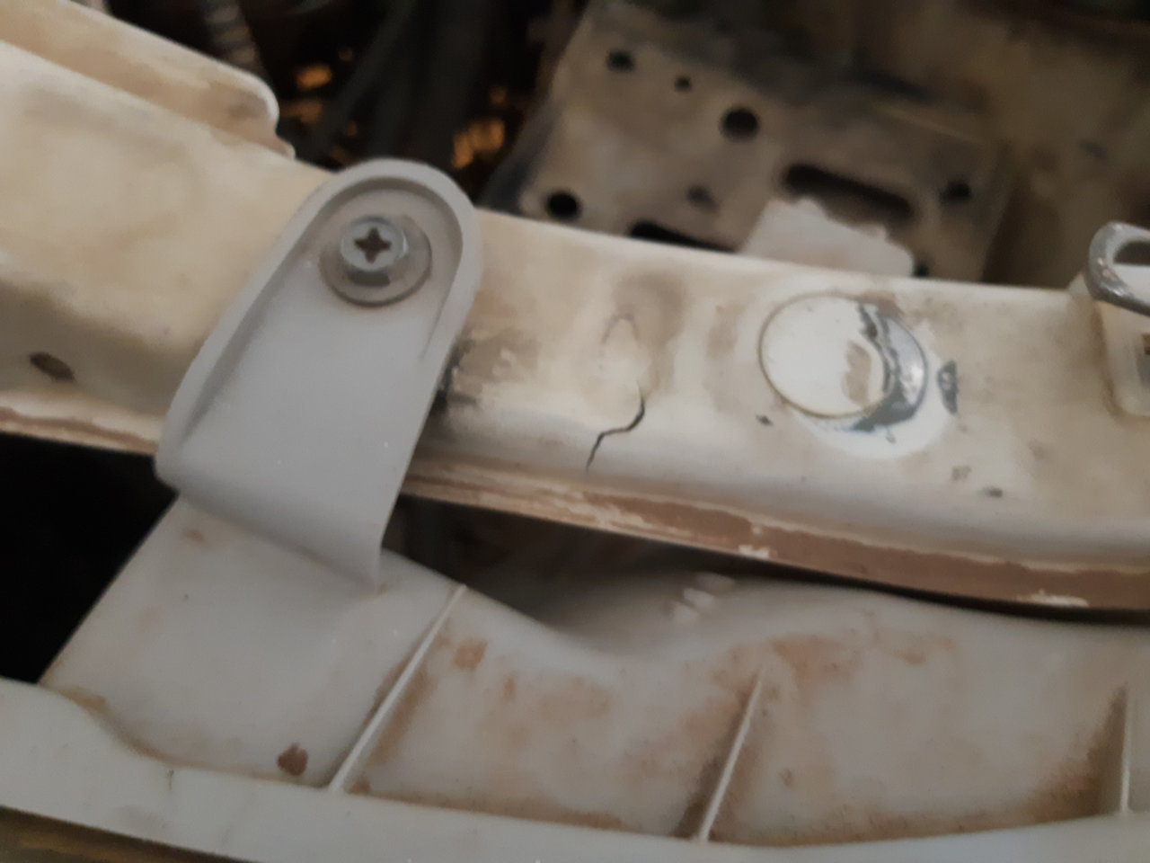

    And here are my first cracks I have noticed in the top of the core support.
    Wonder if this is why my hood hasn't been latching correctly?

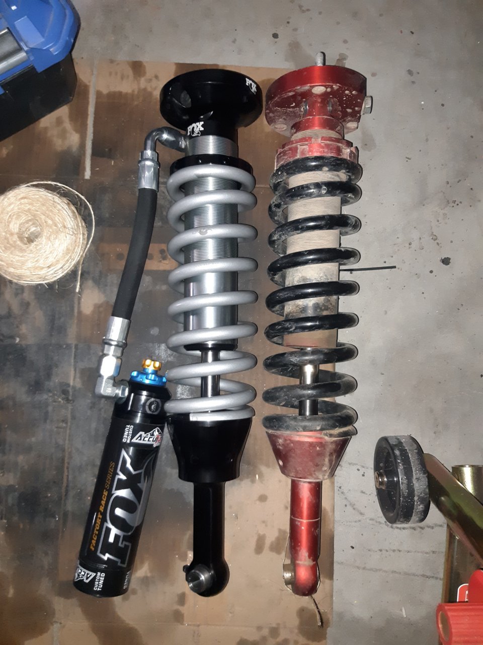

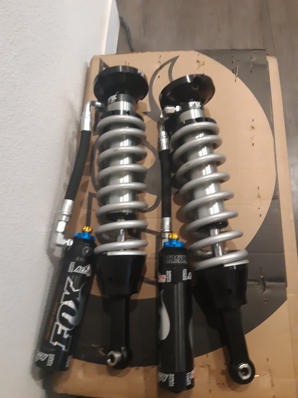

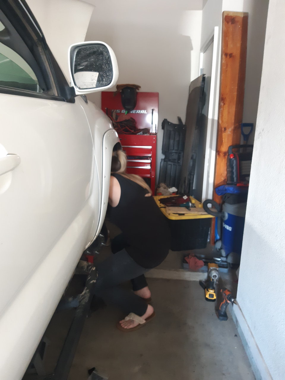

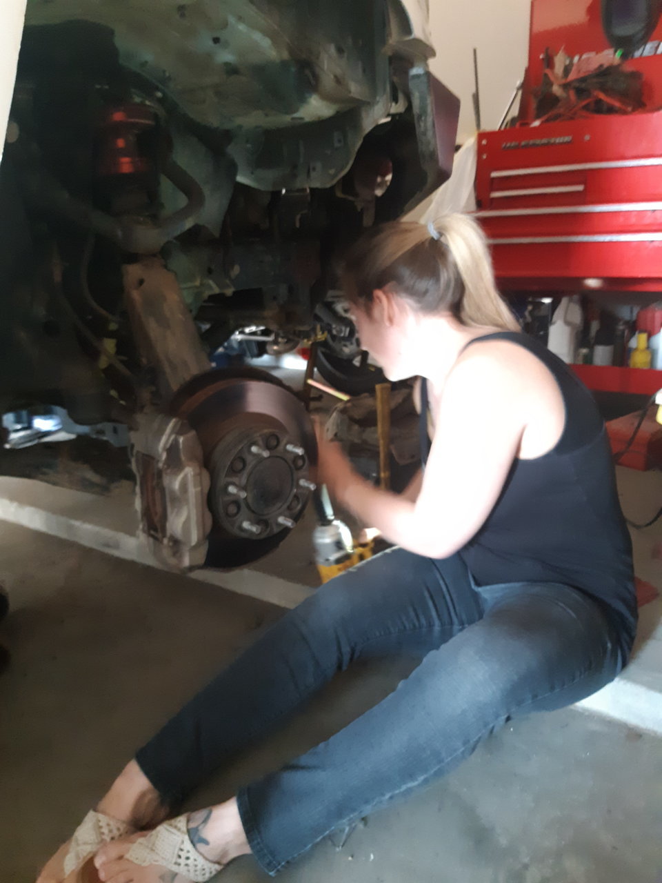

    Front suspension:
    Got the front coilovers swapped out. Went from the 700lb 14" springs on the toytecs to 600lb 13" springs on the foxes. The 700s were way to stiff for my front end weight. I only got a short trip on the dirt to test them out on the washboards, but I am very happy with the initial results. The reservoirs took some work to position just right, and it definitely helped to have a second set of hands. I did the driver side, but my lovely assistant took the lead on the passenger. I think she's a keeper! Pretty cool having her take an interest in my hobbies and want to help out. I even managed to laugh instead of getting upset when she stripped the threads on the reservoir bracket bolt by running my impact on full blast 5 minutes after I told her to be careful and turn the power down before using it to put the parts back on. :annoyed::rofl:
    She felt terrible about it as we drove from lowes to home depot and back looking for the appropriate thread tap and bolt. I kept telling her it was just the frame and no big deal. It took longer to run around and get the tool and new bolt than it did to drill and tap the new hole.

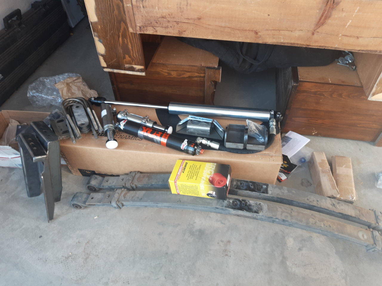

    Rear suspension:
    As for the rear end, it's all finally coming together after 2 years. I dropped my truck and some parts off at Warfab this weekend. The archive relocate has been here since April 2019, the shocks since July 2020, and final the decision to go with the 63s and all that circus just happened this year. After doing my measurements and looking at everything, I just don't see any reason to pair up 14s with my alcans.
