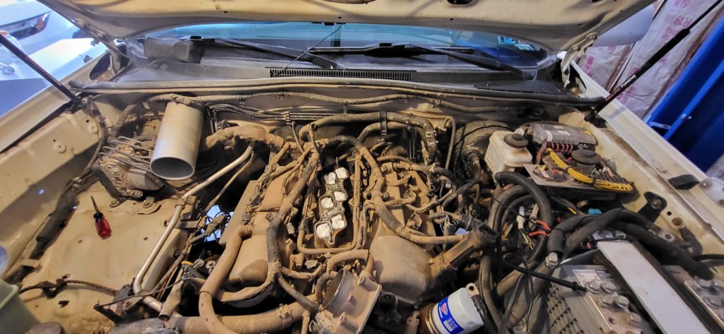

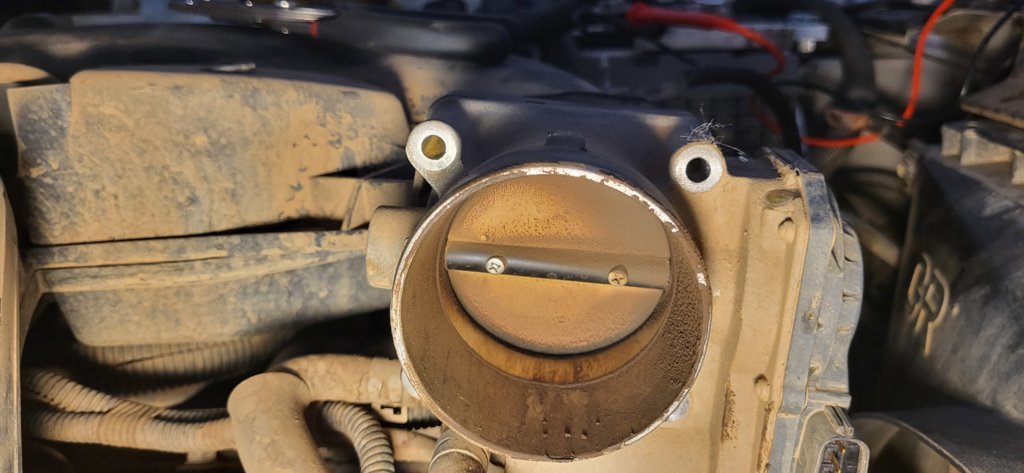

    Honestly, I'm impressed that this thing runs as well as it has.
    Good chance there's no red cone for me this year.
    Edit: This is coming out of the throttle body. Sludge.

    what filter have you been using??

    is this just an excuse to look at doing a V8 swap or some other engine? :burnrubber:
    i been wanting to run red-cone as well but time has been a factor.

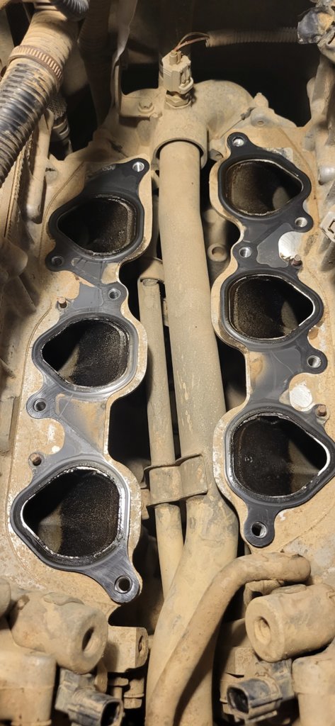

    I don't really have any interest in an engine swap unless for some reason this thing has to come out, but I am thinking I can mop this up. Got a borescope coming weds so I can peak inside the cylinders and at the knock sensor harness before I go deeper. I have been pretty religious with my peppermint spray and so far no evidence of rodents, so I don't think my knock sensor code is wiring related. I think it's because this thing is sucking in filth. I also found all three coils on the passenger side were loose, and likely have been since I had to pull the plugs 4 years ago after taking water over the hood and drinking from the Platte river. That's also probably where a lot of the dirt came from...my air filter was soaked so I ran without it back to woodland park that day.
    Also...Moab. Theres a lot of Moab there.
    I would guess there's only a few more weeks till red cone is closed again and I think I should take my time with some cleaning and maintenance and not rush this.
