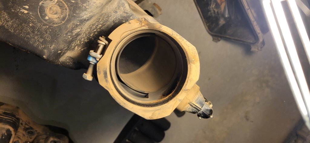

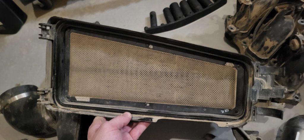

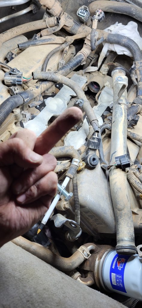

    There's a puralator in there now. I think it was a wik I picked up after the Platte river incident. It's way dustier than it should be on the post-filter side.
    Edit: this is coming into the throttle body:

    Jeeze ya that filter isn't doing filter things. Been feeding your engine some spicy air

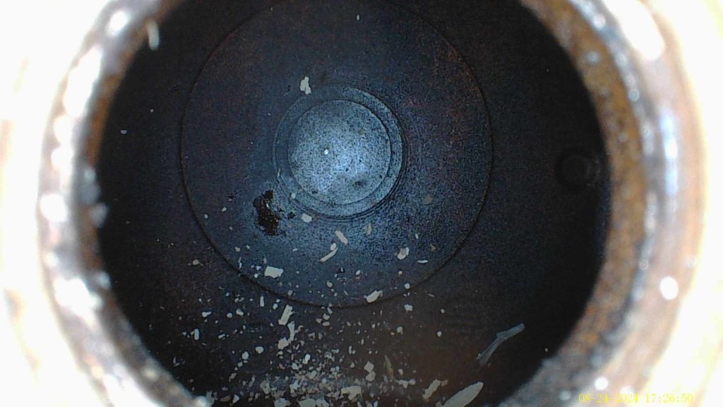

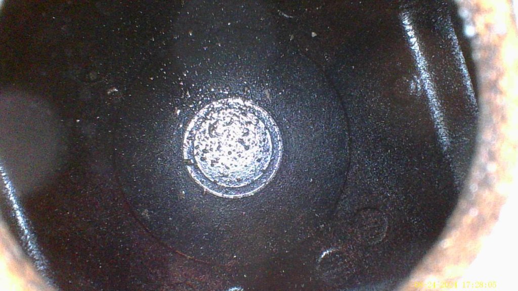

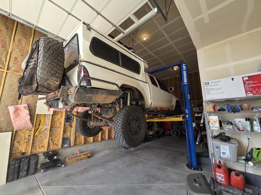

    Things never go as planned, so it wasn't so much that...just that the fact that these knock sensors are buried in there, and the level of effort required to even look at them is a lot.
    I also dont see anything wrong with the harness. It's possible I have a failing sensor, but given all the other issues I've found with the dirty intake and loose coils, and how interment the code is, I think I have some other culprits.
