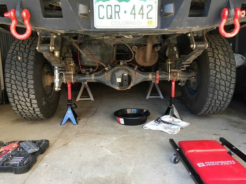

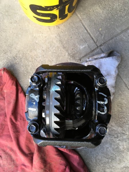

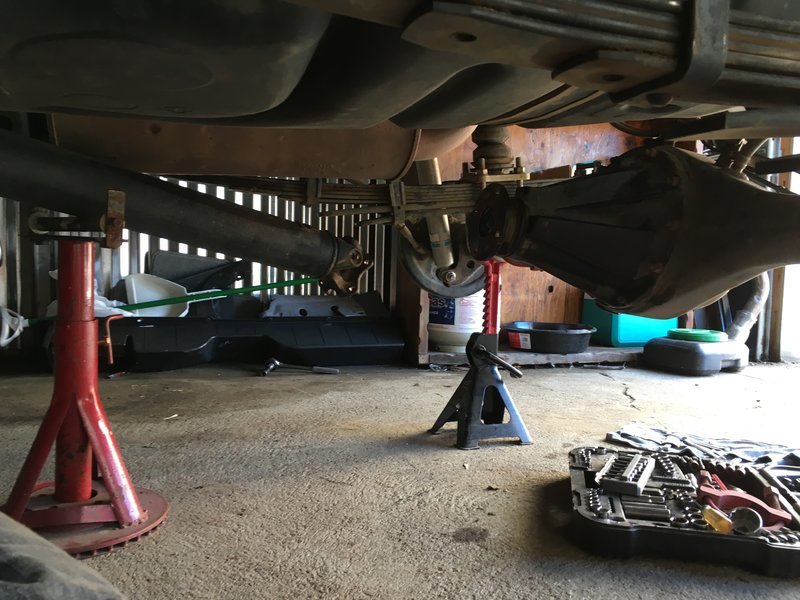

    Taking a quick break from today's wrenching...
    I've been looking forward to this since before Moab!
    Thanks to @TinkyWinky for the group discount on the ARB lockers, @thefatkid for assembling the them and setting up 4.56 gears, and also @3378jakesr5 for loaning me the cores for the swap.
  12. Aug 21, 2016 at 3:13 PM
    #72
    thefatkid
    thefatkid Well-Known Member
    Apr 5, 2013
    #101370
    4,358
    Brian
    Colorado
    2004 thingy

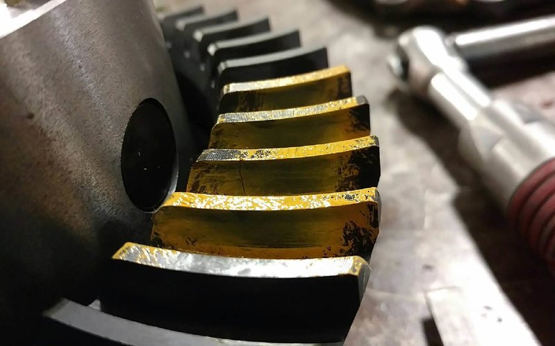

    Don't forget to check that copper tube before final install.

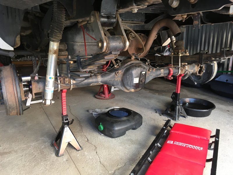

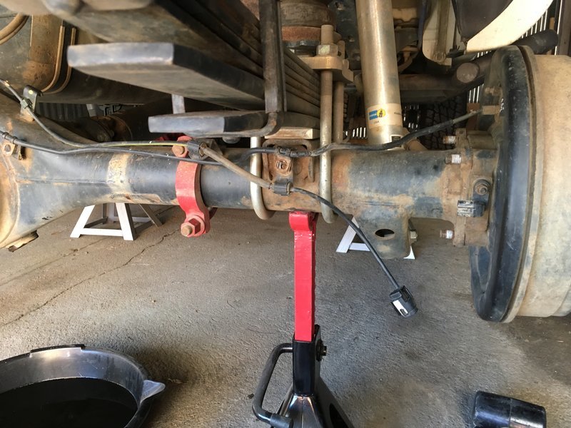

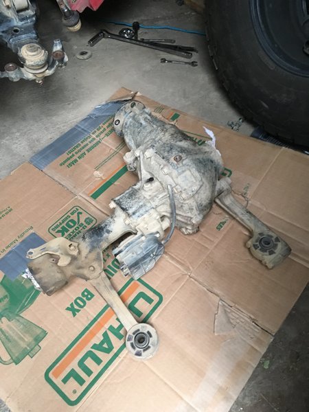

  14. Aug 21, 2016 at 9:49 PM
    #74
    Littles
    Littles [OP] Stupid is as stupid does.
    May 14, 2014
    #129837
    3,398
    Bryan
    Elizabeth, CO
    3 tons of fun

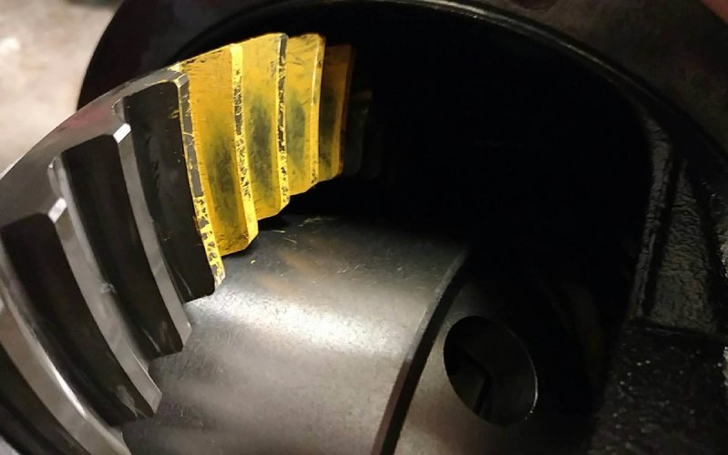

    The front is built, but I only swapped the rear today. No gear oil in it yet as I'm waiting the recommended number of hours for seals to dry. I'm pretty sure I sealed the shit out if it.
    I can confirm that when I apply pressure to the air line and rotate the tire forward on one side, both wheels rotate forward, which for me was petty f-ing exciting. #winning
    There is still much to do...but I'm one step closer :thumbsup:
  15. Aug 21, 2016 at 10:01 PM
    #75
    Littles
    May 14, 2014
    #129837
    3,398
    Bryan
    Elizabeth, CO
    3 tons of fun
    It looked pretty damn good where you had it. I have no concerns about metal to metal contact. I just can't wait to drive it.

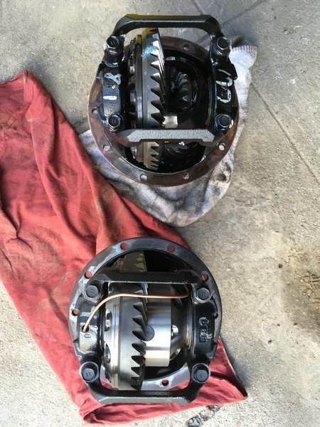

  16. Aug 23, 2016 at 4:34 PM
    #76
    Littles
    May 14, 2014
    #129837
    3,398
    Bryan
    Elizabeth, CO
    3 tons of fun

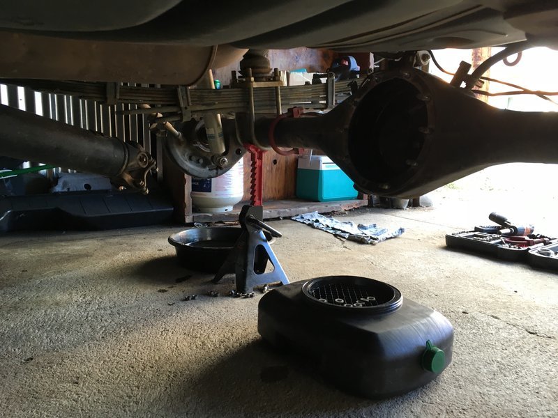

    Victory at last!
    Now i just haven't to get the new one in...

  18. Aug 23, 2016 at 4:39 PM
    #78
    3378jakesr5
    3378jakesr5 AOF, trucks, guns, repeat....
    Oct 25, 2014
    #141018
    13,860
    jake
    littleton colorado
    2006 DCLB silver taco. Soild axle swapped, Bumpers, armor, expo..... Money pit. Yata yata yata
    Better to ask what I have not done.
    Hey that looks like my diff! Arnt those things a pain in the ass to remove!
    hoverlover and ChadsPride like this.
  19. Aug 23, 2016 at 5:16 PM
    #79
    Littles
    May 14, 2014
    #129837
    3,398
    Bryan
    Elizabeth, CO
    3 tons of fun
    It certainly wasn't a pleasant experience at all. Just a lotta shit you have to remove to get to it. Took me awhile figure out the angle after I accepted that the bracket for the vacuum line and breather absolutely must come off. After that it was just bench pressing the back end up high enough to clear the stud for the rear Allen bolt. I should have the new one in tonight...might leave the rest for tomorrow.
  20. Aug 23, 2016 at 6:13 PM
    #80
    HomerTaco
    Mar 28, 2010
    #34129
    45,874
    HomerTaco
    HomerTaco
    HomerTaco
    Mad props little buddy. I never pulled the front myself, just the rear.
