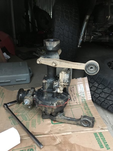

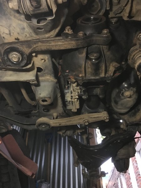

    This was getting the monumental first bolt into the diff. I don't have any after that of the front. I can take some final one tomorrow

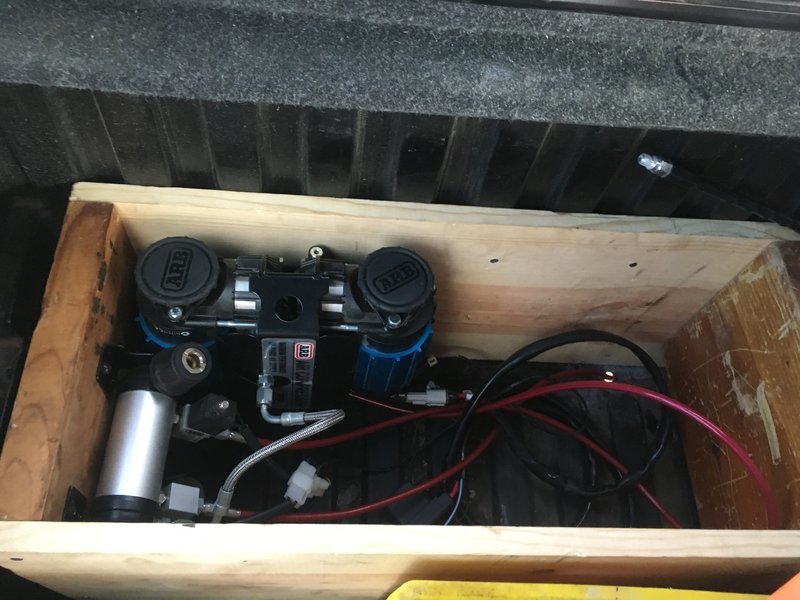

    Well, that was easy. 10 bolts, a couple clips, and a few whacks with a hammer. I love when things go smoothly.
    On a more positive note, I'm almost at the 200 mile mark breaking in my gears, and I got the airlines installed for the lockers. Now that I drilled two new holes in the cab, I'm still making the final decision on relocating the air compressor to the bed with an accessible disconnect for tires, or leaving it in the cab, but for now the back seats and trim have been reinstalled with the compressor in its original location.

    If I had a 2nd gen Taco, I would take the big cubby in the bed, cut it out, make a bracket to mount the compressor back there with the door as an access. I have a Tundra and can't do cool stuff like that though.

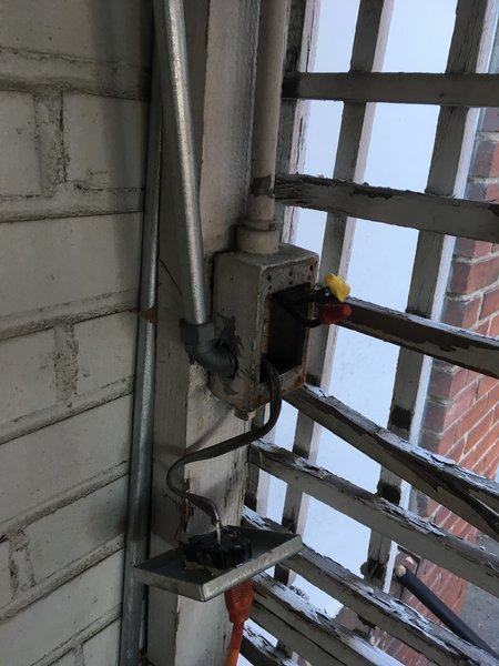

    So this is my current option for electrical power at the garage I rent...
    :eek:
