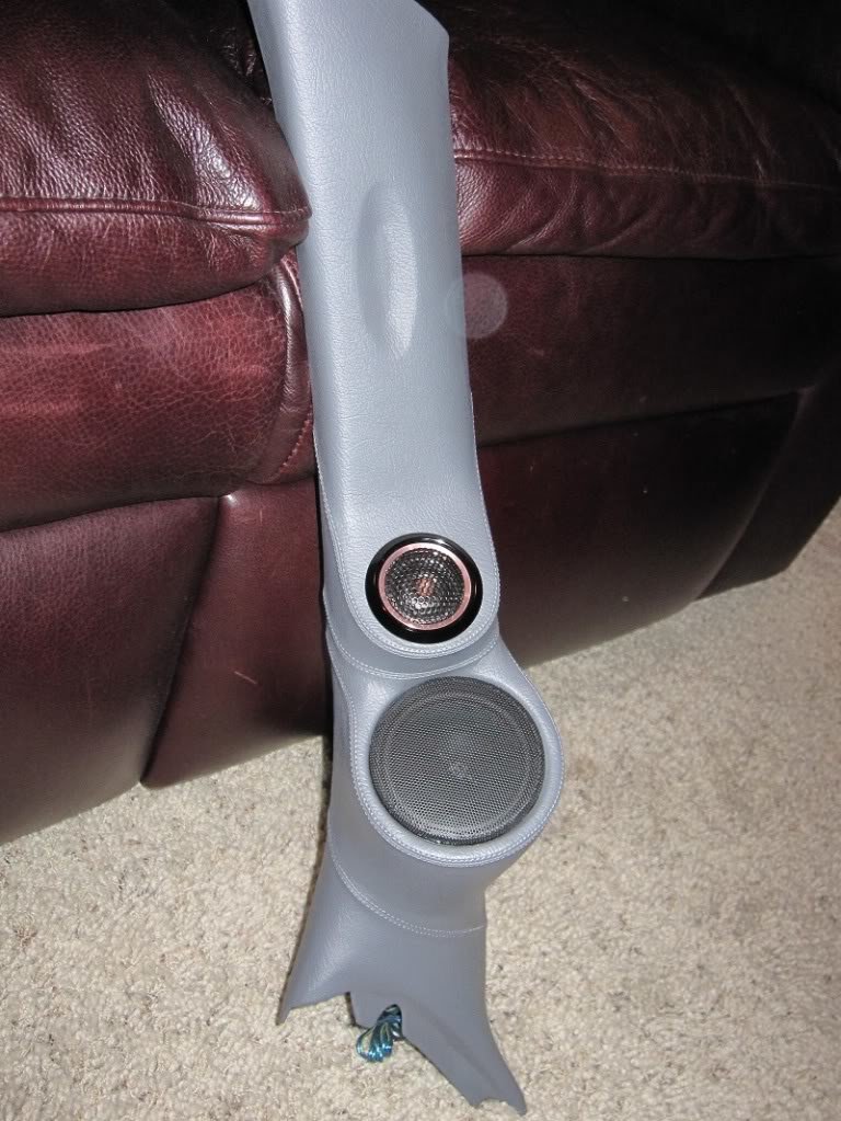

    I'm going for it. Here's what I got so far. We'll see how it turns out...

    Looks good man... Hybrid Audio seems to be the new fad. I'd love to see pictures of the a-pilars installed when you finish. Are you going with the L8's in the doors?

    I have L6s in the doors now and I'm pretty happy with them. I might consider L8s down the line if I can fit them and this 3-way setup works out.
    The L8s might be a bit deep though. I've seen Dynaudio 8s in these doors before. They're shallower. Another option for more midbass would be the Image Dynamics x69.
    It never ends... First off, I'm going to need another couple channels of amplification with this new setup since it's all active. For now, the speakers in the rears doors will have to get disconnected, which is probably best while trying to tune the front stage anyways.
