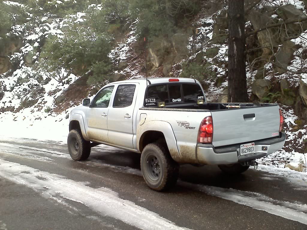

    before spindles

    ya i always thought it looked good, but one of my tires does have a nail in it.

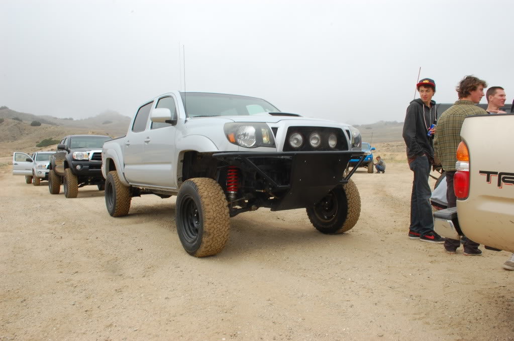

    my 3" lift with 265/70/17. i would go with 33s next time around, but it bought this size before the lift. it doesn't look bad at all, but i'm sure 285s would look meaner.

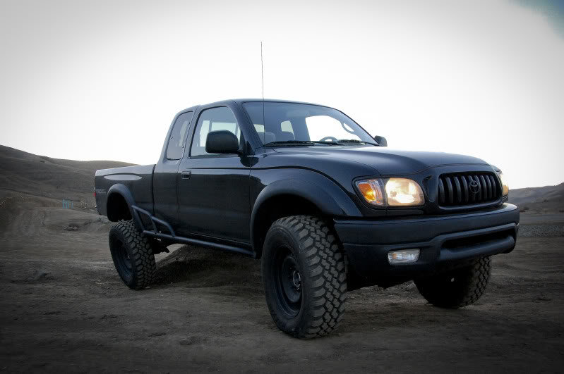

    i have a 3" fabtech with 265 70's and it doesnt look bad at all man i was running 285's (33's) and they loooked better and didnt half to trim at all.

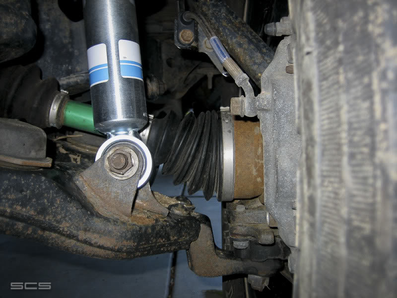

    this is how it looks with my eibachs and bilstein set at 0. the inner boot started leaking slightly after a few days. i wiped it down clean and added a hose clamp to tighten it down and it hasn't leak since. between the oem boot clamp and my hose clamp, i added a foam cushion so my hose clamp wouldn't cut in the the rubber boot over time.
    btw, this pic was taken before i added the extra clamp.

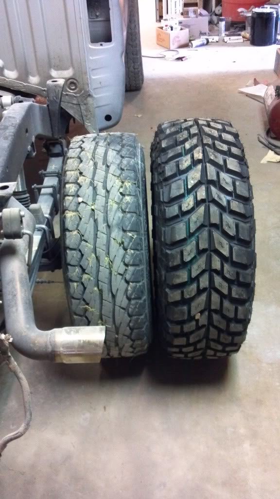

    Rear view for a quick comparison for you in size and height.. 265 75 17 mounted and a 285 75 16 on the outside.
