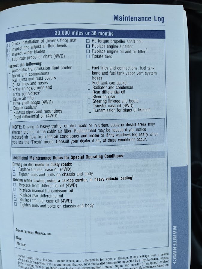

    maybe someone in the 11 pages of responses already said this but as per Toyota, you don't need to do all that. Dealers make up all kinds of extra work for service intervals. This is from "Toyota of Danvers" wherever that is.
    This next picture is for a 2018.

    Sounds to me like they were trying to be cute and just tell you the parts price. Absolutely hate it when service writers do that crap
